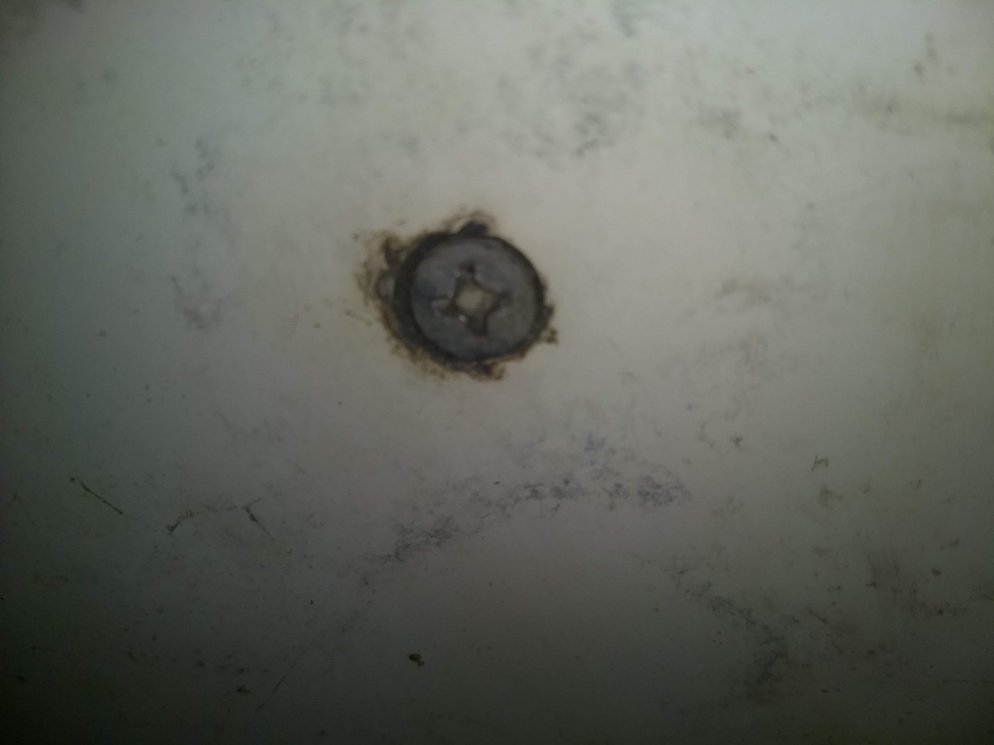

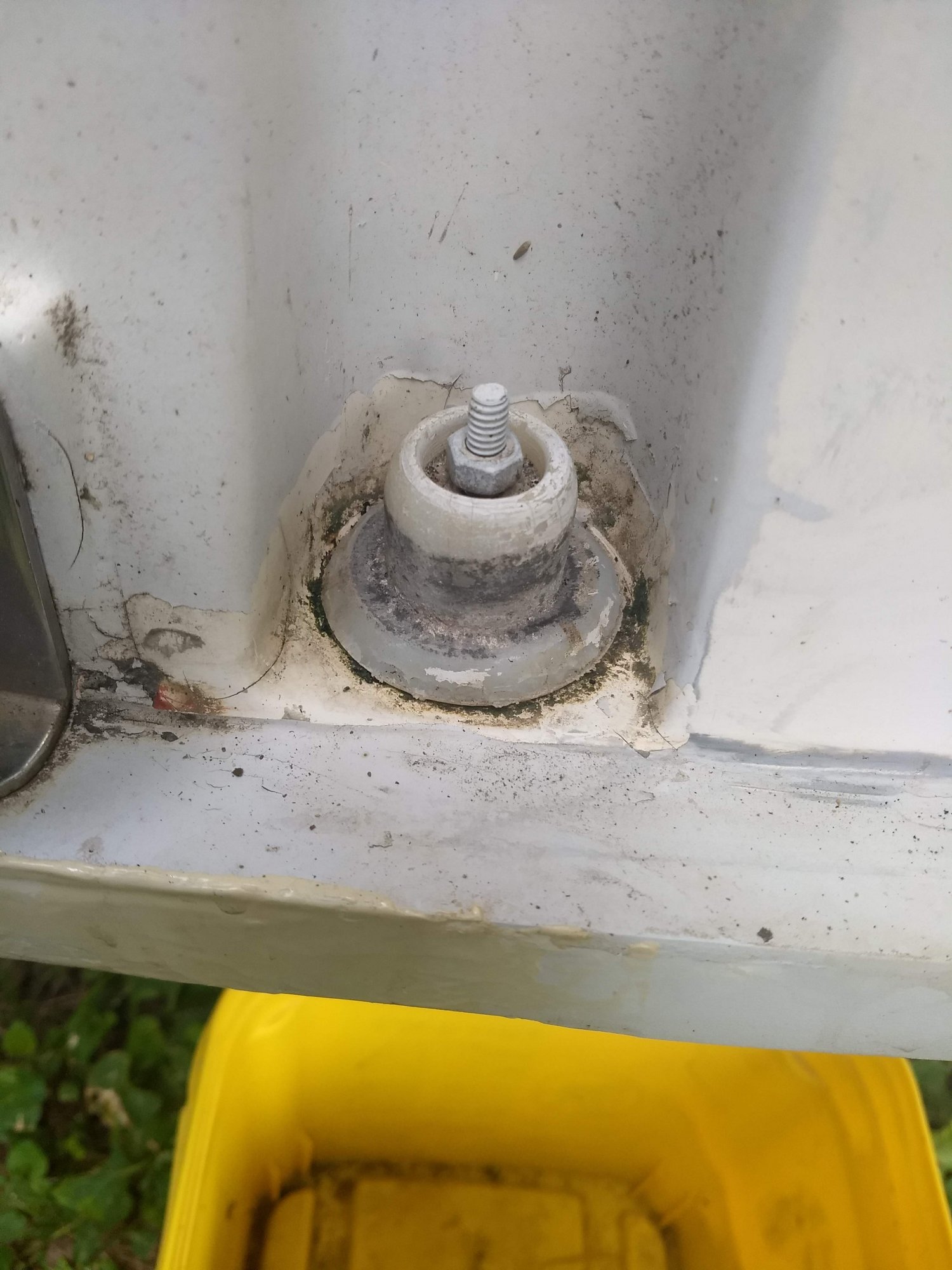

I to had a leak of about 5 gallions after a day of sailing. So I followed everyones (good) suggestions from this older thread. Still had the leak. Surprised no one mentioned this. (Pics).
Cleaned it up, Sealer around top and bottom, tightened it up. And I no longer have water in the boat..... yay
