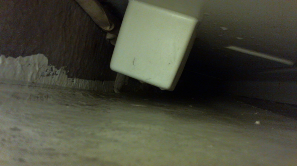

Sorry for the slow updates. Had to wait for the endoscope to arrive and then it took me a while to get a chance to try it. As it turns out, the endoscope was not the very useful. I guess these things are meant to be used in tight spaces so the focus distance is around 4 inches. There's not enough control over the position of the camera to make that useful. I switched to taping a web cam to the end of a steel fish tape :
This yielded some interesting pictures like this one:
Unfortunately, the only place to insert a camera is through the ballast tank valve which is right next to the centerboard trunk so I can only inspect a portion of the starboard side of the tank. There was no visible damage anywhere that I could reach. Sigh..

BTW: The boxy looking structure in the middle of the picture is the pocket for the end of the dinette table stand. That really threw me.

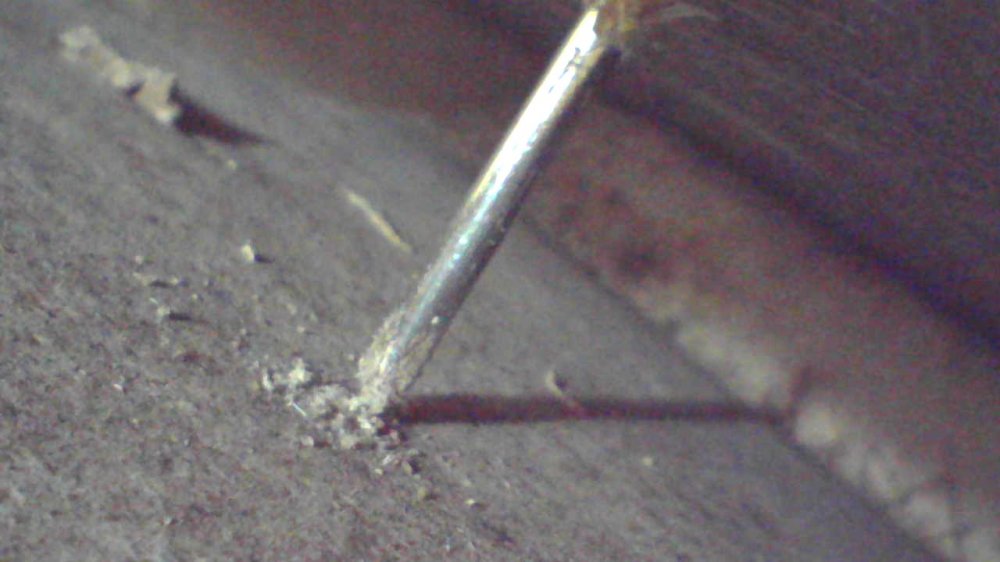

Managed to get some pictures directly beneath the port-a-potty today. I put the thinnest screwdriver I could find through the old screw hole in the sole so that I'd have a guide. I see no evidence of damage to the ballast tank at this point. Also, this experiment gave me a better idea of how much clearance there actually is down there. It's almost two inches. The screws I pulled out where no where near this long. So I guess this rules out damage from the port-a-potty screws.
