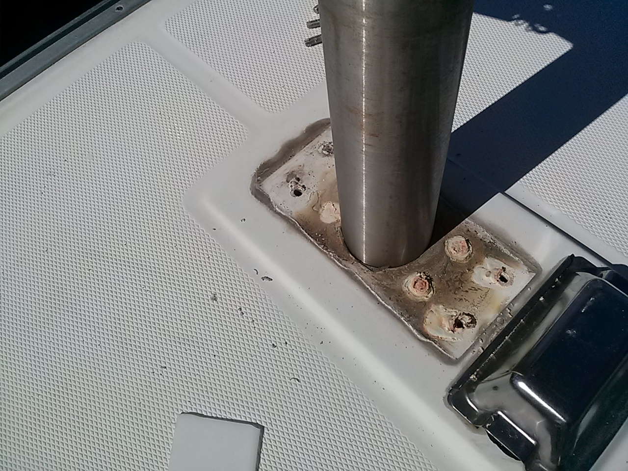

Bought a 2003 Hunter 356 in Massachusetts with an advanced leak at the stainless mast compression post. The mast came down for transport so it was a simple repair. The compression post is an ingenious advance since it transfers the load directly to the keel so the deck is not really part; therefore, no crushed leaking core/etc. The reason it is leaking is that Hunter used 3M5200 and did not prep the stainless and fiberglass parts by sanding and then cleaning before applying the 5200. So it doesn't stick and then the leak. Removing the step expecting a lot of trouble I was amazed when it just popped off. I called around to most of the caulking manufacturers and the only one that was willing to say if you do it the way we say we will stand behind our product was Sika Flex. It's a 4 part process of sanding the stainless and the glass with strong sandpaper to get the gloss off both, clean with acetone. Then application of an activator Sika Aktivator 900-980 followed by application of a primer Sika 206 G&P Primer and finally the caulking itself Sika 295UV. About $80 for the products plus a couple of small brushes. A year so far and no leaks. Once the mast is off it is not a big job. The Hunter website has a lot of great information. The 356 is extremely well documented as to construction with many files covering all aspects. Also had to rebuild the condiment tray on the 356. Here are some
pictures. For the files go to http://www.marlow-hunter.com/wp-content/themes/marlowhunter-custom-theme/export/Owners-Manuals/ then find your model and bingo. CAM01020.jpg CAM01025.jpg CAM01068.jpg CAM01019.jpg
