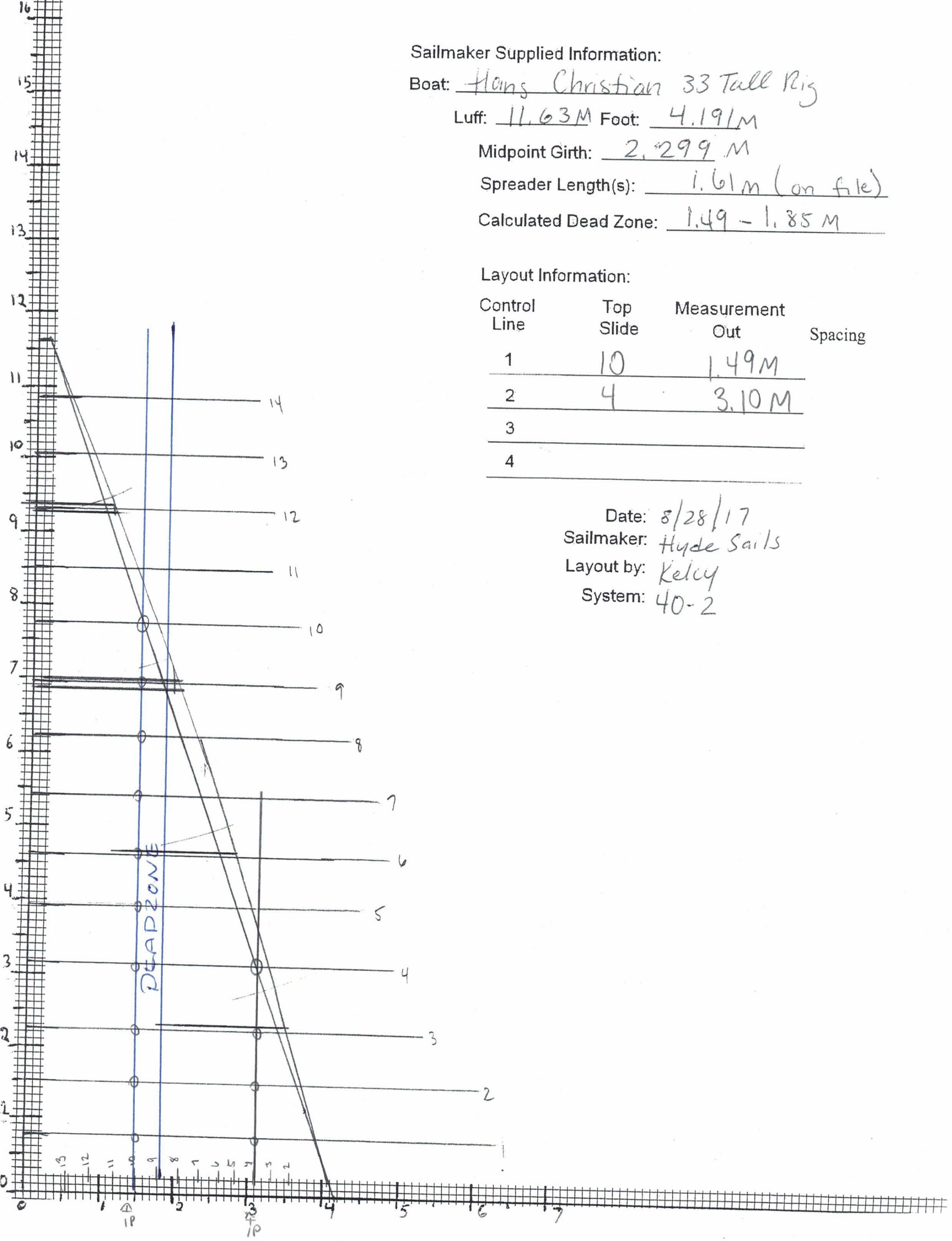

Everything! Consider that the Dutchman folds down like a Venetian blind. Grommets are installed in the sail, and heavy duty (300 to 500 pound test) nylon fishing line runs from your topping lift to special pockets at the foot of the sail. Simple, right? The most common problem I've seen (especially on Catalina) is having too far a space between lines. Three feet is ideal, four is doable... but I've seen five feet. That doesn't work. I even saw a sail with grommets install so that the mailsail flaked on opposite sides of the boom (grommets in column should be all odd or all even in number).
Again, Dutchman doesn't charge for this service. When I designed sail layouts, I usually had them back to the sailmaker withing hours. Why they all don't take advantage of this free service is baffling to me.
Many of you might be wondering why we design each sail instead of having a design for, say, a Catalina 42 on file. Well Dutchman does, but roach and batten placement varies from sail to sail, so I designed each and every one.

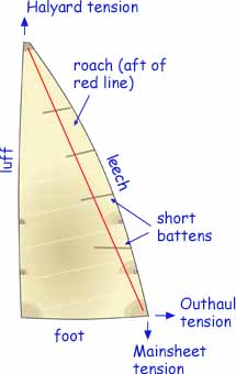

can someone explain what a "roachy" main is?
Any part of a triangular sail that extends over the imaginary straight leech-line of the sail is 'roach'. It is key to understand this, as while roach gives you extra sail area, it also is unsupported by leech tension and needs battens for support.
It also explains:
Why furling mains, which can't have traditional battens, often have none and then often have negative roach to stop flutter.
Why genoas, which have hollow (or negative roach) don't have battens.
Why jibs (which CAN have roach) often have battens.
Max mainsail roach under rating rules adds about 15% to the P*E/2 area. The more you have, the more 'roachy' it is. Hollow with furling mains subtracts 5-10%. So a 20-30% swing using a furling main. Yea.

@Jackdaw: Dutchman doesn't design any mainsails per se. The saildesigner designs the mainsail and sends me the files. I send Dutchman a subset of the 2D details of the mainsail and the rig: luff, leach and girths, batten locations up from the tack, and spreader width. Dutchman determines where to install of the luff slides, control line grommets and bottom pockets. Dutchman send me back a drawing showing me exactly where to install the grommets. I send it to the production loft and they build the sail to specifications. Dutchman does a great job of laying out their system so it works.

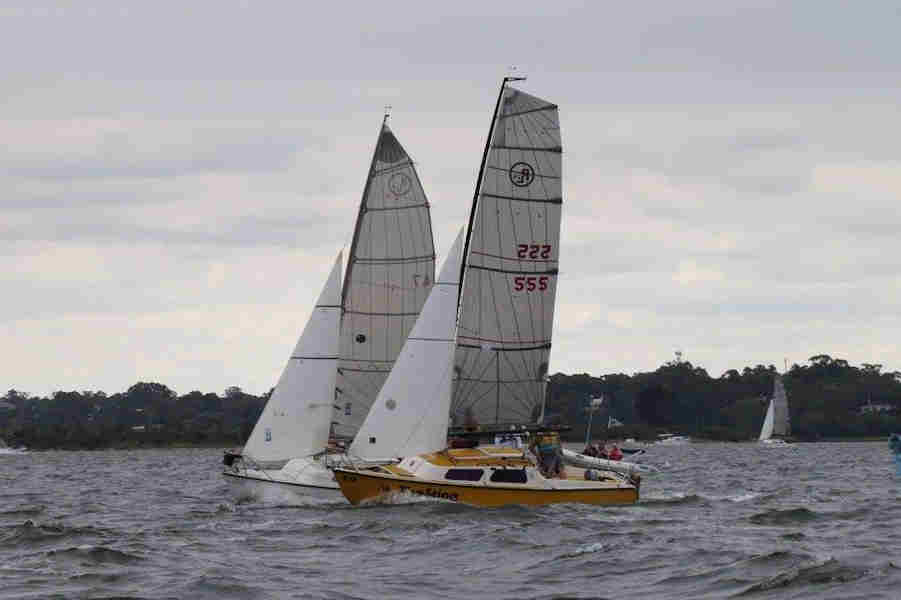

Ps. On our current boat, a 24 foot trailerable trimaran, we have a 240 square foot, square-top mainsail with 7 full battens, one of which is diagonal. We have a Tides marine system and an adjustable, halyard style topping lift. No Lazyjacks. I find it quite manageable for double handing even on very windy San Francisco Bay. It's down and under control (secured loosely to the boom not neatly flaked) in less than thirty seconds.
