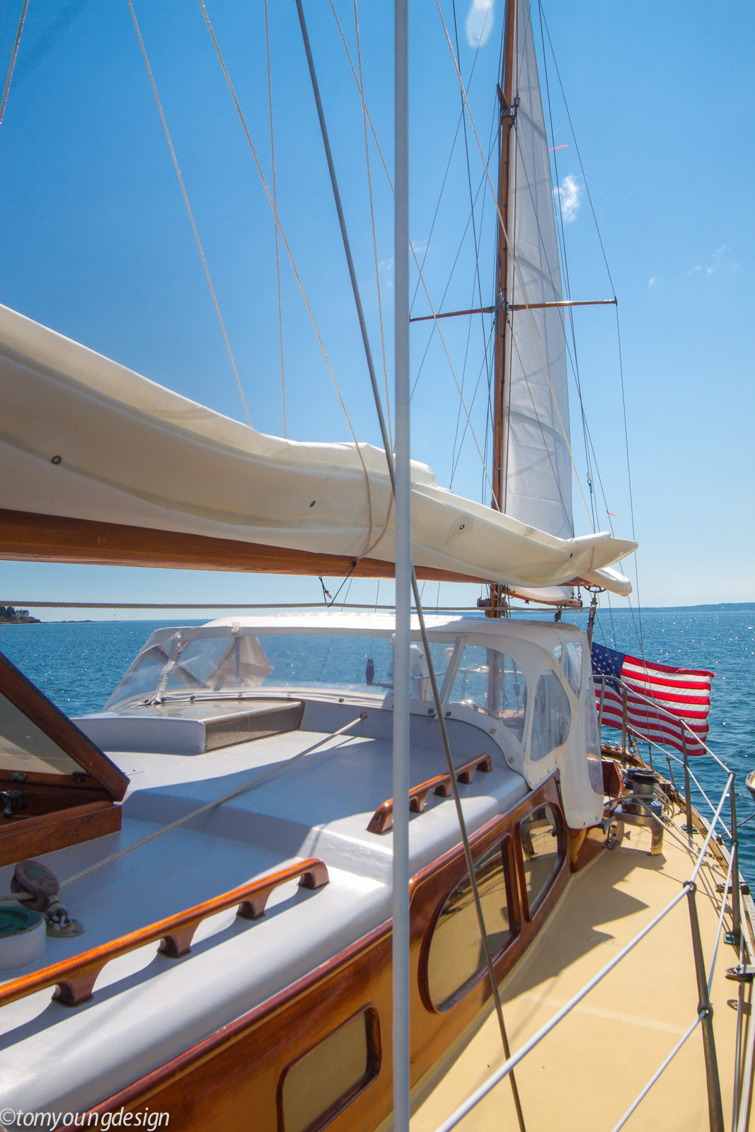

Mine, with 4 legs, are pretty simple and easy to put together. 1/4" nylon line and simple hardware.
I made them retractable so I don't deal with raising my full battened main, between lazy jacks. I lower and gather the legs of the jacks, and run them under their hoist-cleats, once the sail is tied to cover.
The main on my boat is difficult to furl, especially single handed. Lazy jacks aren't perfect but they can help tame your mainsail. Be sure to mock them up so you can move locations around until you get it right, before drilling holes.

i notice this guy has lazy jacks. i see his helmsman has natural life jacket too.
