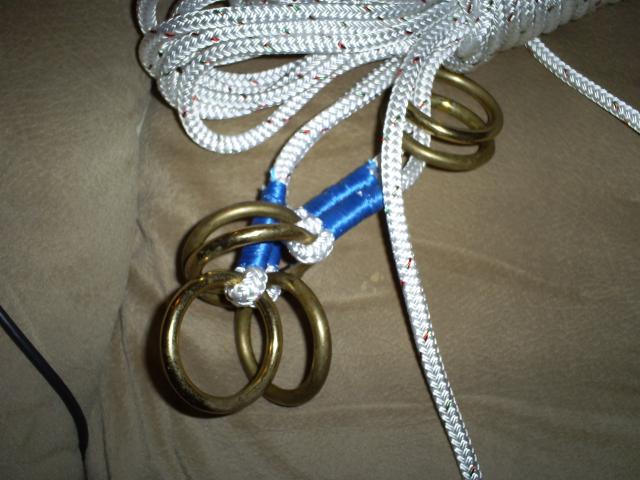

I made the lower legs of this type of lazy jack. They are called Skip' Lazy Jacks. and they are retractable. http://members.tripod.com/~C22_Fleet_6/lazyjack.html
I lock-stitched and whipped the ends to the bronze rings instead of splicing. I layed my sail down flat and used a 2x4 to simulate the boom. Then messed with the dimensions until I was happy.

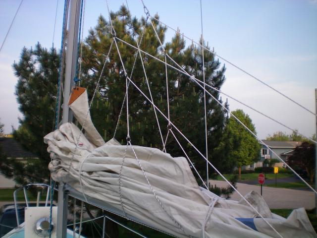

I too made the Lazy Jacks from Skip's site. I found the spreader attachment didn't work on my boat(spreaders pivot at the mast). I liked the idea of having them wider at the top, but settled with cheekblocks just below the spreaders(hope the battens clear). Work well. I attached cheekblocks at the front of both sides of the boom and run lines aft to jam cleats(just in front of mainsheet bail). I can either pull them to stow the jacks tightly against the boom, or release and haul the"brown line" to deploy. My brown line is continous forward of the mast with a turning block attached to a single deploy line coming down the forward side of the mast. I haven't determined what to do with that line yet....lead aft or cleat at base of mast. The forward stow lines help contain the sail forward as an added benefit. I used 3/16 stay set and eye spliced all the ends(got REALLY good by the 6th or 7th splice!). Used caribiners from the "brown lines" to the jacks so I can remove my boom easier. I will post pics as soon as I return home.

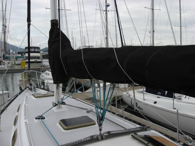

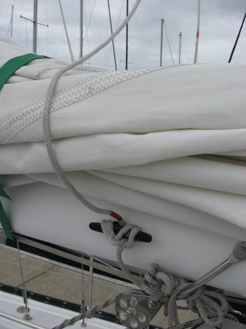

Here's a couple of pic's:
- One shows lazy jacks with the cover on. Been doing it this way for almost three years. No chafing yet either on the lines or the cover. If the forum's photo kilo byte reduction conversion doesn't degrade the quality too much, maybe you can see the red tape wrapped around the forward-most port line. After the cover is off, I pull in the line so that the red marker lines up with the tie-off cleat on the boom. Is ensures that I duplicate every time the right amount of slack for raising the sail and then it doesn't need to be adjusted when sailing.
- The other shows the cleat on forward part of the boom. Its a small one. 3.5 - 4". This is the forward-most of the three attachment points on the boom and it the adjustment location. Note how the line is threaded through the center opening of the cleat. A stop knot at the bitter end will prevent the line from coming free totally. The red tape (in a different spot than the red tape above) this time is the other marker which corresponds to the right amount of slack so that the lazy jacks drape underneath the installed sail cover. No guessing. Saves a lot of time.

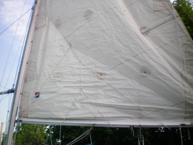

Hermit: Another consideration before you permanently install your system is where on the boom each lazy jack line is attached. When buying a pre-made system, the manufacturer will have guidelines in the instructions (which you can probably download without purchasing). However you might want to experiment. For example, I found that my aft-most attachment point was too far aft. In that location it was great for catching all the sail on the boom as it came down, but also the battens always got caught when raising. So I moved the aft-most point forward by a couple of feet which helped a lot. The leach end of the sail now flops a bit off the boom when dropping, but its no proplem gathering it up with the sail tie. Giving thought on how you might experiment without drilling holes in the boom, maybe tightly wrap some light cord around the boom several times between the boom sail slugs and attach the lazy jack points to that. The tight wraps and the slugs should prevent the temporary attachment point from migrating forward and aft and would work just fine for a day-sail.
As others have mentioned, I have not seen any need for beefy cleating systems or winches. There should be no significant tension on the lazy jacks more than just a light pull with the hand/fingers.
