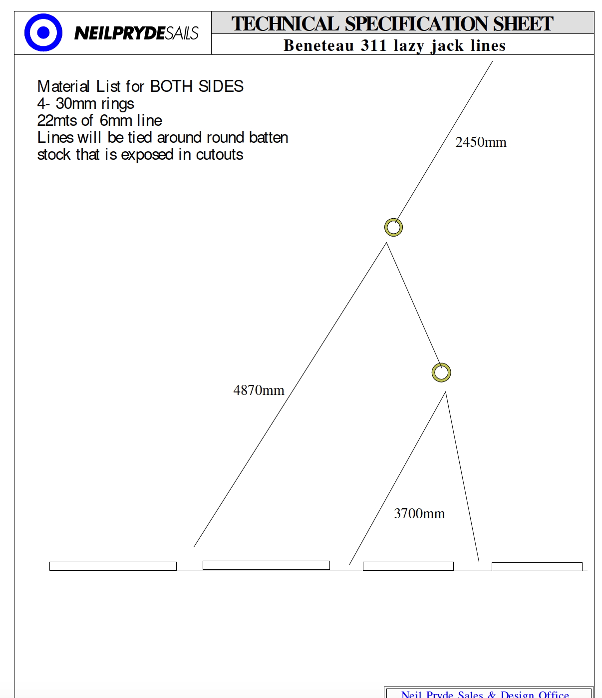

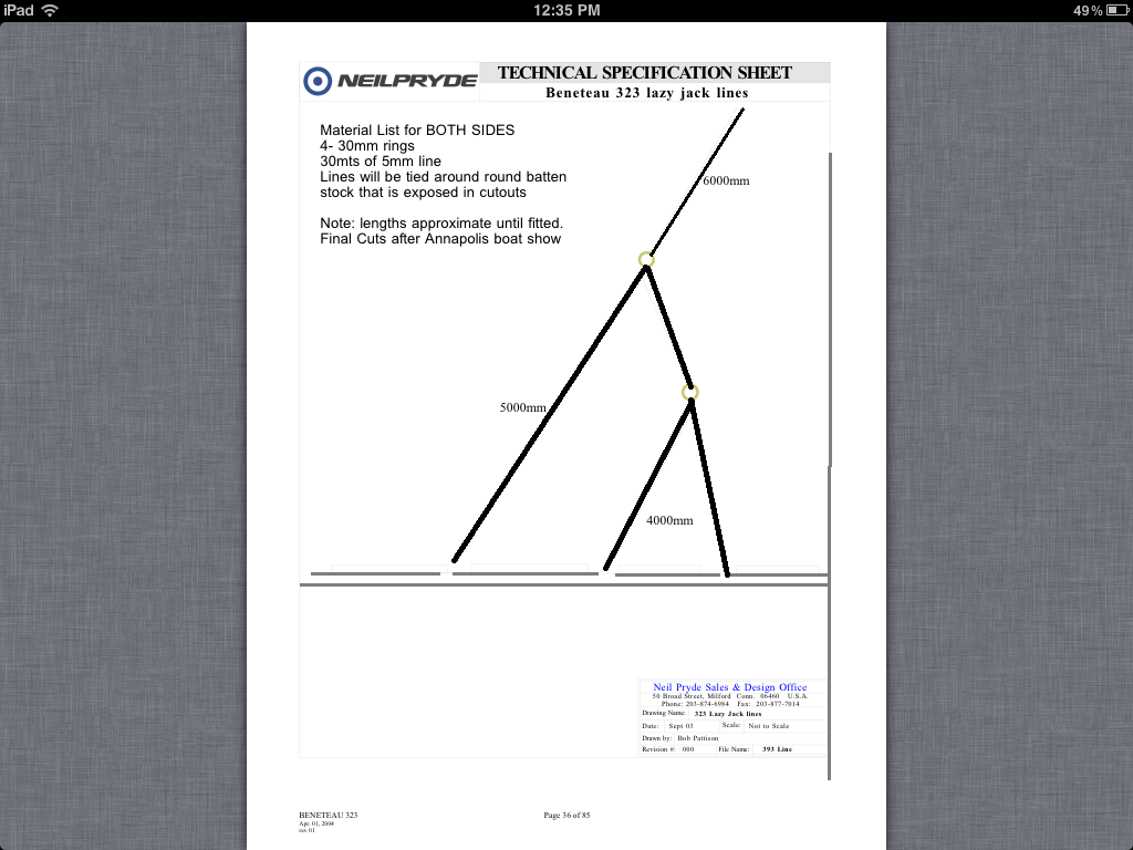

I will take those photos. Attached is an diagram by Neil Pryde Sails out of the B 311 Owners manual, describing the set up. Oddly enough on my boat, each of the lower lazy jack lines have been seized together a few inches below the rings that they pass through, so the line is not free to slide thru the ring. There is no adjustment such as a cleat built in as installed or in the diagram.

Thanks Gunni and Stu, this has been helpful, I did a websearch for Neil Pryde Sails jacklines and came up with this more detailed "Lazy Bag" system description: http://www.neilprydesails.com/images/pdf/lazy_bag.pdf It describes placing several wraps of riggers tape at points along the round batten to give the jackline knots some grip which will help keep them tied in place and also recommends knots to use and on page 5 a "shortening loop" knot arrangement that will allow some adjustment at the forward most jackline attachment point. This systems as described makes much more sense to me. I will study and implement it.
I might consider some additional adjustment such as Stu suggested, after I get the original system installed and I can see how it works.
Yes it does look like someone made some uneducated modifications in the past that have messed up the original system.

I just looked at your lazy jack diagram, and it is certainly different from the setup on my boat.
Your diagram shows the long line aft and the short triangle forward. My rig is set up with the short triangle aft and the longer triangle forward. This helps to better contain the forward portion of the sail as it is dropped into the bag.

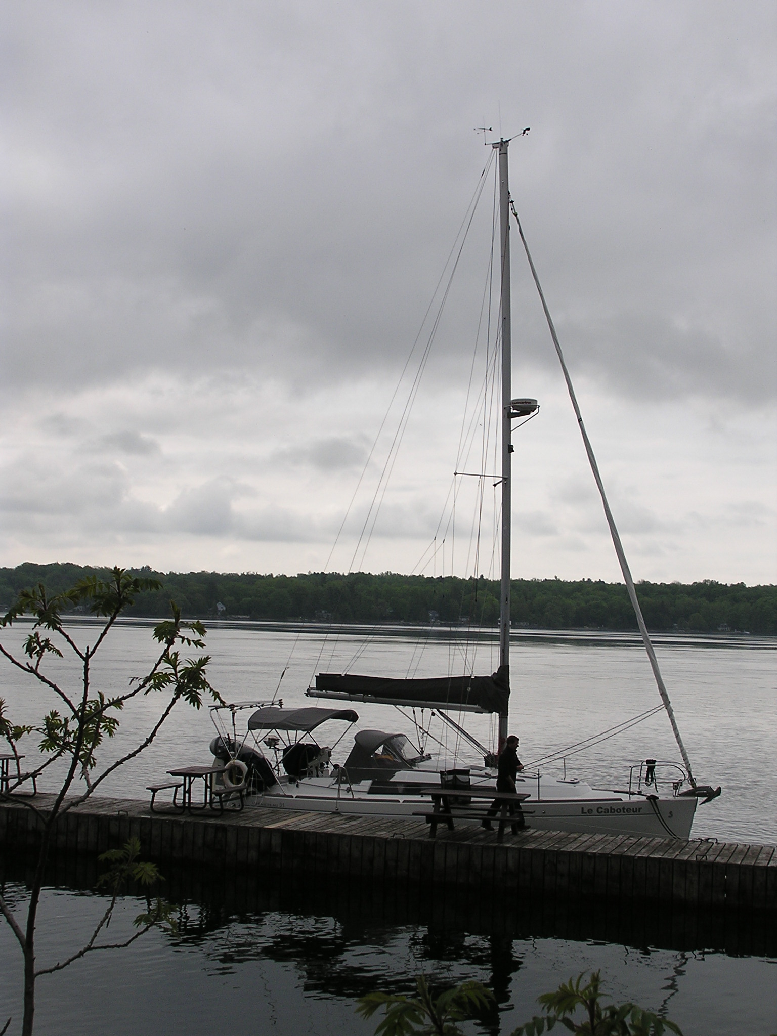

I found this photo of a B 323 on the web which shows the lazy jacks way out of adjustment. I can see how this set up would result in a lot of the sail dropping off of the end of the boom into the cockpit. I get a little of that but its not a big problem.

CaptnRon:
I kept running into the battens catching in the lazy jack lines if the sail was flogging while hoisting. Solved that issue by trimming the battens slightly so that they were completely inside the leech.
It definitly sounds like a modification. That diagram is not mine, it was produced by the creator of the Lazy Bag system, showing how he thought it should be set up. That is also how Neil Pryde shows it in more detail in the Lazy Bag Installation.pdf file I attached earlier. The photo I attached to the post preceding this one shows it set up this way on a B 323, although it is way out of adjustment. I'd love to see a photo of your setup sometime if you can share one.

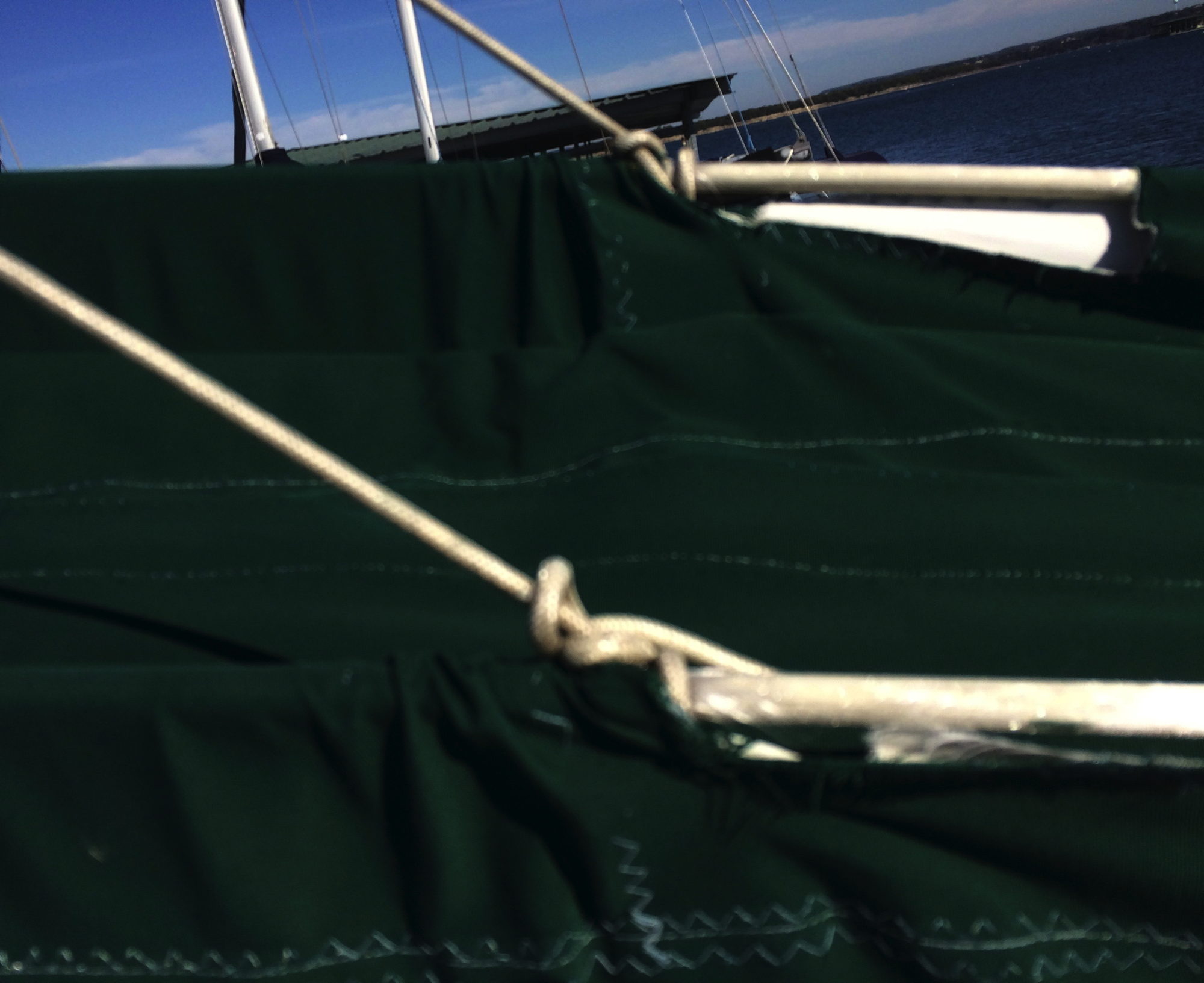

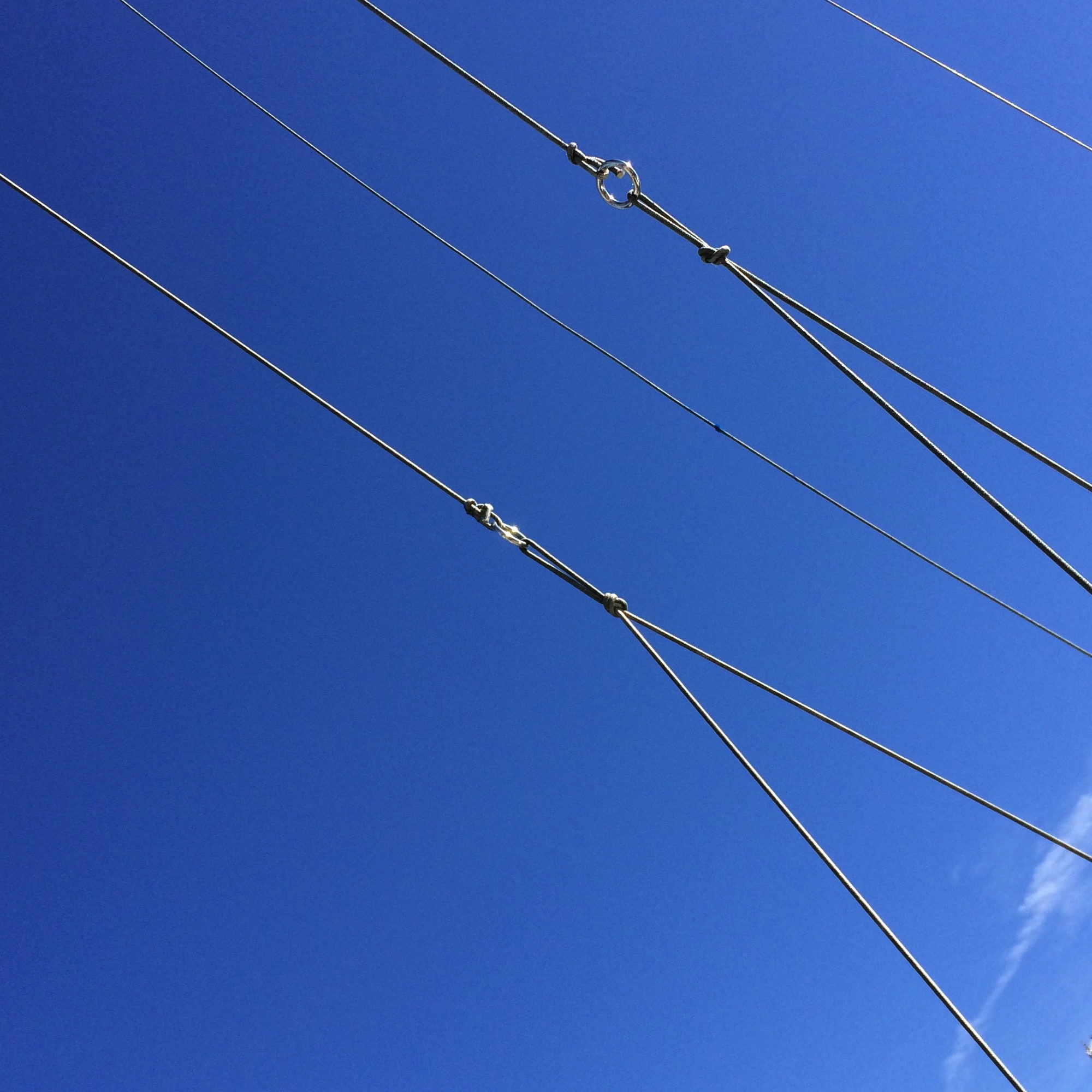

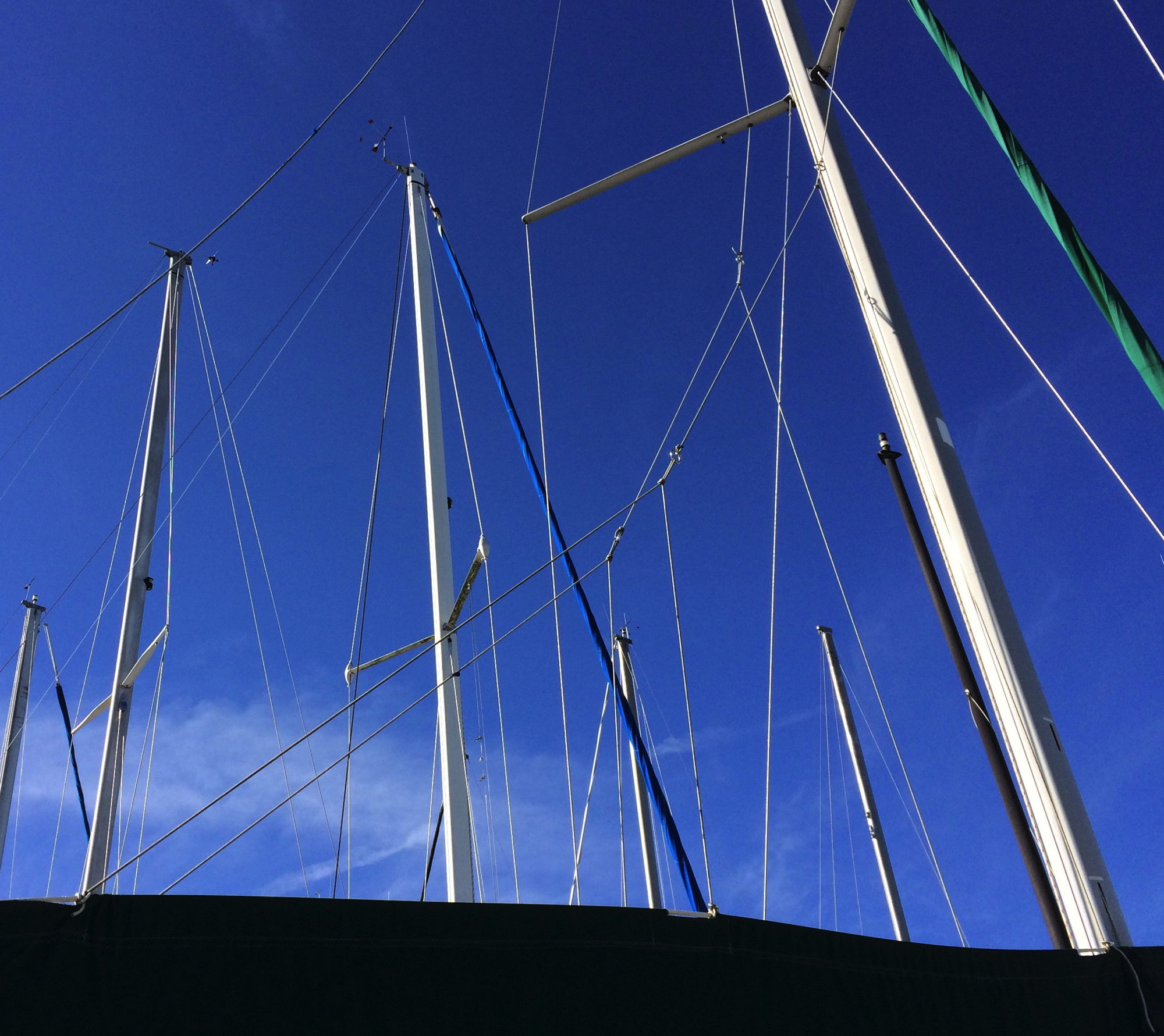

Here are the photographs of the current configuration. It is so obviously wrong, I can't imagine what the previous owner was thinking. The close up that shows where the lazy jack goes through the metal ring shows how it has been tied off into a loop, which totally removes any ability to adjust these lines without having to individually retie every line. In the close up where the lazy jack is tied to the batten, you can see how its slipping has torn the batten pocket.

CaptnRon; this is the lazy jack line layout taken from my Bene323 manual. black lines sketched in because they were vague in the copied image. Mast is obviously to the right in the diagram. The lines slide freely through the rings, they aren't supposed to be knotted as they are shown in some of the previous photos.

CaptnRn,
From your photos we can see that are the rings are not doing their job because the lines are knotted, your set-up is inverted: the short /\ section should be forward and the lines should not be led through the guides in the spreaders, they should go to the turning blocks 3 meters (10 feet) higher and come back down through the guides in the spreaders and then tied to the cleats either side of the mast. On the attached photo you can't see the lines come down through the holes but you can see that the pull on the lazy bag is much more vertical than on your boat.
