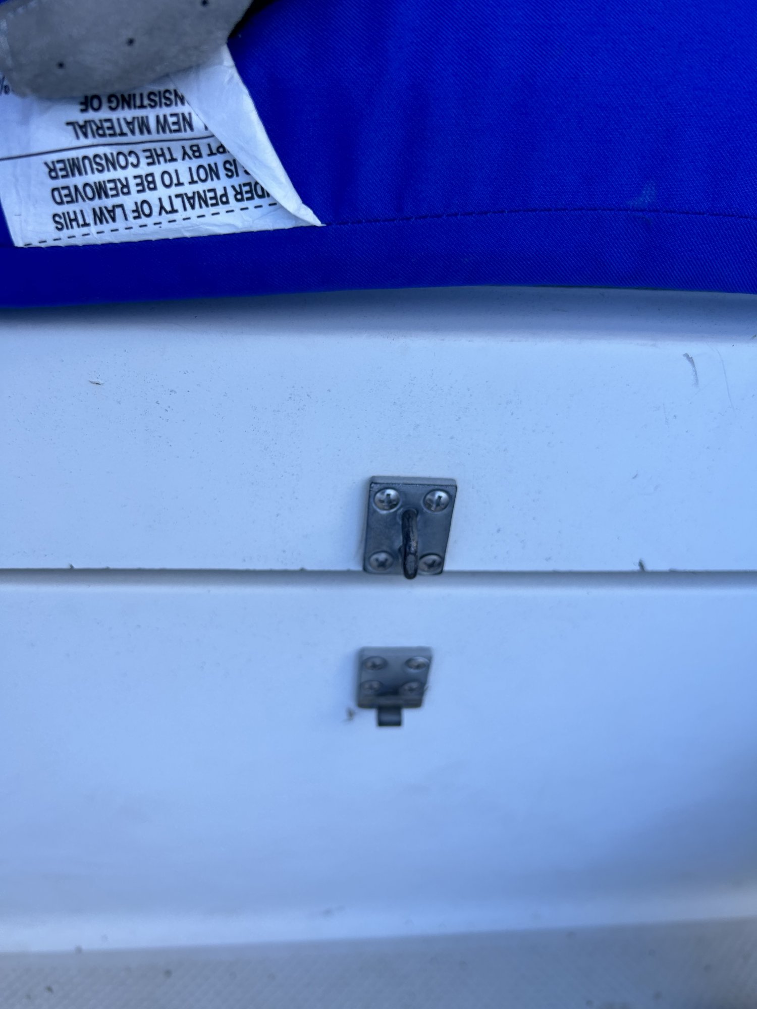

Any ideas for something other than these metal clasps to hold the lazarette lid down? They gouge my shins all day. I don’t need to lock them. I thought about removing them completely but I was told that’s a bad idea in the event I capsize. Thoughts…?

There are some boats that have access to the lazarette lid from the inside. In that case the tie down or lock the lazarette on the inside. Not as convenient but it keeps the seat closed yet still gives accessibility.

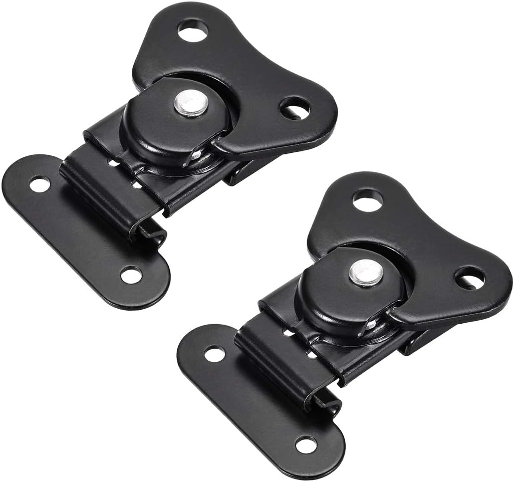

These might work. Not locking but fit flat
uxcell 1.61-inch Iron Butterfly Twist Latch Keeper Toggle Clamp for Case Box - 2 Pcs (Black)
Likes: JBP-PA

Getting real: Those "clamps" are there to lock the storage compartments from people with sticky fingers who wanna steal your boat cleaning supplies and extra ropes. Ward's idea is great. Or, just move the damn thing to a place where you won't rub against it.

I never thought of moving them !!!! Great idea. I will abstain from the capsizing debate as that is beyond my skill, experience and knowledge level. Thanks to everyone for the ideas
