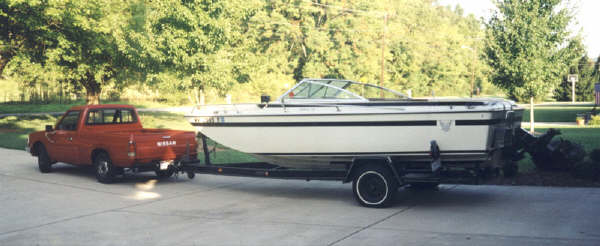

I launched a 1977 Thunderbird S18 with a 1986 Nissan 720 a few times back in the day. The 2WD 720 has a 2500ish pound curb weight. Specs for the Thunderbird put it at 2750 pounds and it was on a steel trailer which must have weighed a pound or two. I survived, as did the truck and boat, but I wouldn't strictly recommend such a setup.

RWD and a longer wheelbase. Also geared lower
If the Internet is to be believed, the Prius has a few more inches of wheelbase at 109.4 vs my truck's 101.4. (surprised me too) It also has 31 more ponies and is a lot heavier. Sill and all, if I'd had an F450 available somewhere back then, I would have used that.
