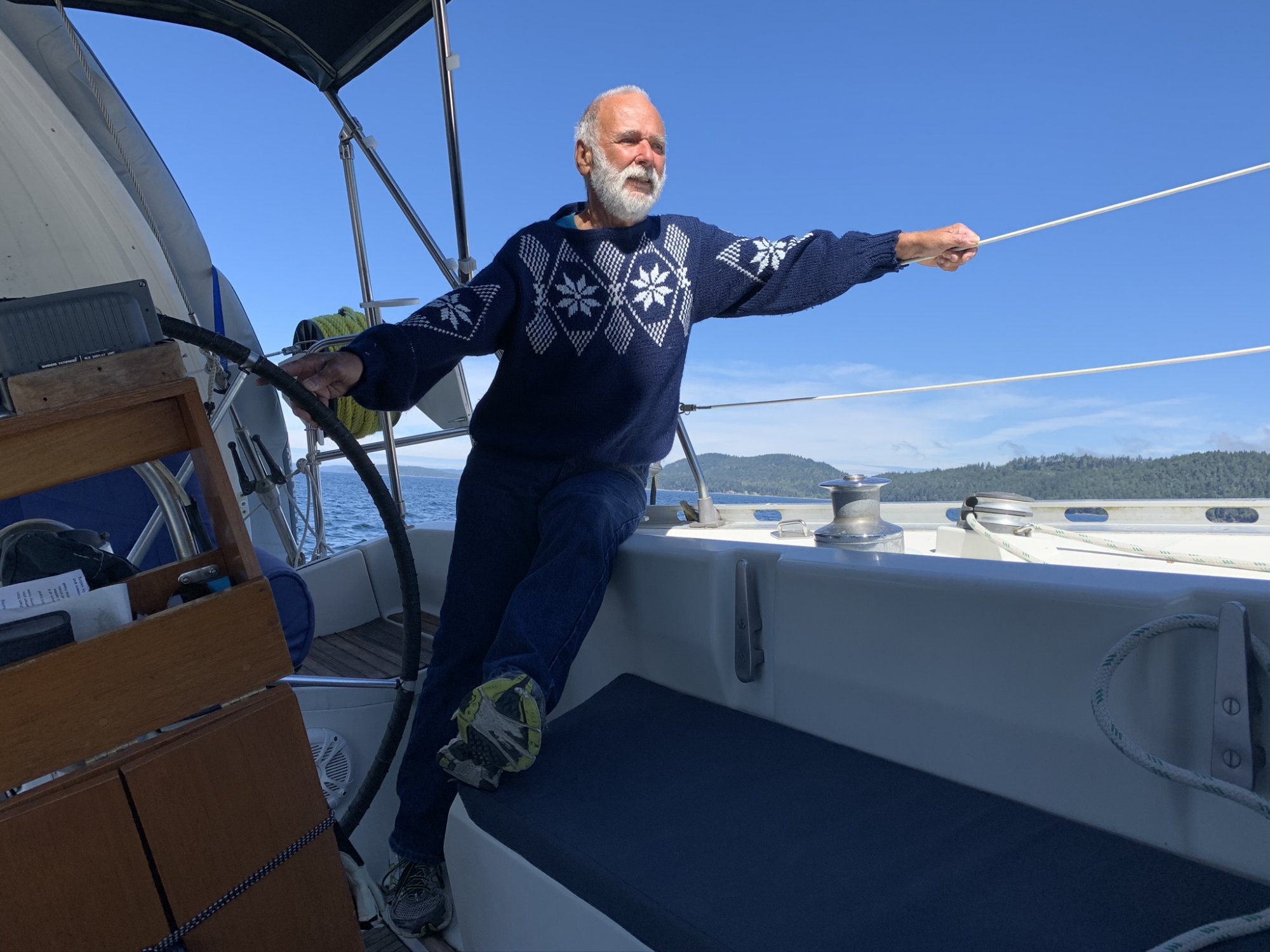

We have a 42inch wheel. It gives fingertip steering while sitting on the high side. I’ve looked at the folding wheel but they cost about 1/2 of a new main sail. The wheel is somewhat awkward to get around.
