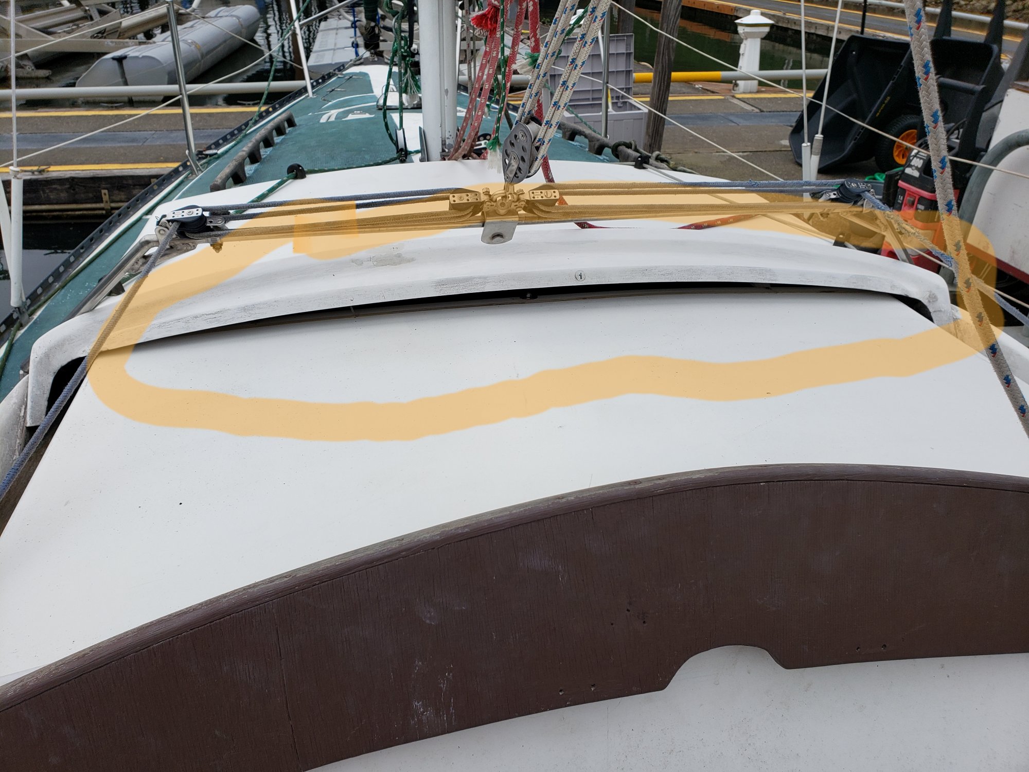

I recently acquired a 1979 Lancer 25 and have a repair to make and I am not sure how to proceed. The companionway cover slides under the cabin top to allow access to the cabin. However, on my boat there is a gap above the sliding cover and below the cabin top that would seem to allow rain to enter right into the boat. I think that a piece is missing, but I'm not sure what that piece would look like and/or be made of. Any photos or description that a fellow Lancer 25 (or similar model?) boat would be willing to share of that space would be greatly appreciated. Is there a wooden piece? Rubber Gasket of some sort?
The photo in this post highlights the location of the gap.
Thanks.

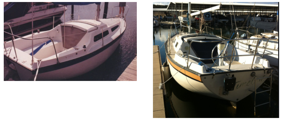

These photos of a Lancer 25 look like your companionway and have a gap also. If concerned about whether rain would enter there perform a watertight test with a hose then check inside. Good idea for every boat to check leak tightness of windows, companionway, etc.

Thanks for those additional photos. The one on the left looks a little more snug, but the one on the right looks very similar to mine. I'll spray that area next time I head to the boat to investigate. I imagined the water just pouring below. But I'll test it and clear away any debris along the sides and see if it all works out.
Thanks to both of you.

Regarding your cabin top and sliding companionway cover, when you inspected the boat did you see a lot of water in the boat?
All boat builders are a bit different sharing their own ideas as to how a boat should be built. when you look at the cabin top that is hidden under the front section of the cabin (that part that is sliding in) is there a raised bump? This bump is likely to have 2 purposes. One to stop you from grabbing the slide portion and yanking it out into the cockpit. And two deflecting any rain water from getting up under the cabin roof and spilling into the center of your cabin.
As the slider is a bit bowed it looks like Water would shed towards the sides and into a slider trough, then back towards the cockpit. Our boats are often designed to shed water rather than be water tight. Some boats are more so than others.

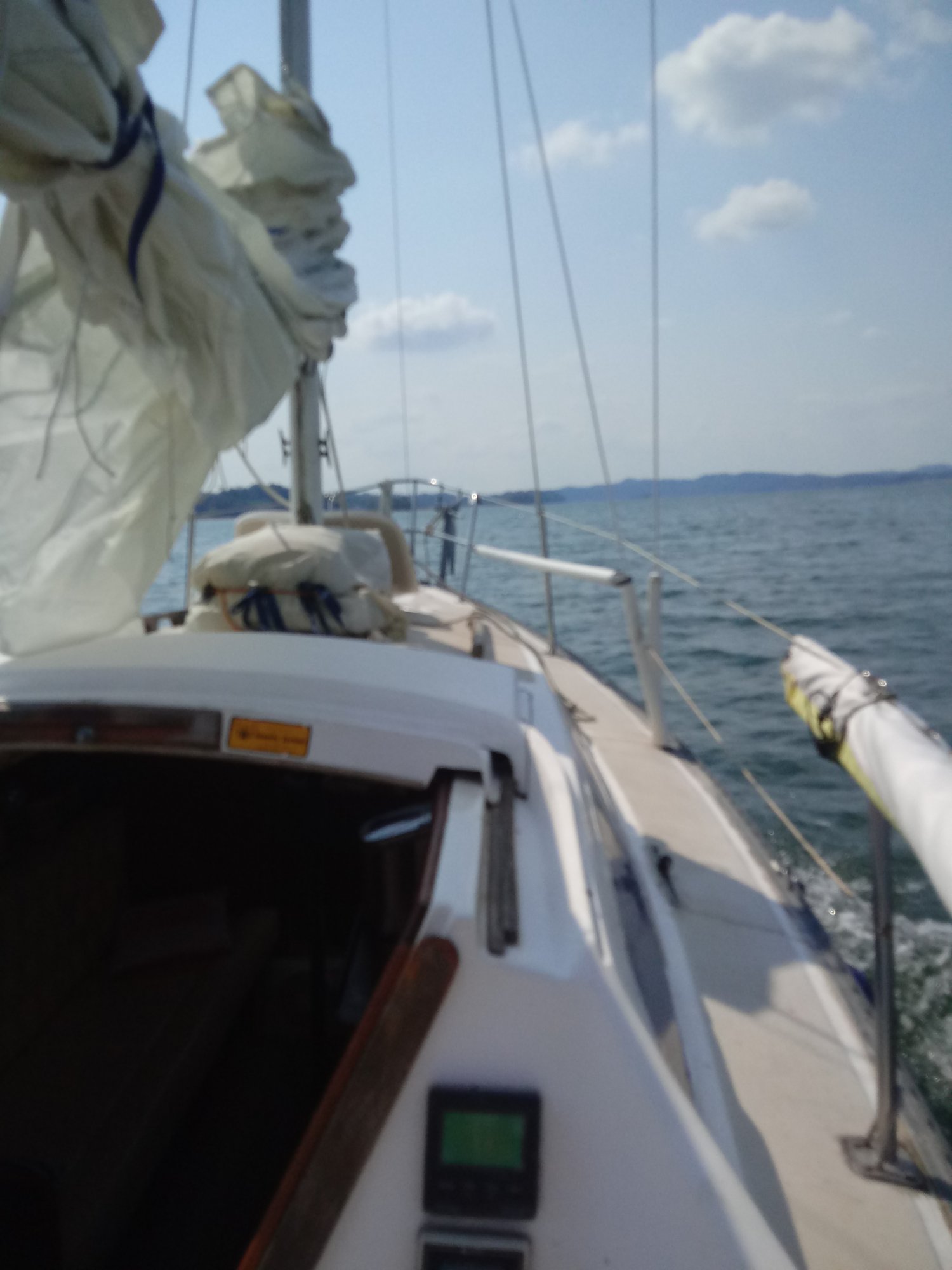

Hello, I have plenty of pics available if you still need them. Also will be back on the boat tomorrow 7/12/30 if you need closer shots.
Cheers Jim
