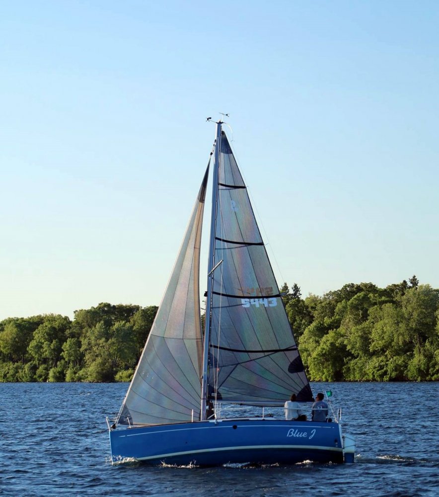

What sail cloth did you choose for your main and jib? The square topped main is similar to what I've been thinking. Did it change the balance of your sails significantly? (More weather-helm, with more sail area than before?) I've thought that adding vertical battens in the jib could solve the issue of the square head main generating additional lift affecting balance, as I really don't want a bigger headsail than what I have right now.
The sail material I chose for both the main and jib is Dimension/Polyant PXB15/10 s LS. The weight of the PXB15 is 5.95 sm/oz and the PXB10 is 5.3 sm/oz. Sails made by Evolution Sails (Jason Fanjoy of Vancouver). Sorry I wasn't supposed to mention the sail maker but others already did and Jason is in your neck-of-the-woods. Because I increased the power of the main, increasing the jib size made sense. Vertical battens on the jib helped but I also had some room to increase the luff length (jib remained at 110%). Helm is balanced well as a result. I also fly a code0 head sail along with the jib (like a cutter rig) and have a little lee helm. I'm playing around with a retractable bow keel to further reduce the lee helm when flying the two head sails. Here is a link to the bow keel build video I made:
