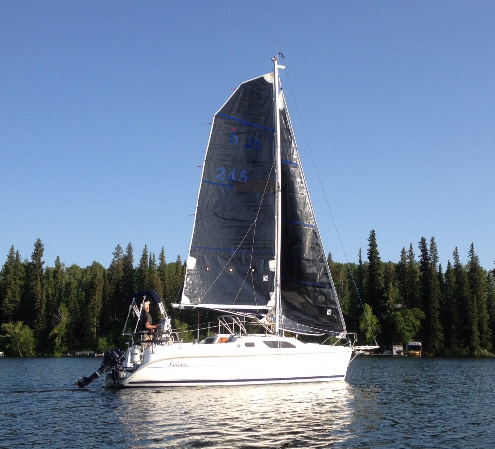

The nice thing about the B&R rig is the allowance for a large roach main. Although my little 25’ is a world away from yours, the performance of new laminate sails will be noticeable. Full battened main is easier to handle although a bit of a beast to flake and put away. The top two battens need to be pulled out slightly so the sail lays flat in the cover (but that’s a small price to pay). I needed the make my sail bag 4” wider to accommodate the lager roach main. Also, I opted for the battened jib as this adds considerable area and power. My last recommendation is to get a Code 0 asymmetrical reacher. Nothing beats these in light wind for upwind performance. Get a long bowsprit and you got yourself a cutter rig.
The pics you have look fantastic. What sail cloth did you choose for your main and jib? The square topped main is similar to what I've been thinking. Did it change the balance of your sails significantly? (More weather-helm, with more sail area than before?) I've thought that adding vertical battens in the jib could solve the issue of the square head main generating additional lift affecting balance, as I really don't want a bigger headsail than what I have right now.

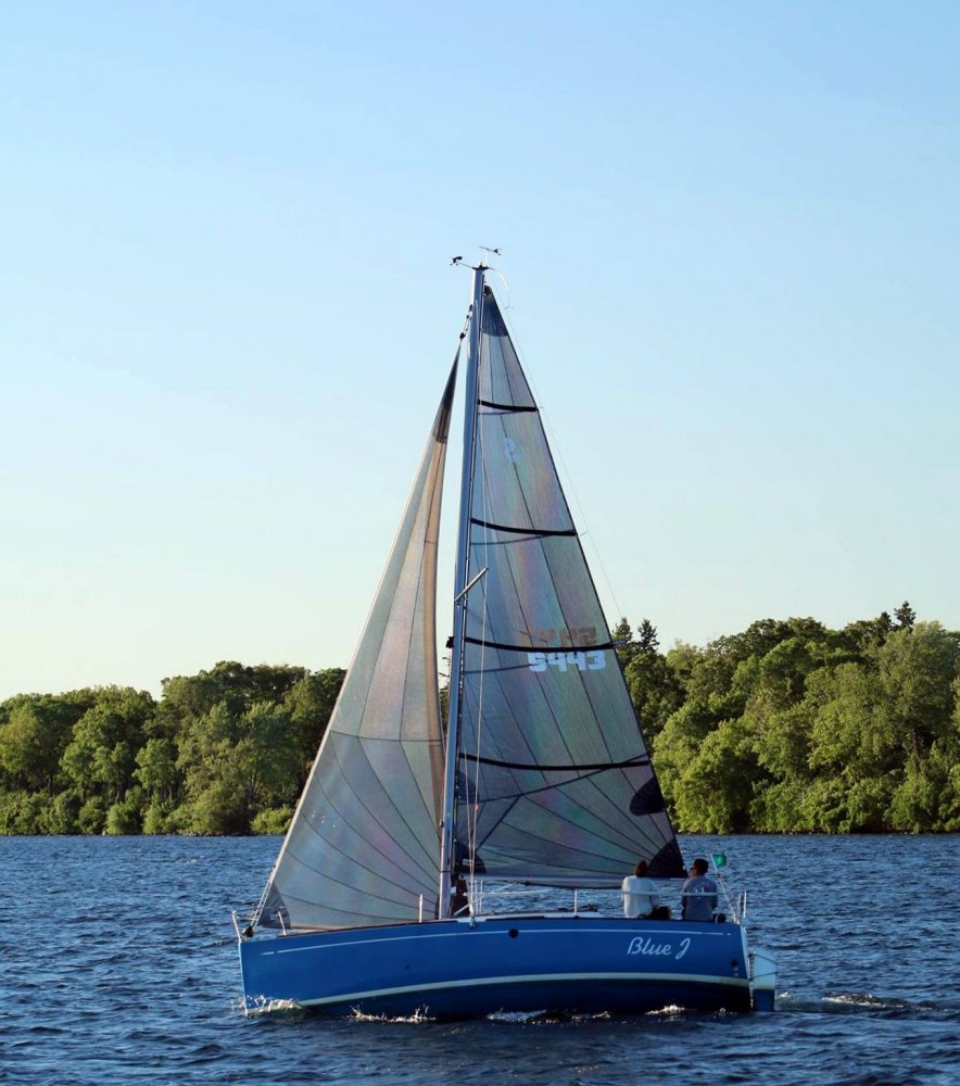

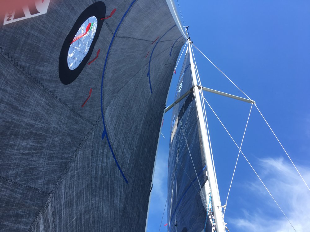

Best investment I made on the boat. As you can see by the dodger still being in place we don't take racing seriously but I love taking green crew out to get the sense of it. The boat heels less as the sails hold a better shape and can be properly taunt, there is far less drag as these sails have a well engineered camber for the boat.
They are Paneled Tri-Radial Pentex/Technora with Tedlar UV cover (Optic gray).
I had him off the line but I had water in the tanks and the dodger in place so you can imagine it was short lived. :)

Plus, who does not like black sails??
