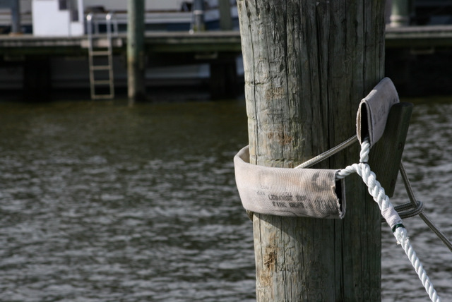

Eye Splice & Chafe Protection
I use an eye splice in the dock line with a length of fire hose to provide chafe protection. The boat in the slip next to me uses double braid with the running end passed through the eye splice with no chafe protection. It holds his Grand Banks 45 in place so I guess it works also.
