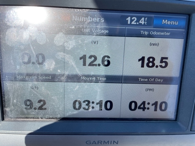

I was out today in 15-17 knots of wind and 5-6 foot seas..an invigorating sail. My CP registered a top speed of 9.2 knots…We averaged about 6 knots over 3 hours and that included a stop back at the marina to drop the Admiral off, who was not enjoying the wind and waves today.

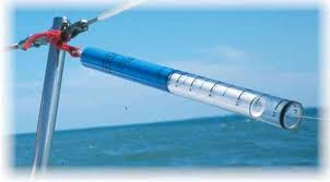

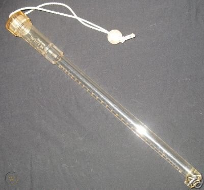

There's this.
The Knotstick works on the same principal.
We used a version of this, the Speedwand, when I was a kid.
It's just a graduated cylinder with an intake at a right angle. Hold it upright over the side and measure the force of the water entering the right angle opening.
