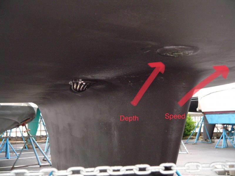

Good morning to everybody.
I have a Hunter 340 year of 1997 and i cannot find the speed transducer.
Can you help please?
Dec 25, 2000
6,059
Usually forward of the keel and off set. Depth and speed next to each other. Sole hatch access from inside.

As Terry stated, forward of the keel and access is through the flooring in the cabin. Here is a photo of my 2000 340. (Sorry, the Knot Indicator didn‘t get in the picture when I took it)
You may be looking at the plugs that you “should” have when you look under the boat. And not the actual Depth and Speed (knot) indicators. Knot sensor will be a small paddle wheel. They each should be attached to a wire under the flooring.
Hope this helps you out.
