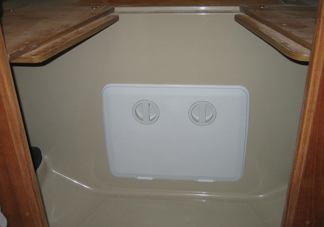

Sep 25, 2008
991
Oday 25 Gibraltar
I also installed my transducers in front of the keel and put in this access panel to easily get to the transducers. With cushions on the vee berth plus sail bags and it being a deep empty space underneath the panel is essential. I found the panel on clearance a few years ago.
