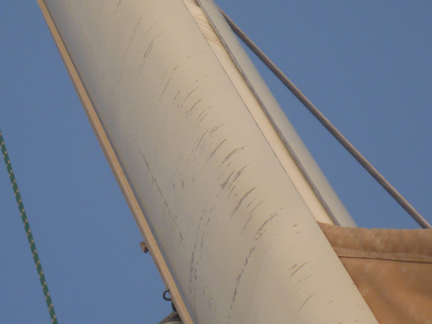

I believe it is very poor seamanship to allow one's halyards to slap the mast. In the first place, the halyard is chafing on the mast and will wear out faster. I also damages the finish on the mast, over time. More maintenance and expense, never mind the noise.
Every one of our stanchions has two supporting metal pieces fore and aft that can be used for attaching blocks (roller furler), or snatch blocks. We just take the halyards forward to two stanchion bases and they are far from the mast and cannot make noise. If we had a main halyard it could also go to one of these, aft of the mast.

the noise clearly bothers some. being polite to your neighbors is the way to go for sure. that said, the halyard chafing by slapping the mast is an old wife's tale in my opinion. 58 years of sailing, well over 1,000,000 miles at sea i have never seen such chafing. i pay attention to such things. when i went to school for ropes and wires and cables, they never said such things. no riggers have said such.
enlighten me if i'm wrong, i'm curious
the issue is simple. the noise bothers some. tie off the halyards in a crowded area.

You're wrong. Anytime two objects meet when moving, one of them will wear off. My slip neighbor seldome came to his boat. A halyard had been swinging around, against the steaming/deck light until halyard was thin as string. I guess he never looked up. I pointed it out. Next time there, he had a new halyard.

Just cause you asked sooo nicely :) and I could shoot this right out the hatch above me.
This goes all the way up the mast. Story is, when the PO lost his leg in a motorcycle accident, none of his family, friends or even the boatyard/marina personnel could be troubled to tie the halyards away from the mast. At least I got new halyards when I bought the boat, but getting the mast painted wasn't as high on my list. I can't even imagine the shape the halyards were in if they did this much damage to the paint!
