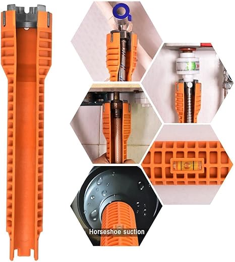

I initially bought one of those t-handle faucet wrenches to remove the single nut mounting my old faucet, but had zero luck with that. I ended up working the copper tubing back and forth until it broke off near the nut, then used a deep socket with a long extension to remove the nut. I believe the socket needed was 15/16" or 1", so I ended up renting an oversized socket set from the local hardware store. Love the new faucet, though! Best of luck with yours.

That basin wrench is a very useful tool and can save a lot of skinned up knouckles!

Dear all, you have been extremely helpful! The faucet wrench finally did the trick, and a nice fine saw made it possible to remove the parts on top of the kitchen counter. So we are enjoying a brand new tap and are looking forward to a sunny and corona-free sailing season. Wish all of you the same and thanks a million! Chiel and Jacqueline
