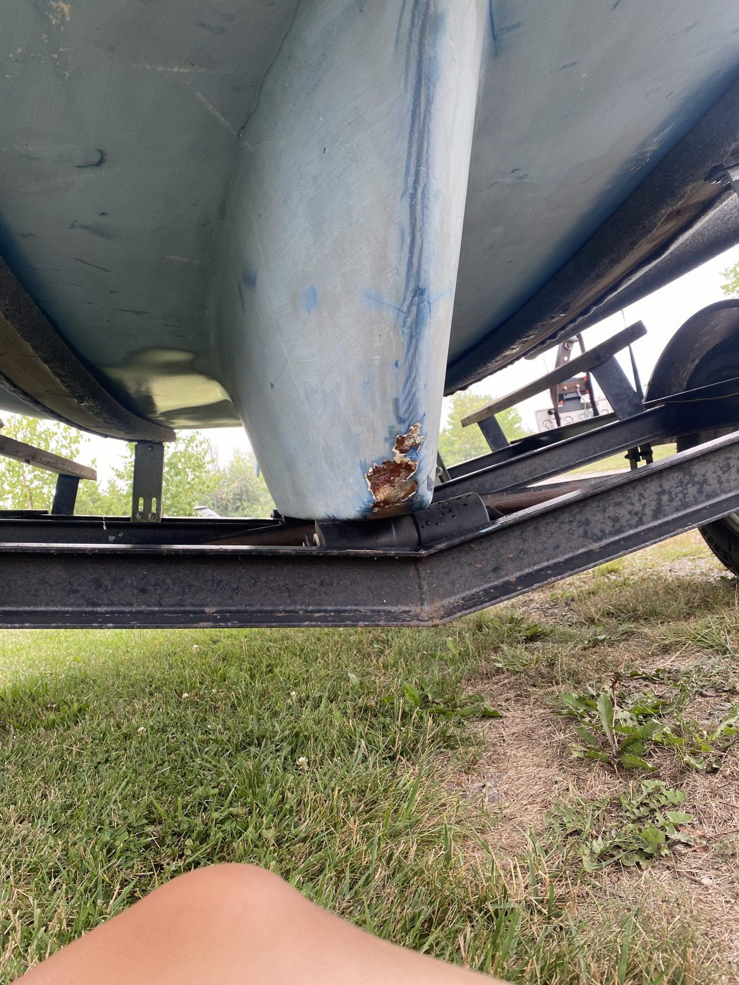

I could be wrong but it looks like some of your bunks aren't touching the hull in your pic. A properly setup trailer will tow much better. Something as simple as upgrading a 1" strap to a 2", can make a noticeable difference. At least it did on my Starwind 19

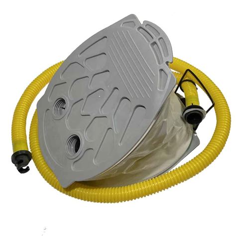

Have you tried a pump of this style or an electric one?

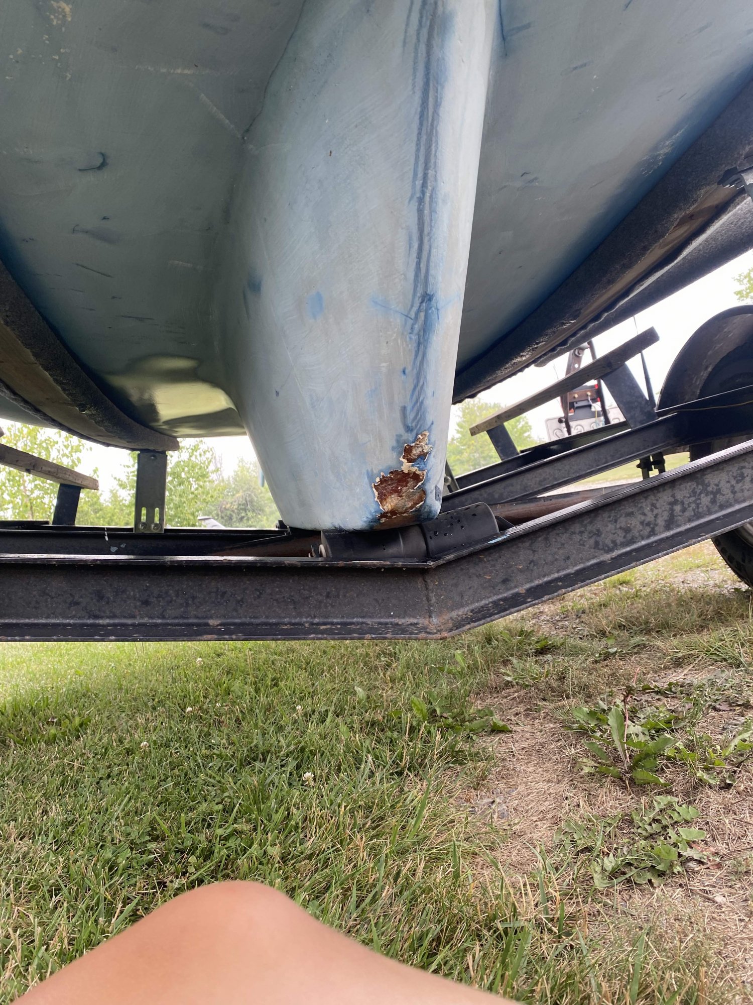

The boat is currently in storage about 1 hr away. I was planning on heading up there in a few weeks to finish winterizing it and can take a few more photos then. In the meantime, here's a photo I quickly took back in the summer - if you look near the top of the photo, you can see the gel coat crack around the front of the keel/hull joint.
Is the stuff covering the keel fairing compound or fiberglass. It looks a little thin to be fiberglass. Is the keel bolted to the hull, look in the bilge for keel bolts.
If the keel is bolted to the hull, then the place to look for damage is just aft of the keel. The force of the grounding will drive the aft end of the keel up and into the hull which can cause delamination, which is a big project to repair.

There are no keel bolts on the Starwind 19. There's a port to access the centerboard hanger bolts and if memory serves me correctly, there's very limited access to the bilge under the steps/sink. I believe the keel is covered in fiberglass but I could be wrong as I never sanded down that deep on mine.
