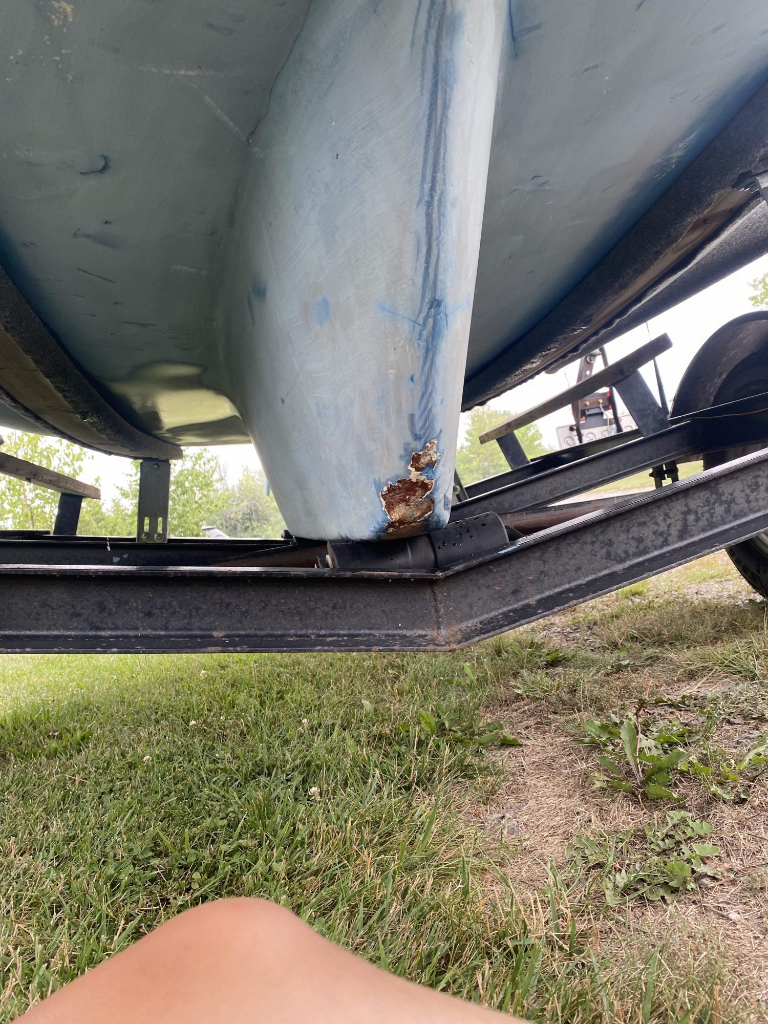

We are in our first summer of owning a trailer sailor (Starwind 19) for family adventures. We just got back from Georgian Bay - beautiful...and very rocky. We managed one good rock hit on the front of the keel, and scraped a few other times. As I was under the boat today prepping the gel coat repair, I started wondering about whether it would make sense to add a kevlar skid plate. These are often added to canoes (like this). I was thinking something like this might make sense for a small boat that would be sailed regularly in shallow waters, and occasionally would be beached. Is this something that folks do with sailboats? If so, any advice?

Haha I don't feel *too* bad. We were cautiously heading into a little bay probably more fit for kayaks & canoes than sailboats, even one with only 18" of draft. We weren't going too fast - maybe 1 knot - but didn't see the underlying rock because a gust had ruffled the surface a bit. And I promise the rock wasn't on Navionics, which we had been watching like hawks because of all the other marked hazards in the area.
A hard grounding at speed may have caused more than gel coat damage. In an encapsulated keel the impact can cause the hull to delaminate. An external keel will transmit the energy to the upper aft end of the keel and because of the leverage of the keel the area behind the keel can delaminate and internal structures, like bulkhead tabbing and furniture may be damaged.
This is a good point. After we got home I inspected both inside and outside the hull as best I could. In addition to the damage at the impact point (forward bottom edge of the keel, where you would expect) there is a crack in the gel coat around the front of the hull/keel joint. I didn't see any discoloration or deformation in the fiberglass, though, either inside or out. Since the boat needs new bottom paint (a planned winter project), I am intending to do some more exploration of that gel coat crack - open it up with a dremel tool before doing the gel coat repair. I am hopeful that will surface any more significant issues like delamination. Do you think it's worth grinding down the gel coat over a bigger area to be extra sure?

Is this an externally ballasted keel or encapsulated? Makes a difference on the repair. Photos will also help.
The way to check the hull is by tapping with a plastic hammer (screwdriver handles work too). Good fiberglass has a sharp clear sound, delaminated has a dull sound. The sound will change as you enter and leave the delaminated area.

As for the repair, I'd like to see some good photos.

The boat is currently in storage about 1 hr away. I was planning on heading up there in a few weeks to finish winterizing it and can take a few more photos then. In the meantime, here's a photo I quickly took back in the summer - if you look near the top of the photo, you can see the gel coat crack around the front of the keel/hull joint.
