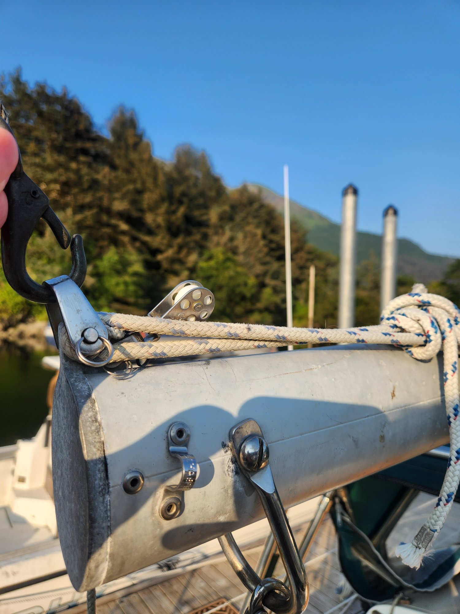

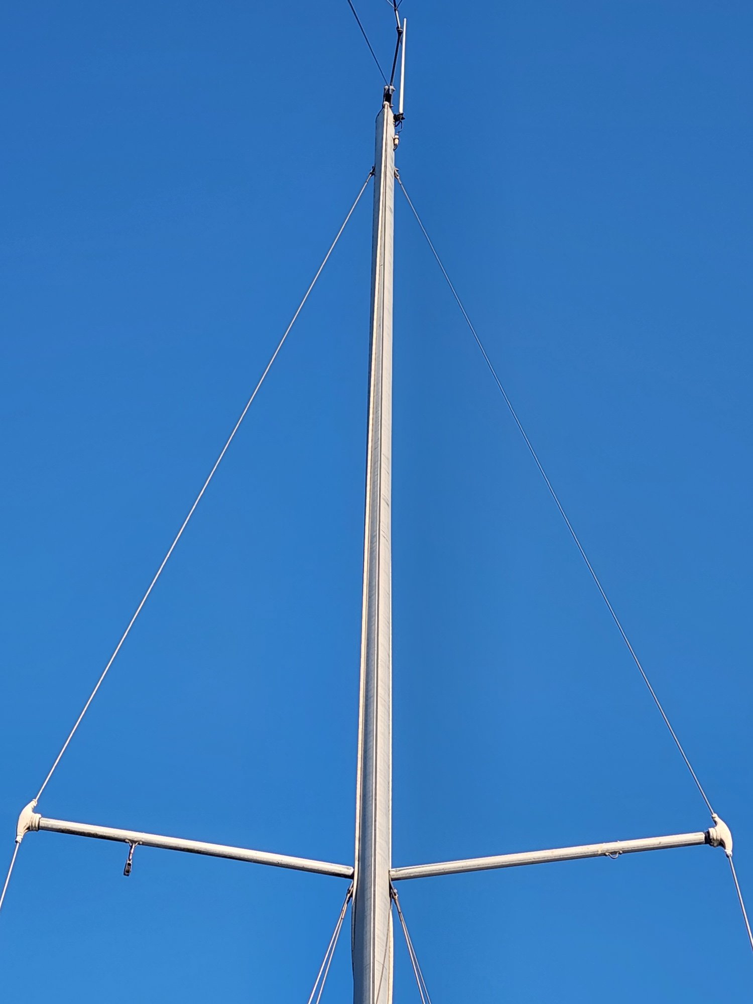

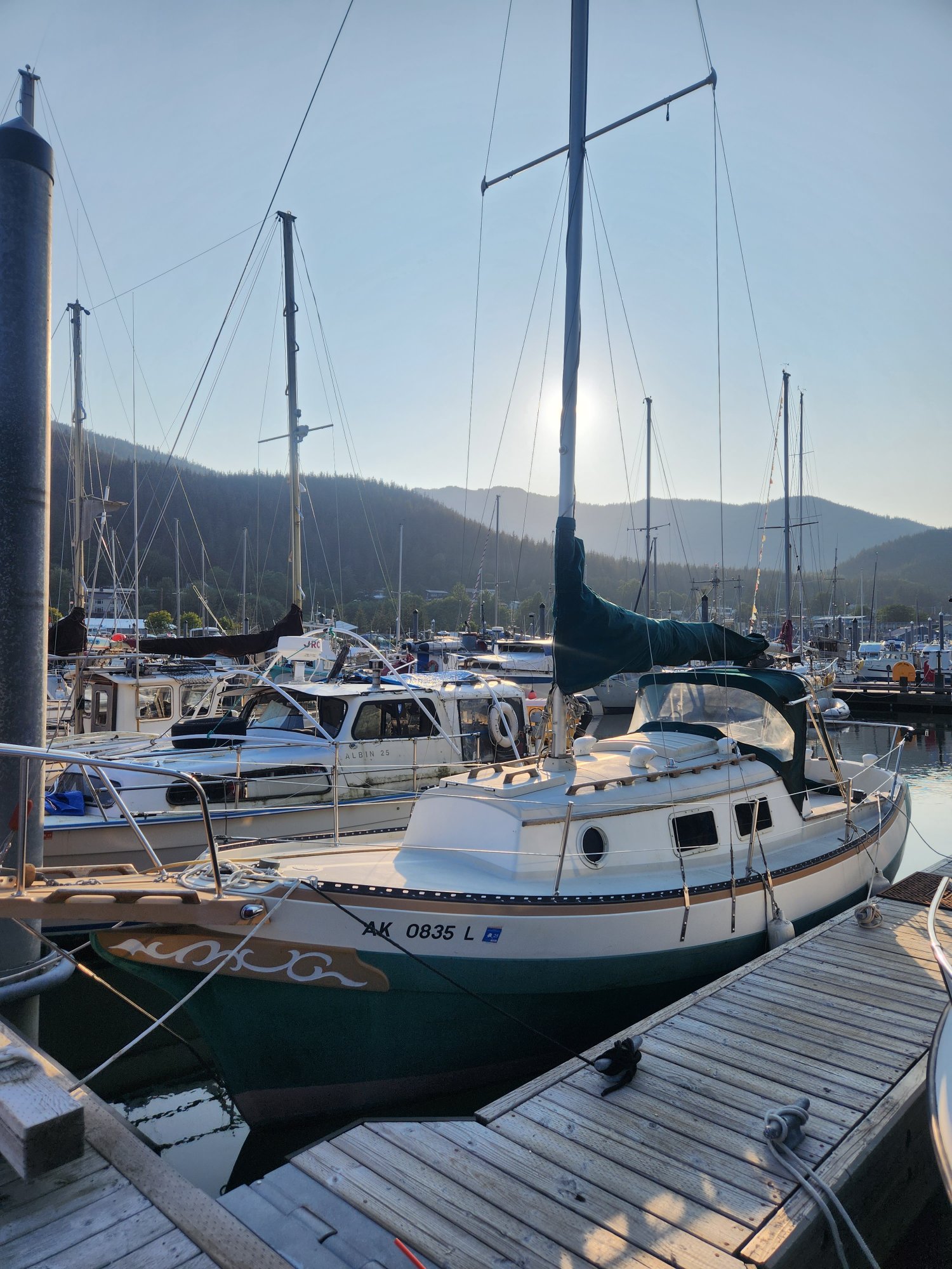

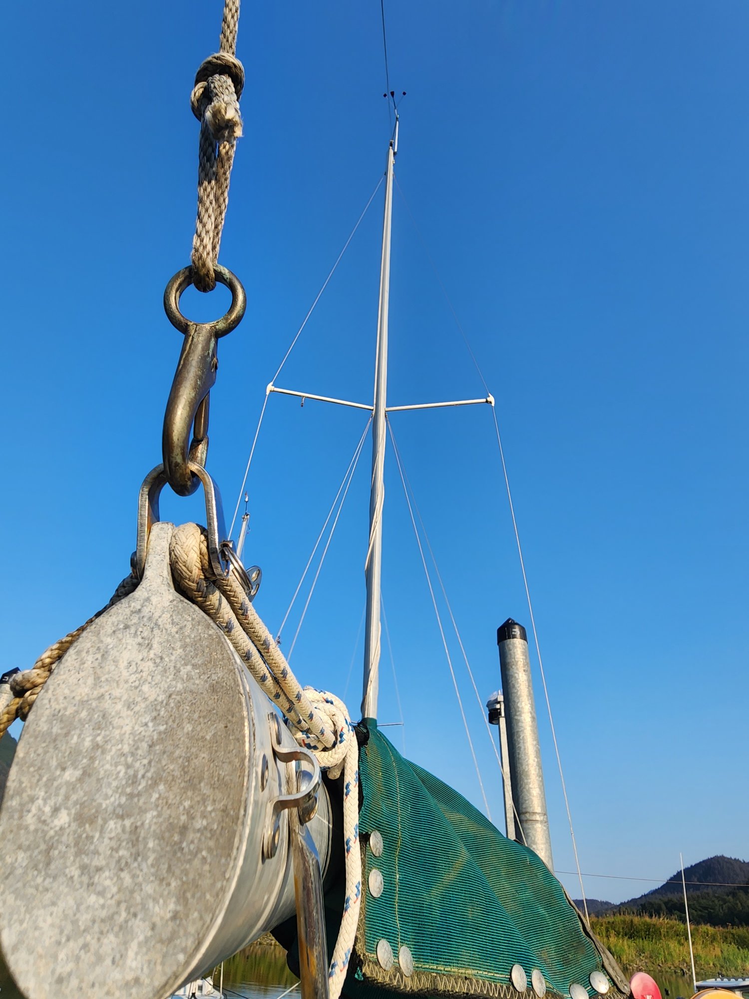

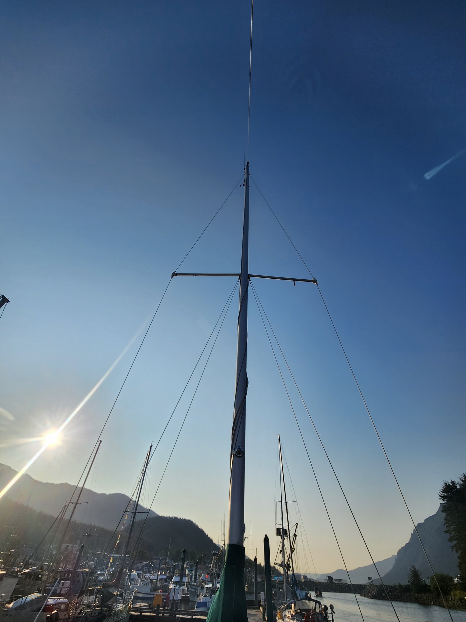

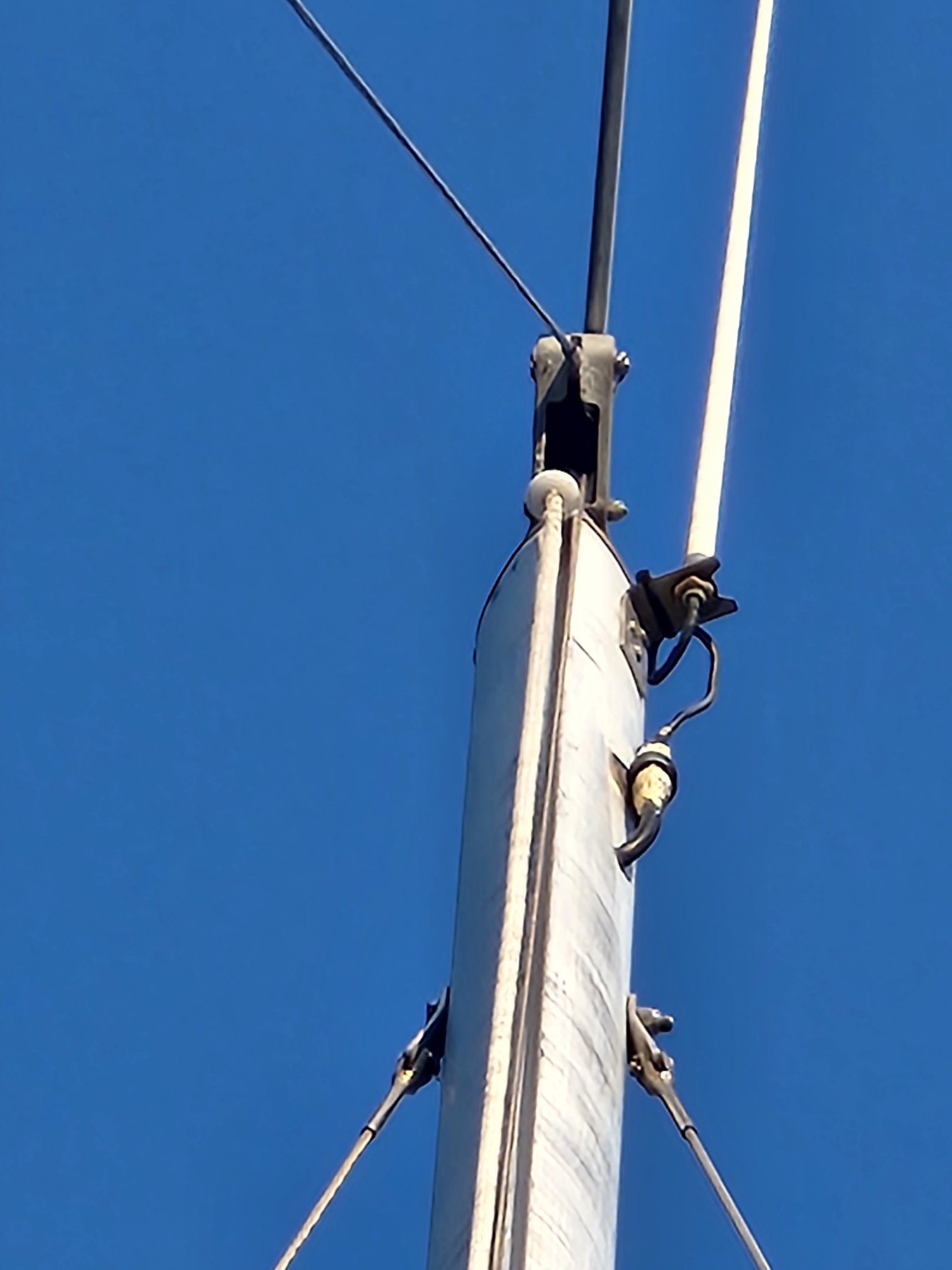

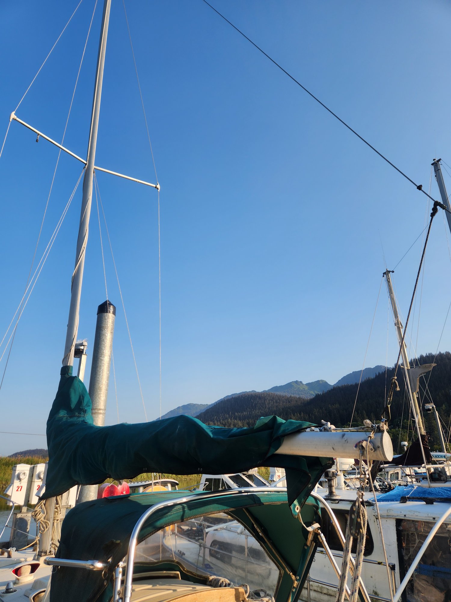

My girlfriend and I found and purchased a well-kept Kent Ranger 26 this past January with the idea of learning how to maintain, sail, and cove-camp in Southeast Alaska. We recently have completed a long list of projects and upgrades to her, and have finally begun to use her as more than an extra space on the dock. We've been able to figure and use our head sail quite easily, however we haven't been able to use our main sail as I cannot seem to locate our topping lift for the boom, delaying our cove adventures even further. I've tried looking into technical drawings, as well as basic Google searches, and even requesting to join an online Facebook group dedicated to Kent Rangers (still pending). Our main and bow halyards run outside of the mast as it is techinally a trailer sailor with a retractable keel. Does anyone have any resources or knowledge that could be used to overcome this obstacle and get our mainsail functioning? I feel I've searched the vessel up and down, and exhausted any other resourse as the company no longer exists.

No topping lift should not stop you from raising your mainsail. On top of your dodger/sprayhood you have a stout stainless steel frame. This will act as a boom gallows (google that one) and will stop the boom from falling as you raise the mainsail.
From your photographs it seems that your boat is not rigged with a topping lift.
Not unusual on a small boat.
Later, if you really think it is necessary, you can go up the mast, drill a hole somewhere for a shackle and block. ( you might actually find a hole up there) and fit a topping lift. There are a zillion different opinions on how to run and cleat them off.
Your boat is rigged with a pennant/pigtail that secures the boom to the backstay. This is to stop the boom from dropping at the mooring. It can be used as a topping lift for sail raising in very calm conditions, but I would not use it in any real wind as it would place unnatural stress on the backstay.
The pennant is only for holding the boom up. To stop the swinging and damage to the backstay while moored you will need lines from the end of the boom to either side cockpit cleat.
So, on a windless day, at the dock, take the covers off and hoist your mainsail using your boom gallows.
Then reef, using the gallows.

The topping lift is the short cable hanging from the backstay and attached to the boom.
The primary (only) purpose of the topping lift is to keep the boom off the deck when the mainsail is down. It is rarely if ever, used while the sails are hoisted as the sail keeps the boom from falling down.

A pig tail should never be used while sailing for the very reasons you have pointed out. The pig tail's sole purpose is to hold up the boom when the sail is not up.

I see, then my understanding of the topping lift was not correct. My original thought was not far off, as to support the boom from falling, but I mistook it as necessary while having the sail open as opposed to sail down. I'll put the main up off the topping lift (pigtail) while on the harbor on the next weather permitting day, though I'm still surprised the sail is what keeps the boom from falling.

That is absolutly correct. You do not want the pig tail connected (or tension on a topping lift) while sailing. The sail holds the boom up. Or maybe a better way of thinking about it is.... The halyard holds the sail up and the boom holds the sail OUT.
Do you have an out-haul on your boom? You probably do but it would be good to make sure that is also easily adjustable.

BTW, it is perfectly acceptable to allow the boom to rest on the dodger between the time the pigtail is removed and the sail is hoisted. Likewise when dropping the mainsail, allowing the boom to gently come to rest on the dodger is OK, letting it free fall onto the dodger will result in a new dodger frame. ($$$$).
As others have noted, having a rigid vang or boom kicker will make life much easier as they will support the boom and then the main halyard is used for a topping lift.
