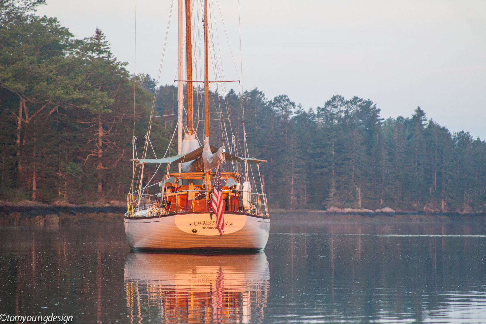

Our boats awning gets increasing use every season. Even on the coast of Maine, many mid-days would be intolerable on deck. During the high sun hours, the awning shades the cockpit, the companionway area and much of our side decks in the saloon.
With the dodger front panel raised, a cool breeze moves below the awning and through the cockpit.
We attach various sun blocks to the edge as the afternoon sun goes low. Or we just collect on the side deck that is shaded.
We couldn't sail without it.
