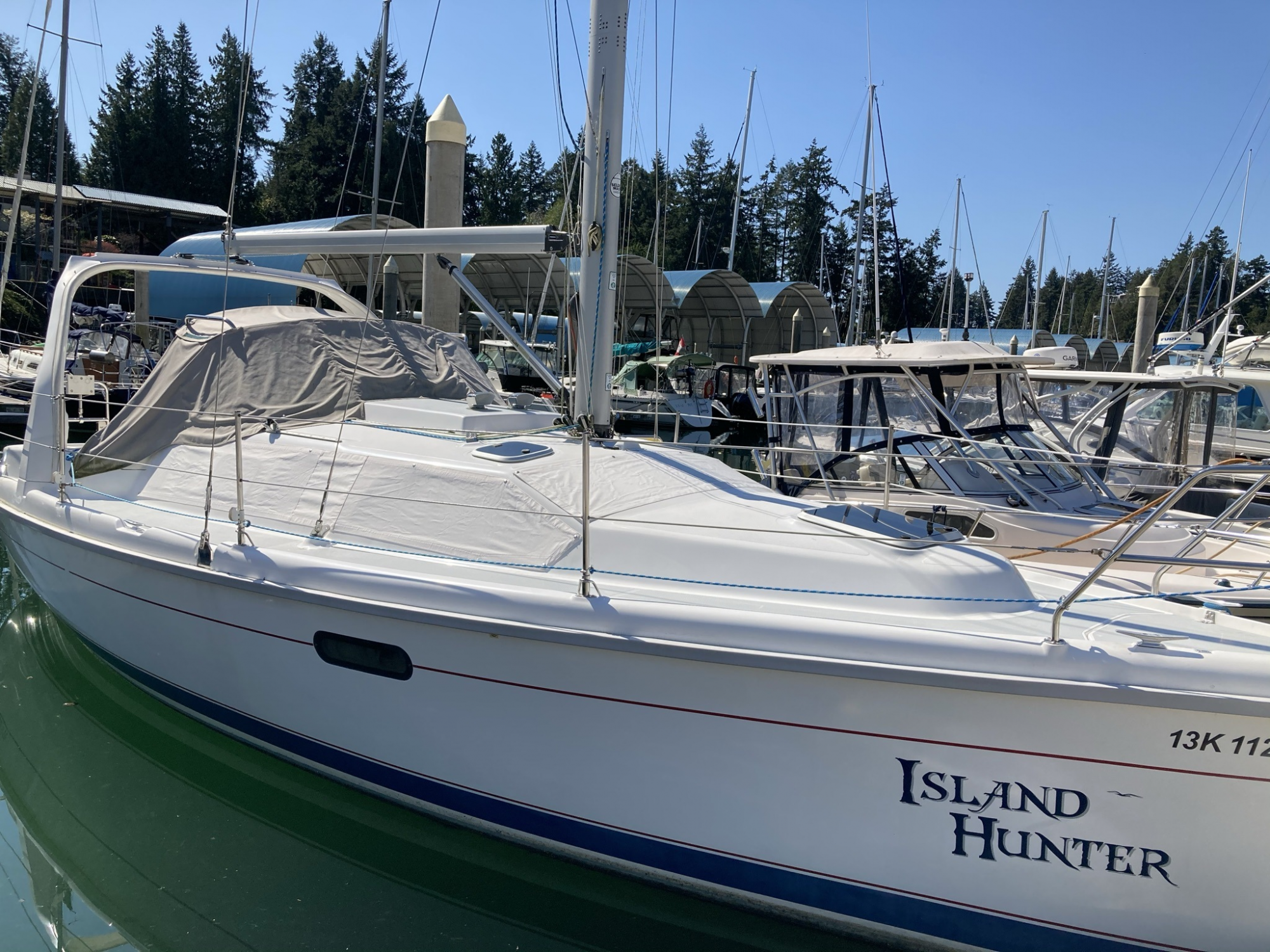

Cover your ports and hatches wherever possible.
I'm still working on hatch covers which are more difficult but more important.

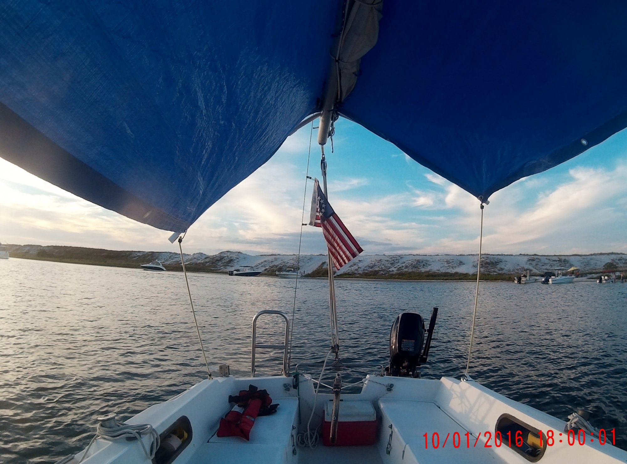

To sum the many good suggestions, provide shade for the boat and don't block air flow. A boom tent works well, a fore hatch shade works well. 12v fans strategically placed help a lot.
Add a dodger and a connector to the bimini. This allows you to keep the hatch open.
We added some DIY sun shades that make a big difference. These are rectangles of a shade material with multiple grommets. The shades are moved from place to place in the cockpit depending on the sun angle. We used something like this fabric from Sailrite.
Likes: Leeward Rail

I found a post on sailnet that discusses the the idea of using sea/lake water as a cooling loop with a fan.
Evidently the rule of thumb is you need a minimum 12- 20 F difference to affect any cooling. With a marina, (and many anchorages) being too shallow, it would be so borderline to be effective enough for the effort.
That thread does mention that a misting system, on deck, on a fresh water lake.. works well and consumes little power.
I have a spare 12 VDC sprayer so that might be a fun experiment once I make the bimini and filler piece and see what the boat's existing DIY boom tent looks like.
