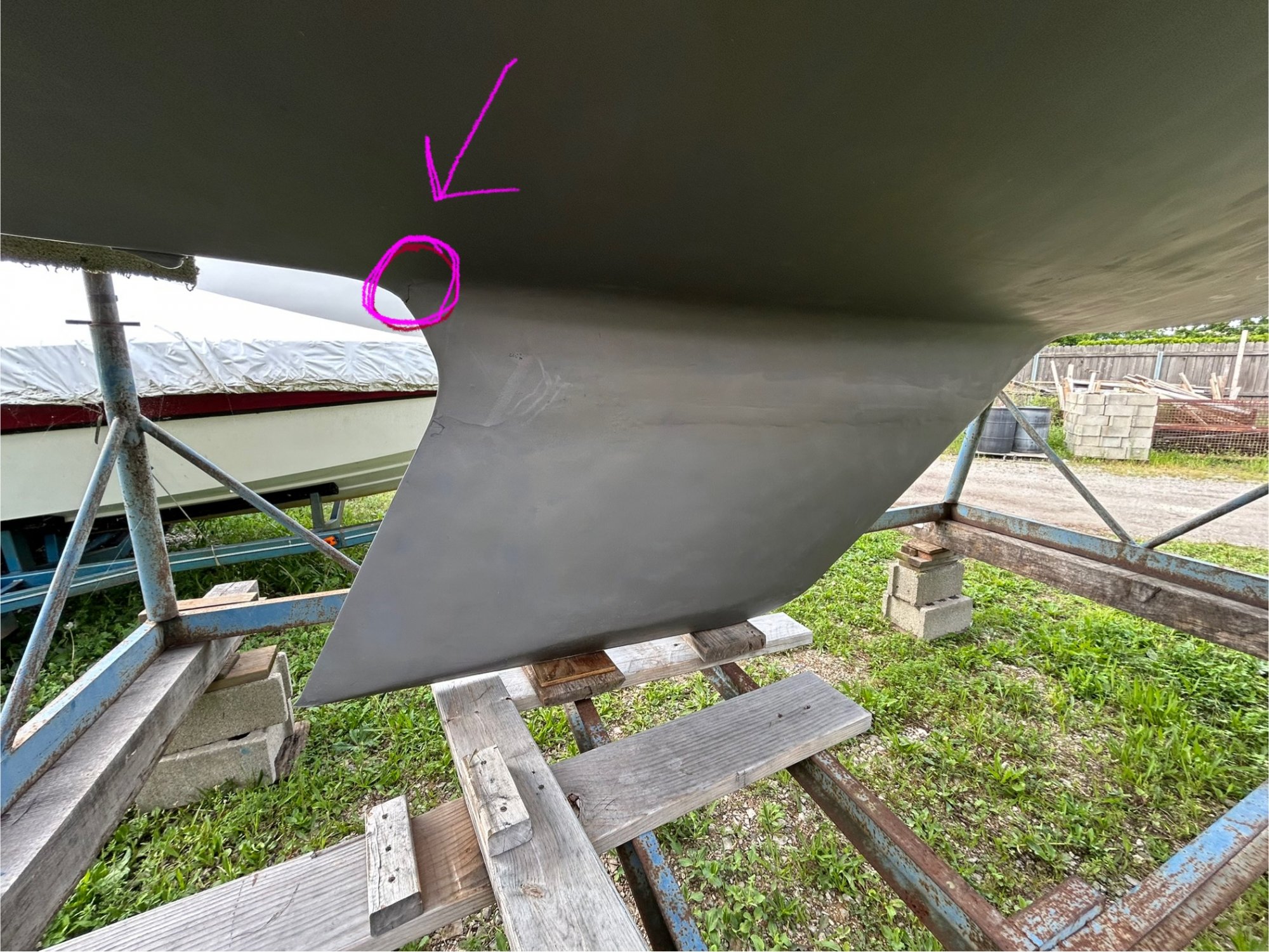

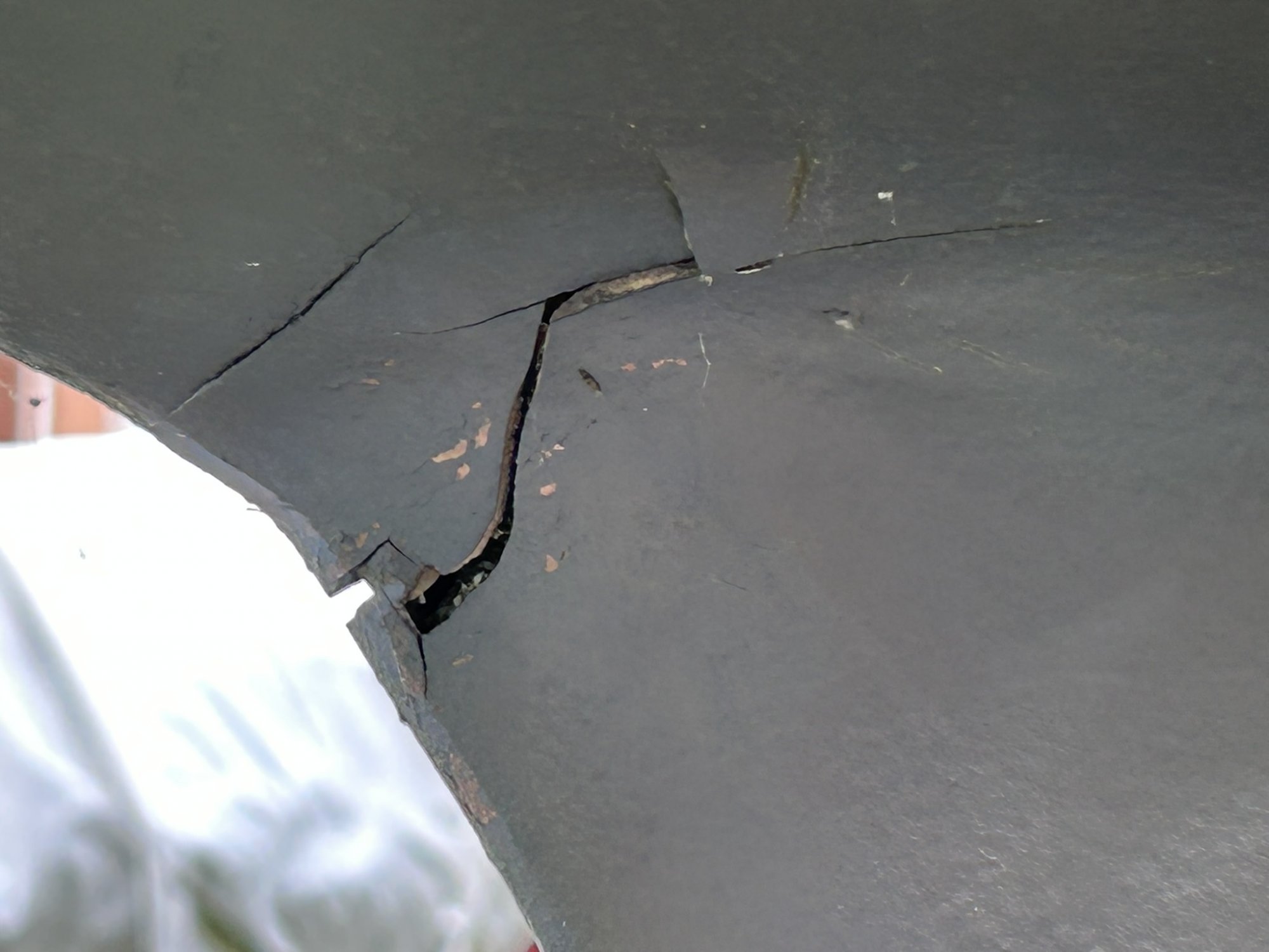

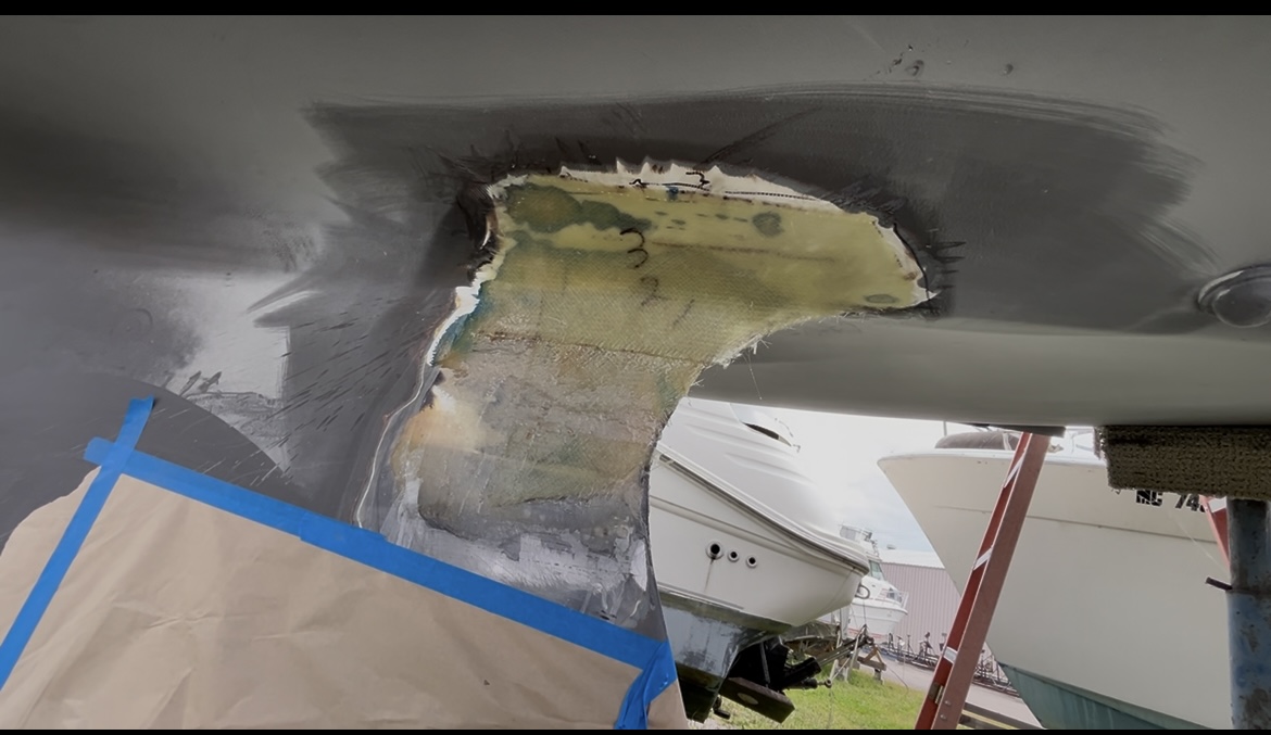

This crack goes all the way through to the bilge and leaks water. On the hard, before getting the boat put in this spring, the crack was not there. I'm 100% sure because I put on a coat of VC17 on that very spot two days before they put my boat in. The crack happened while the marina was putting my boat in the water and the leak was immediate upon plashing the boat. (I was not there when they moved my boat and splashed it). Should I blame my marina? Did they drop the boat on the keel? I'm not so sure how else to explain how this happened. Any thoughts you have would be appreciated. Also, ideas on a repair would be great.

If they dropped the boat, there will be impact evidence on the bottom of the keel - look it over carefully. It's possible it was damaged previously and repaired.
Sep 25, 2008
7,750
Alden 50 Sarasota, Florida
The bottom of the keel looks fine which obviates the dropped explanation. I doubt the worst possible position of a sling could do that either. Plus it would seem impossible for the operator or the attendant to not see that crack as they were lifting the boat. Assuming it’s a bolt-on keel, what is the condition of the aft bolt(s)?

That looks like the turn in the hull where the hull meets the fiberglass keel stub, not the keel itself

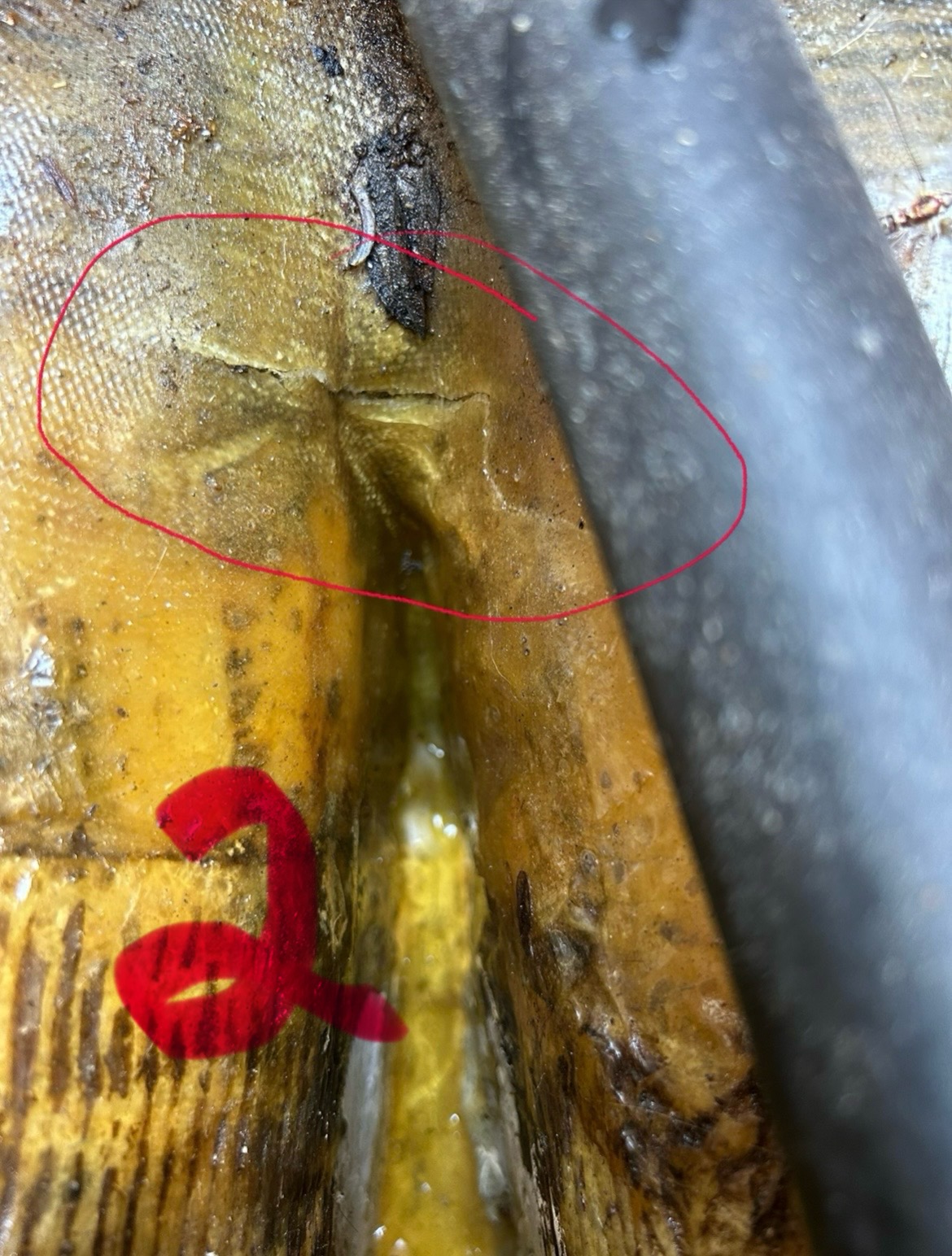

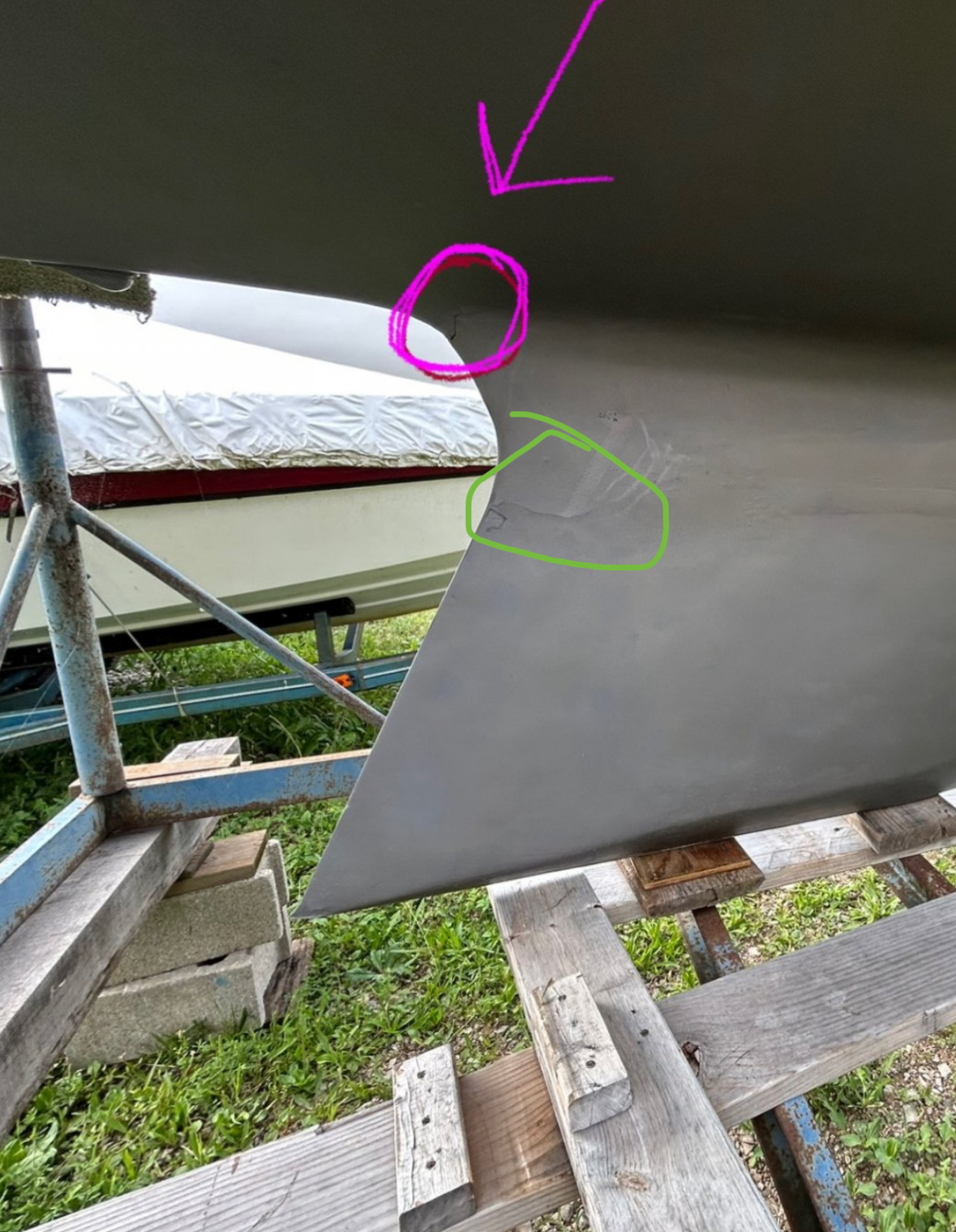

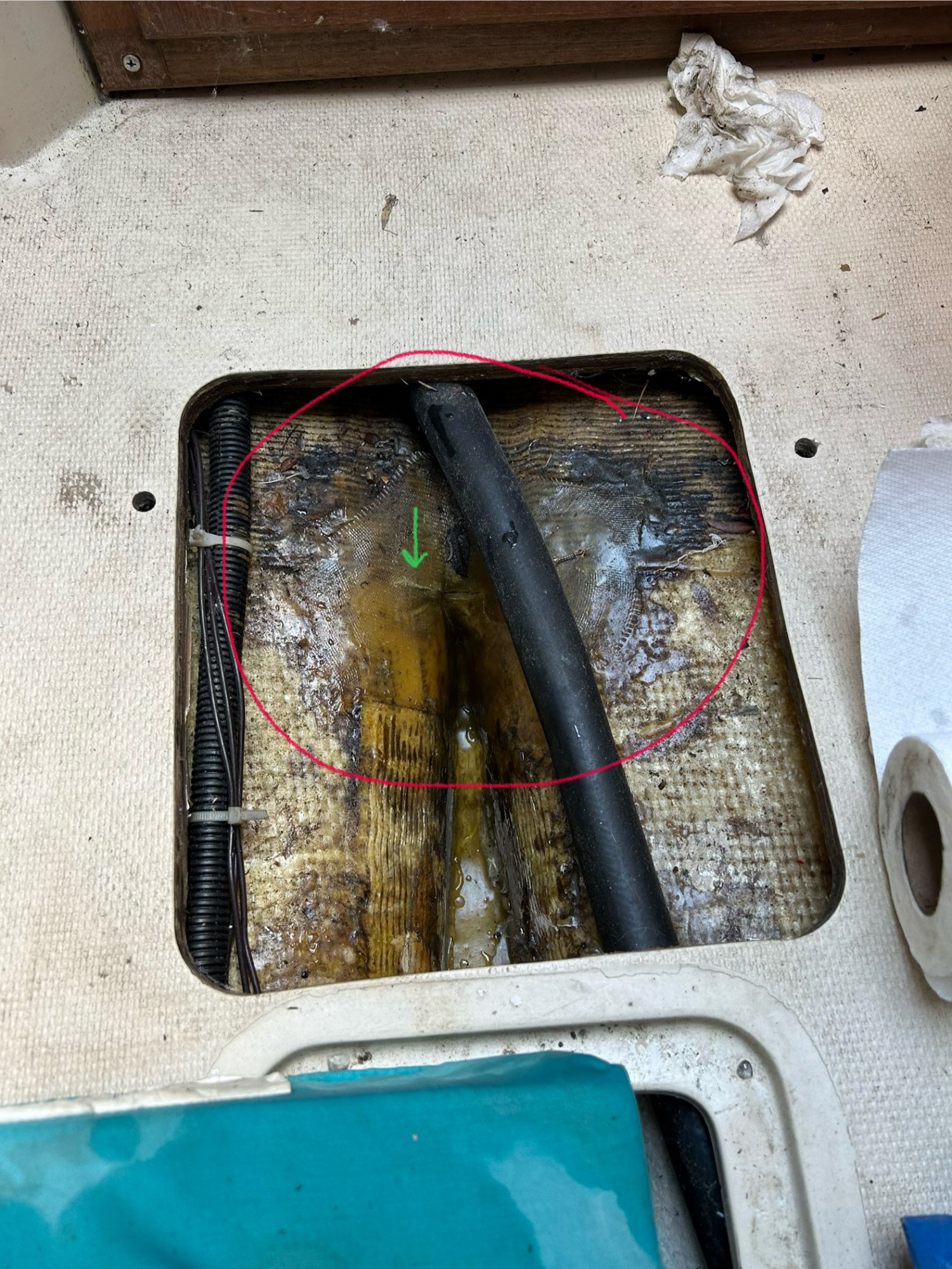

Is what I’ve circled in green a separate crack where the hull meets the keel?
If so I wonder if the two may have been caused at the same time? In any case I think the repair in the area you’ve circled will be pretty significant effort.

Exactly. It not the keel it’s the keel stub. The part you circled seems to be more superficial than it looks and I think it was there prior. I’ll look again. The repair estimate is $1500-$2000. He starts Monday. Should impost photos of the repair ?

What you can do is lift up the floor board and inspect around the keel bolts. This could give you some clues. I would not expect to see further damage on the bottom of the keel because this does not look like damage from being dropped on the keel. It looks more like the hull aft of the keel flexing upward and/or the keel flexing forward. The former could happen if the boat lacked structural integrity to resist sagging in the sling. I do not know enough to know if this could be caused by improper sling placement. The latter would imply gross mishandling - like allowing the boat's stern to slide down, supported by the aft edge of the keel against the sling. (Inspect the area carefully with a magnifying glass for evidence of abrasion from a sling. If found, photograph.)

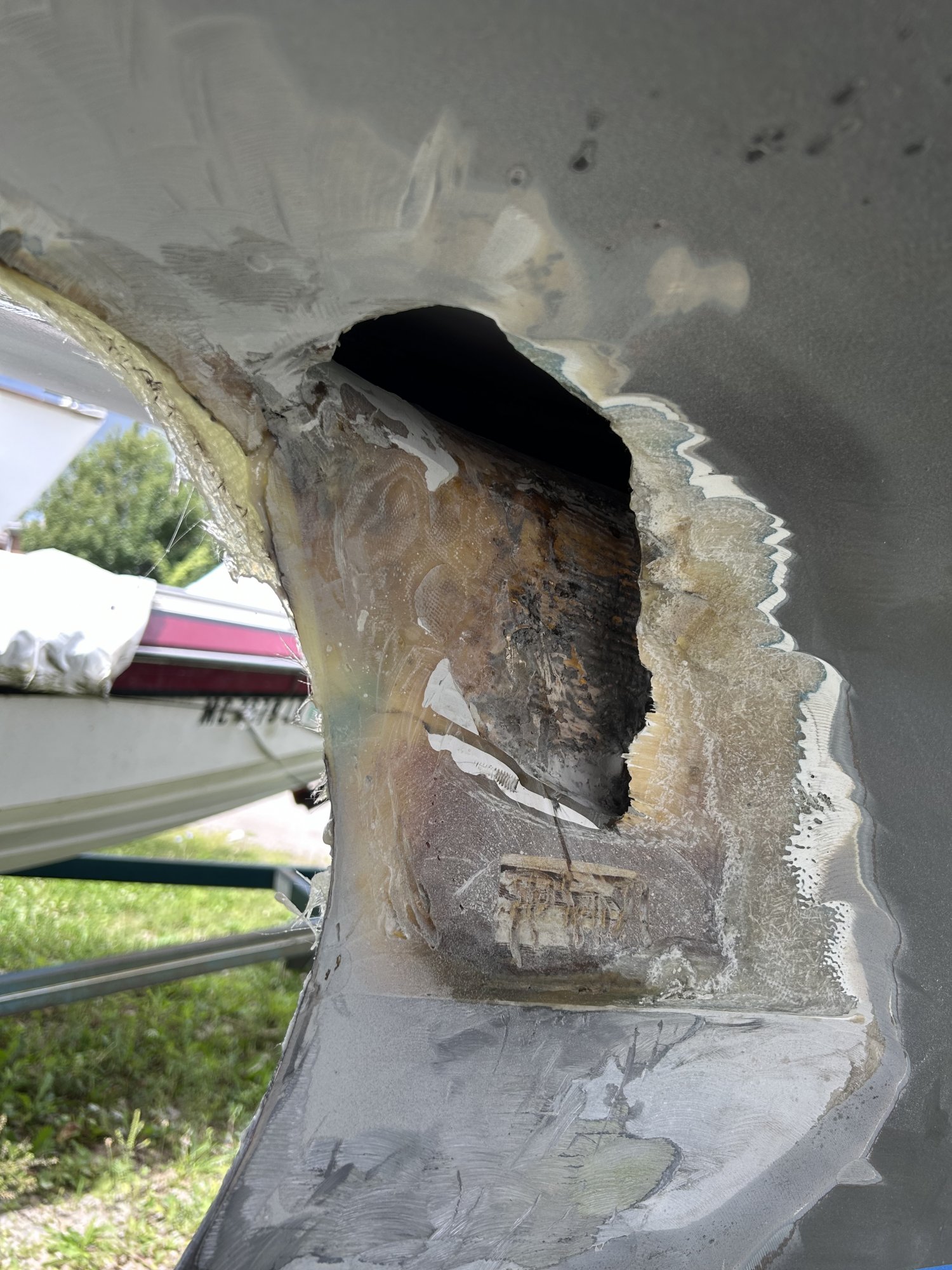

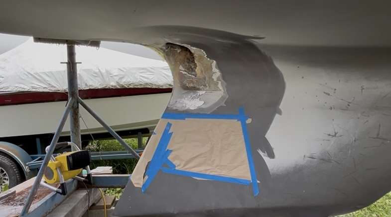

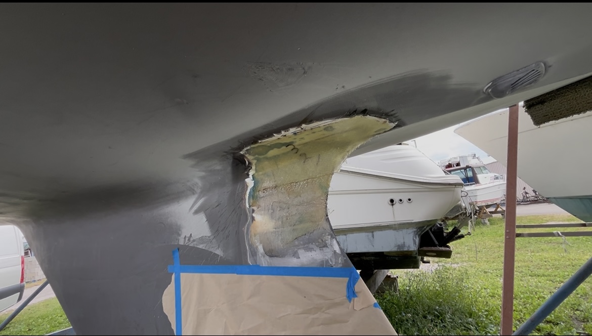

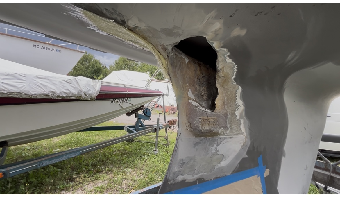

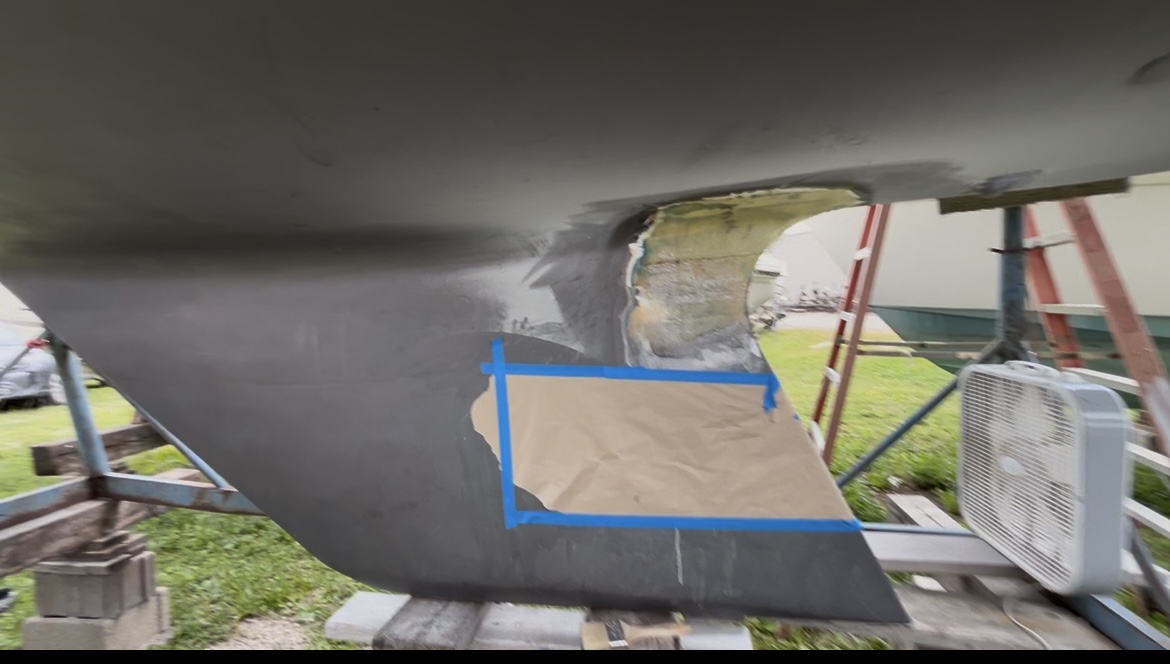

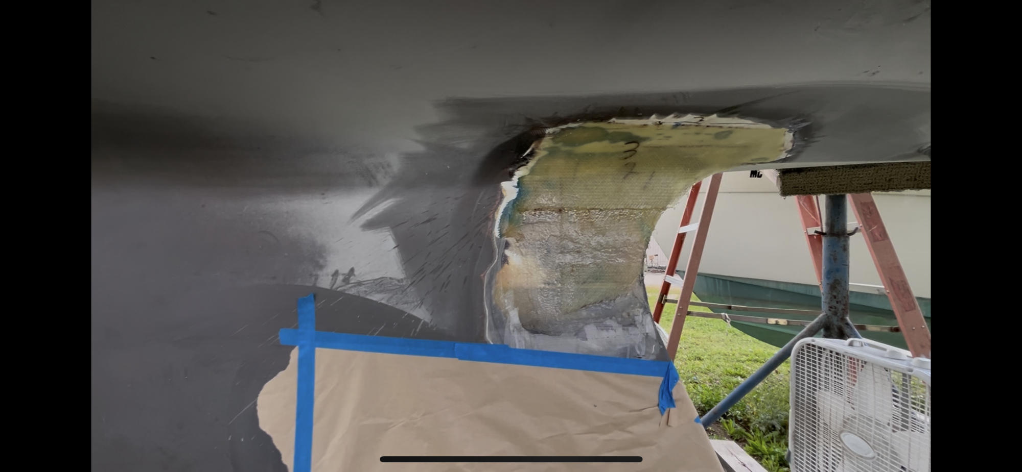

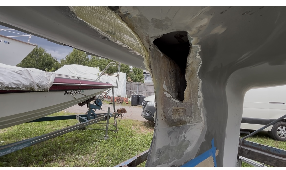

Update: the repair has started. It’s unlikely the marina had anything to do with the damage. The PO had grounded pretty hard and the repair was never done properly. So it was destined to fail and crack. The repair guy confirmed all of this. Here are some photos of the repair.

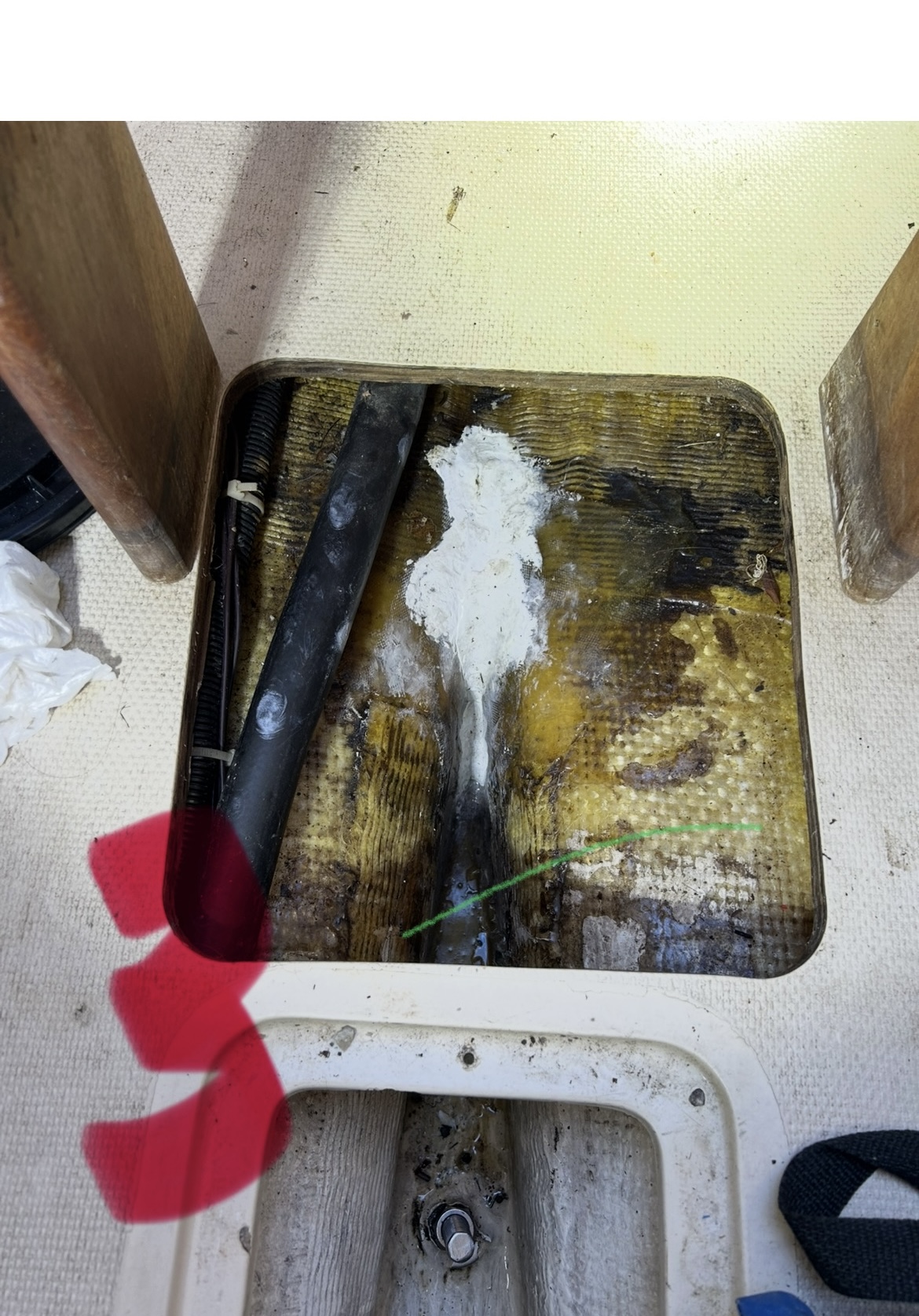

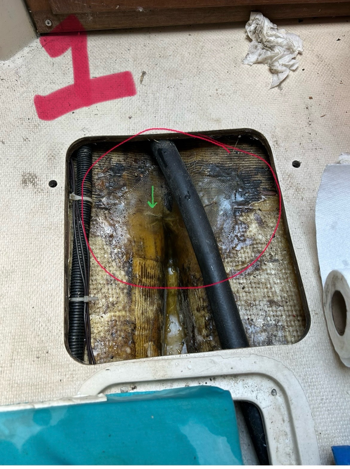

I was able to patch the active leak with JB weld water weld. I was able to stop the leak. You can see the white patch in the photo at the aft end of the bilge. The boat sat in the well all summer (never moved it for fear the patch would fail) while I figured out what to do and find someone to fix it. You can also see in the photos the hole cut in the floor. That was a question I had when I purchased the boat because no others had this. The hole is there because the PO grounded the boat and had a poor repair done. Lastly the upside…when you can’t sail your boat nothing to do but clean it and redo the teak.

In photo one You can see the repair that was done inside the bilge by the PO. If you look you will see the fiberglass repair. It’s shiny. ( and thin) the inspection I got notes this repair but he said “it’s fine” when it was in fact merely a bandaid doomed to fail. I’m just glad it’s behind me.
