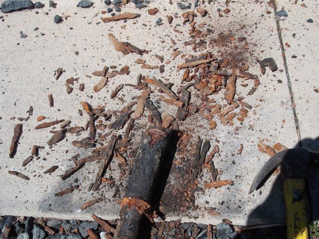

This is extreme rust! this is all that remained of a one and a half inch black iron pipe nipple that had been brazed to a one inch galvanized pipe forty years ago.
