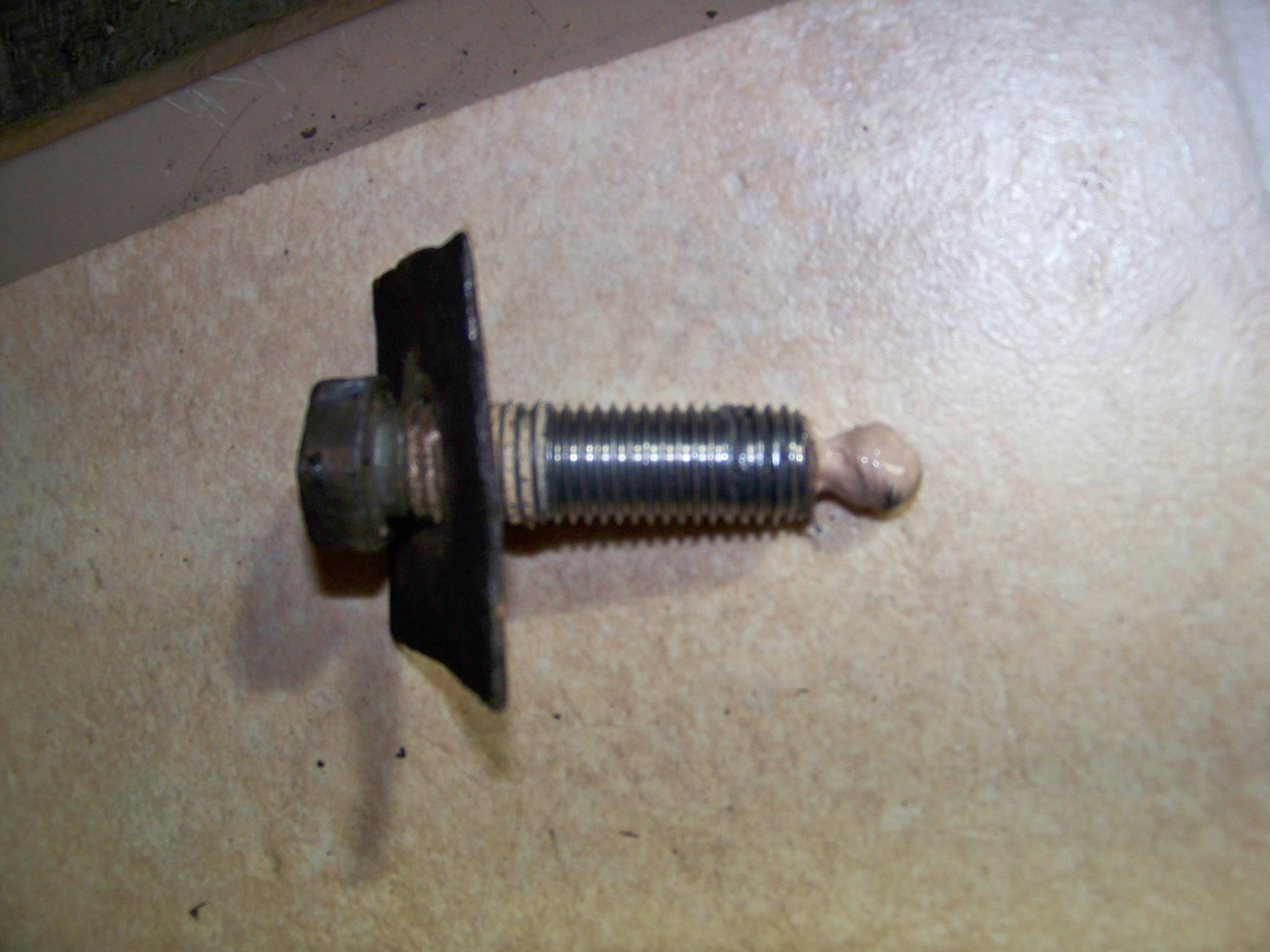

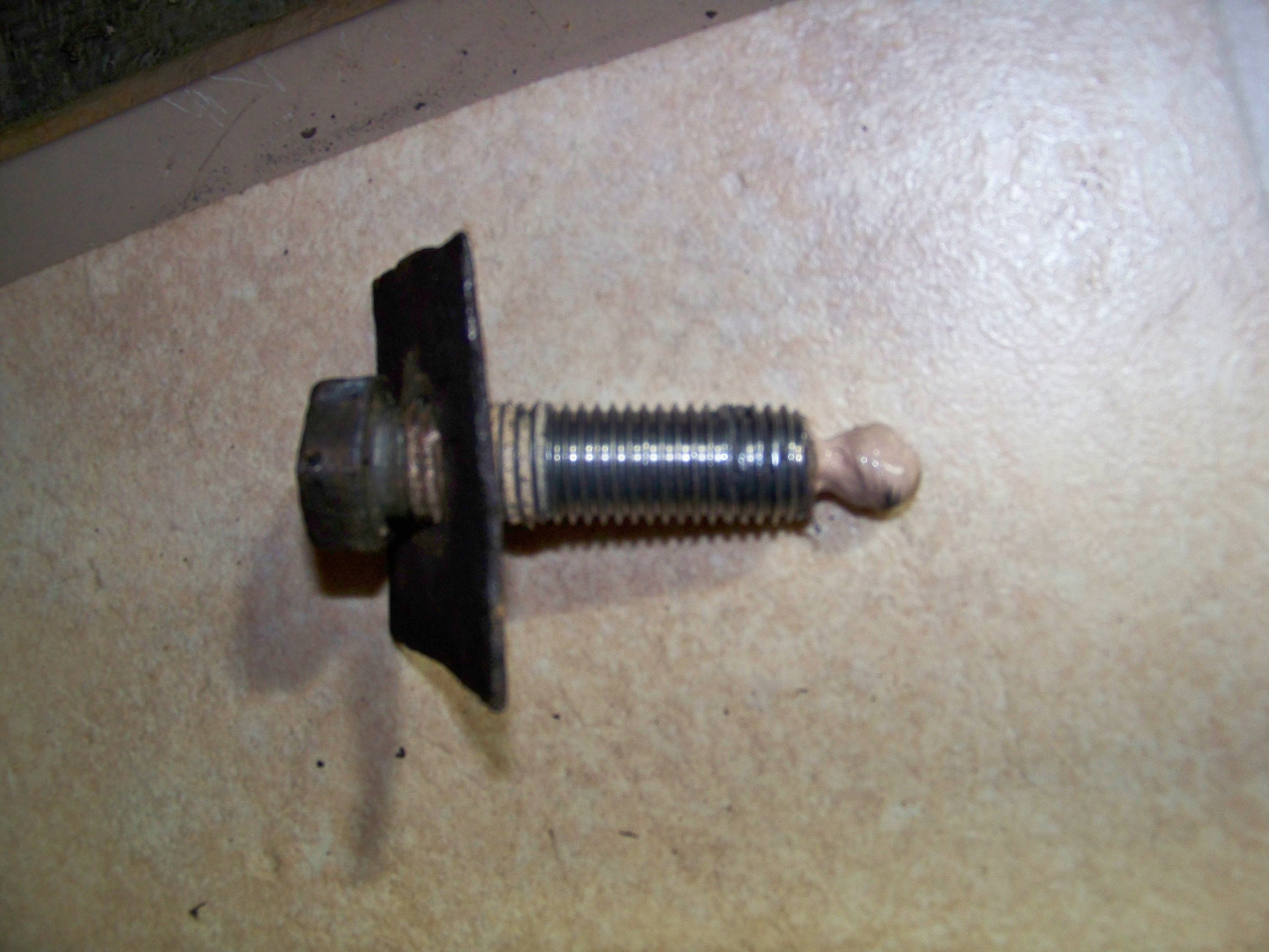

Oct 9, 2013
72
Beneteau First 38 Belmont Harbor
Pic of one extracted keel bolt:

Hi Olivier;
Yes, you can be sure we only removed 1 bolt at a time. At this point, our goal was simply to see if we could break free, remove, and then reinsert each of the keel bolts. Next step, once the new bolts are received from Beneteau, will be to again remove each bolt (one at a time), clean up the old caulk, recaulk with fresh caulk, insert new bolt, and then to re-torque to specs once all of the bolts are in place.
I am still waiting for feedback from Beneteau as to what might have been used for caulking/sealing the gap between the underside of the bolt head and the fiberglass hull. We are not sure if the caulk that we saw on the bolts was (a) from the keel to hull joint which oozed into the bolt hole when the keel & hull were mated or (b) if it was caulk that was used at the top of the bolt to seal the fiberglass hull around the exposed threads of the upper section of the bolt. I am guessing it was the latter.
Whatever was used, it is still flexible after 32 years and can be pulled/stretched by hand. Thus, I am guessing that it is not 3M 4200 or 5200. Both of those would have set up after 32 years.

Bolts only need to be one and a half times longer than the diameter to have maximum holding strength.
Minimum engagement depth for full structural integrity, will vary greatly depending on the materials in question (grade of the fastener) & the thread form.
Aug 22, 2017
1,609
Hunter 26.5 West Palm Beach
5 Using a DREMEL with a heavy-duty cut-off disc, the bolt head was separated from the washer by cutting horizontally at the junction between the base of the bolt head and the top of the washer. It took about 1 disc per bolt to cut around each of the bolt heads. Rationale for this cut is to separate the bolt from the washer. If the bolt is attached (rusted) to the washer the amount of force required to remove the bolt is (a) force to extract the bolt from the threads in the socket in the keel, PLUS (b) the force required to turn the washer which is attached to the fiberglass hull with adhesive. By separating the bolt from the washer, the force required to remove the bolt is significantly reduced since ONLY the bolt is rotating...
Another advantage of grinding out material between the bolt head & the surface below it, is that you relieve pressure on the threads, which also makes the bolt much easier to remove. I used to use that same trick when removing original barrels from old Mauser actions.
