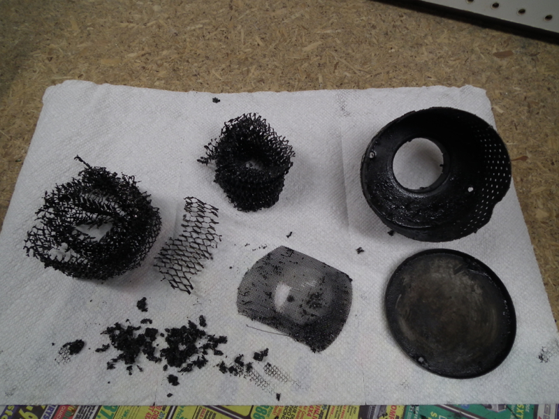

I was on my boat for the first time this year yesterday. On a whim I decided to remove the air intake filter. I couldn't believe what I found. The inside screens were falling a part and the screen that prevents things from going into the motor has a hole in it ( I made it bigger getting the canister apart). I can only hope nothing was getting into the motor. Obviously this will be replaced. Might want to check yours!

My guess - these photos added a new item to a number of to- do lists out there. I know it did to mine.

Went to see my friend Merlin at Kaufman diesel and he supplied me with this filter. The original is 4" in diameter, this one is 5 1/2" but fits very nicely. I also removed the intake to make sure there weren't any of those small pieces in it. There weren't any but it was very greasy inside from when the breather tube used to drip on it. I re-routed the tube a few years ago. While it was off I cleaned and painted it.
DuraLite has a website with specs on the filters if any one is interested.
