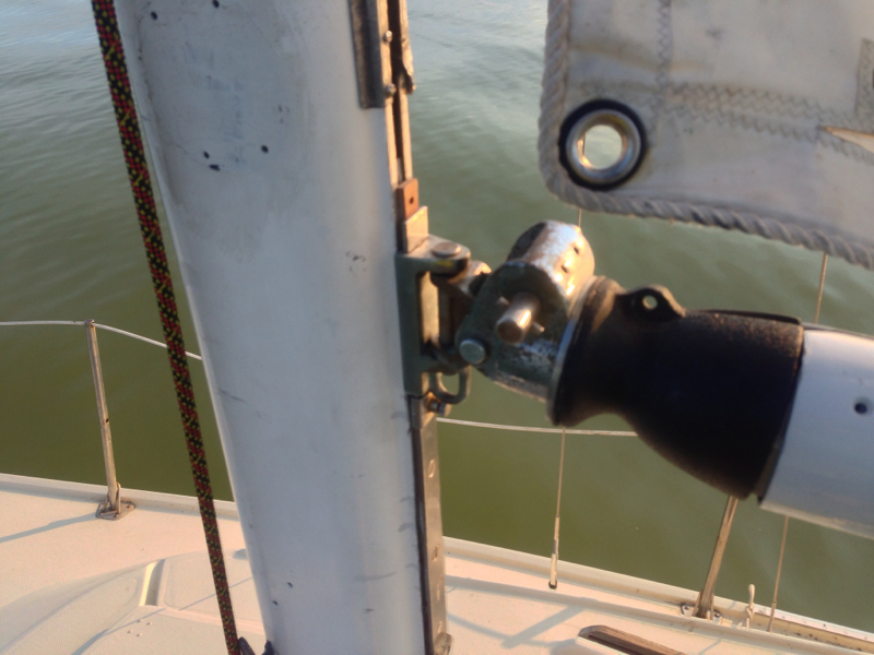

I'm the Commodore for the Utah Lake Yacht Club. Yes we sail here. We sponsor the only Sea Scout Ship in Utah. Anywho, we just picked up a 1974 Catalina 27. It seems in good shape but I've got lots interesting things here. We really didn't get any info from the previous owner. It looks like furling boom. Not sure I like that set up. Anyone ever seen one of these? The travel is also oddly rigged. In any case we're pulling here out of the water in a week or two for a shave and a haircut.

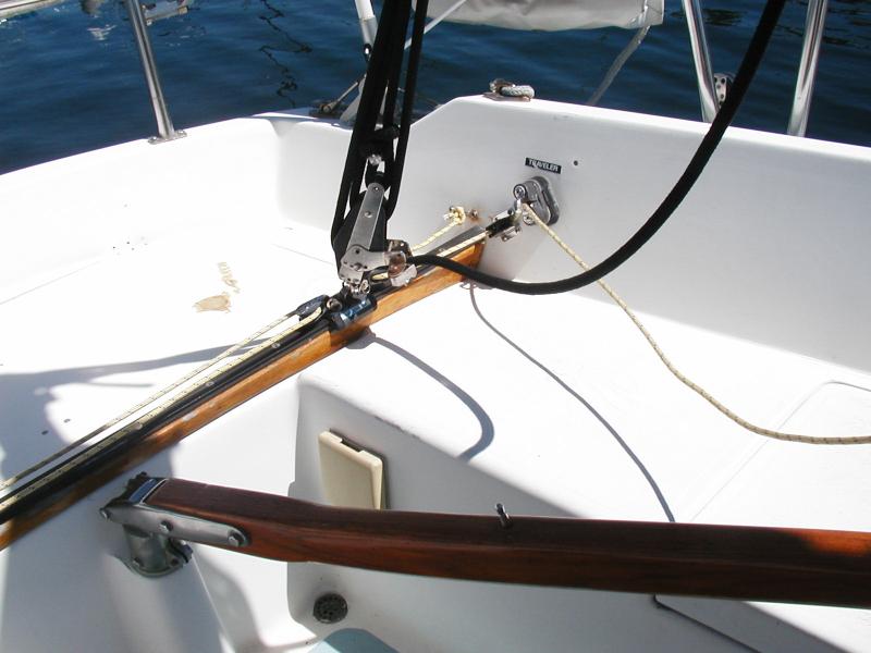

The traveler / car setup is definitely odd. I haven't seen anything like that before.

I realize the main is flaked, but there are gears at the gooseneck that turn the hole boom.

Someone took your traveller car and track. You'll have to replace it.... A Harken car and 4 feet of track plus fasteners will cost you about $250.
The boom and gooseneck are not OEM. It looks like a previous owner modification because who was too cheap to purchase a proper boom from Catalina Yachts.
Do not try to rig up the roller boom......keep it immobilized so you can install a vang, use slab reefing instead. Go to www.catalina27.org to get owner manual, equipment list and other important stuff.

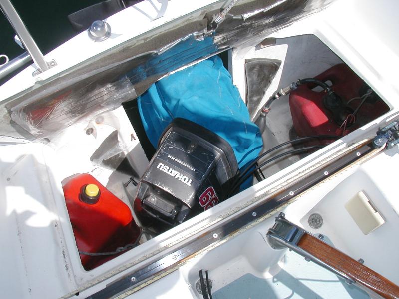

A 9.9 electric start, remote control is optimal for these boats. Look for an older 2 stroke...they're much lighter.... or if you blow the budget, get the lightweight Nissan or Tohatsu 4 stroke.

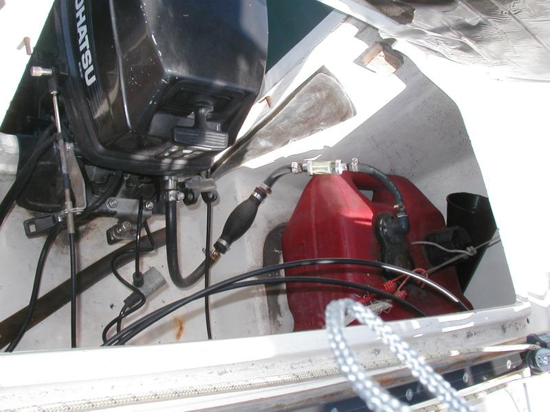

Until you find the optimal motor, the 5 HP can certainly get you out and back, plus it will tilt up into the well with no modifications. The larger motor will not.... the well was designed with the old Evenrude or Johnson sailmasters in mind.... they had a very low cowling profile.

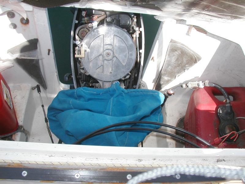

I leave my Tohatsu down, in neutral, when I'm daysailing.... with the remote and electric start it's just like having an inboard. When I'm done for the day, the motor will tilt up snugly into the well, but I must take off the cowling for it to fit, but then I put on a canvas cover for protection. Been doing it for 15 years that way, no harm to the motor, no noticable loss of speed... Of course, I'm in San Diego, not Utah. But the boat sits in salt water year round. No problems.
Modifying the transom opening to allow the motor to clear without removing the cowling could be a nice project for your scouts sometime down the road. I've seen some interesting solutions.... try google.... or you might call customer service at Catalina Yachts for their thoughts. Besides the opening, the access lid must be altered a bit... the back corner of the cowling will not allow it to close when the motor is tilted up.... I simply removed the hinges from the cover.... it sits up an inch or two... no big deal, because the motor still has the canvas cover.

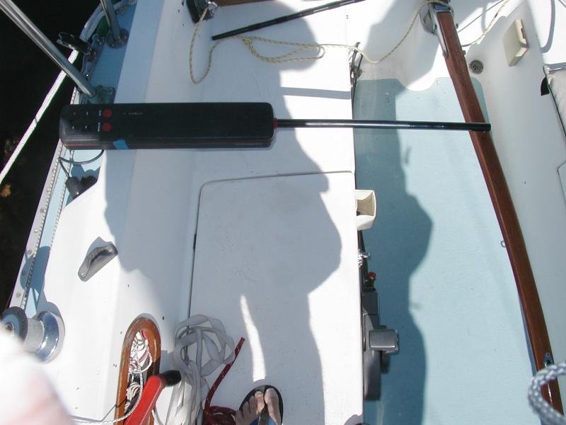

BTW I've attached a few pics that may be of interes...one of the traveller, a couple of the motor and one looking down in the cockpit showing tha tiller pilot and the location of the remote control box.

We've still not found boom so we cut a Hobie 14 mast down to size. Not ideal but It's free.
Here is the Frankenstein gooseneck we made. Again not idea but it's free.
