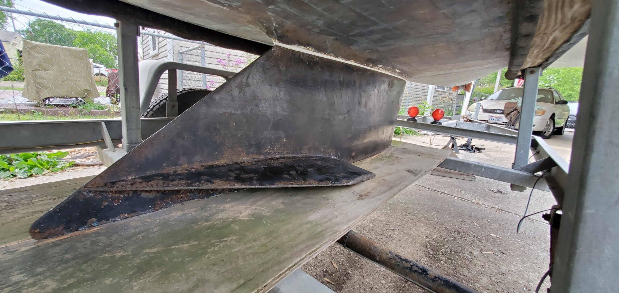

That rusty keel... Yeah. Took a cup brush (wire wheel) to it in an angle grinder and got all the flaky, rusty stuff off. Then gave it a couple treatments with Naval Jelly. Here it is after a good wire brushing:
Didn't grab a pic after the Naval Jelly treatments, but it turned the rusty spots grey, much like new cast iron should look.

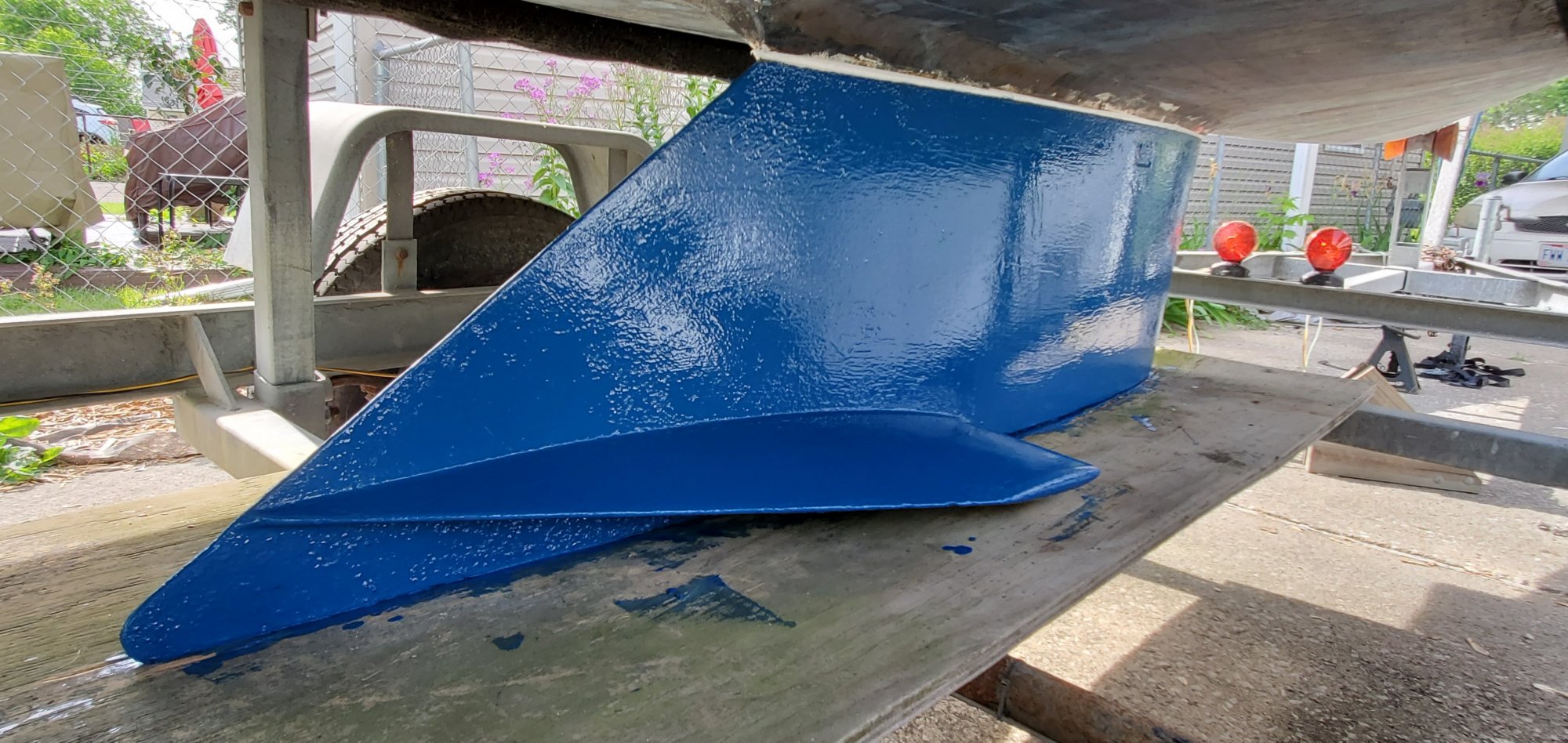

Today, I resealed the hull to keel joint with some 5200 and painted the keel with a couple coats of Royal Blue Rustoleum paint. Of course I couldn't do the very bottom and under the wings, as it's on the trailer, but hit everything as best I could with a couple good coats. May even hit it again this week weather permitting.
She's looking pretty good!

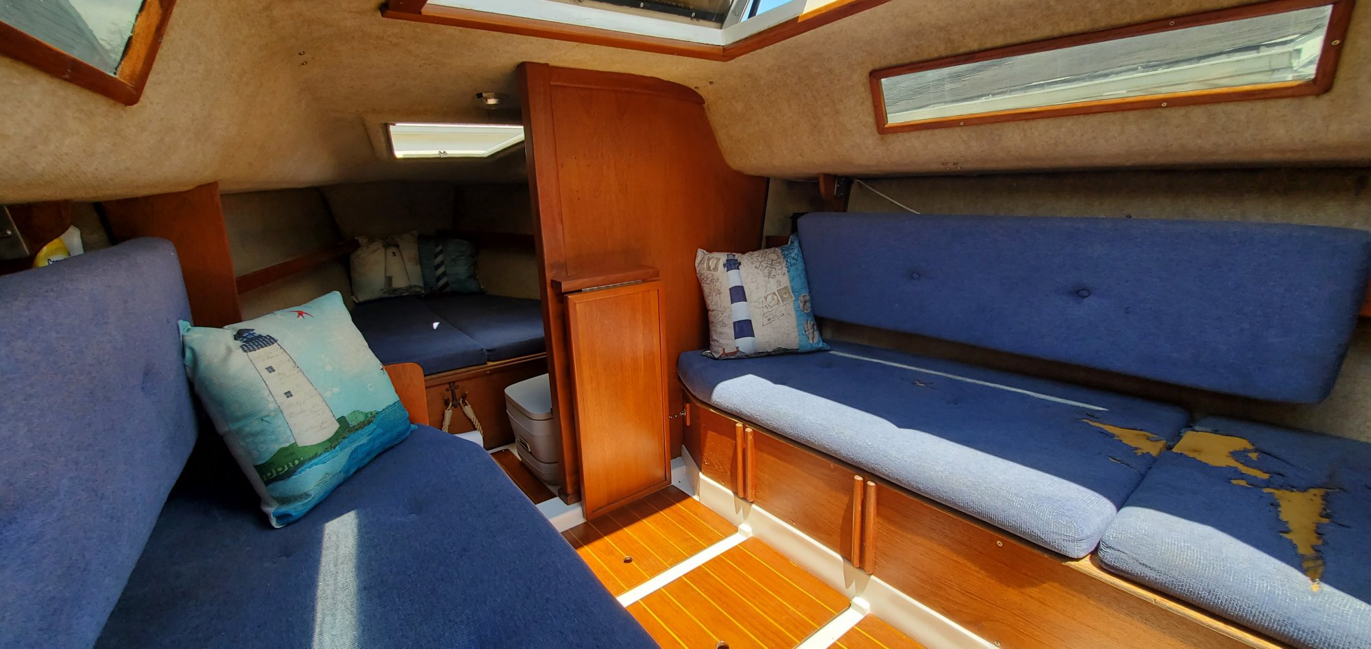

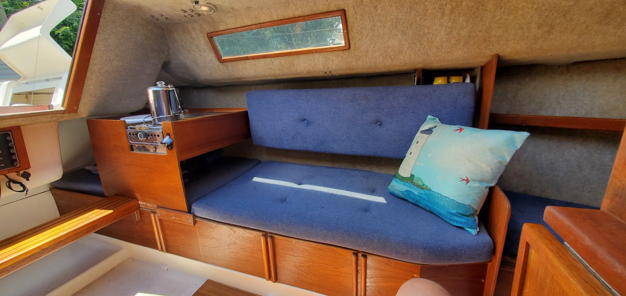

Ready to go sailing! Been a LOOONNNGGG day. Her interior is all cleaned up, new tires on, bearings greased, a good topside scrubbing, and about a thousand misc. things finished!
Still need to find a good upholstery person make some new soft goods, but can't let that hold up the fun!

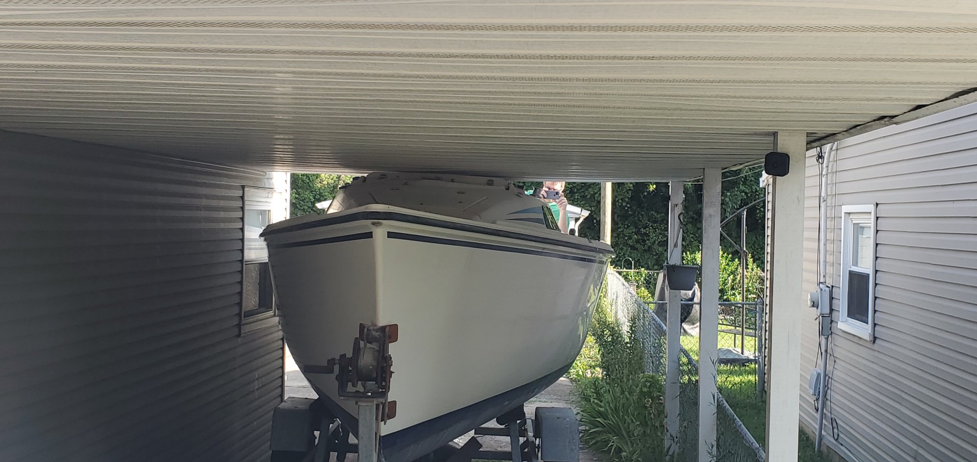

I pulled the boat under the carport and back by the shop back in January. Had to strip off ALL the topside hardware and flatten the tires to fit. Today was no exception pulling her out! 20 lbs of air in the new tires gives me about 1/2" clearance!
