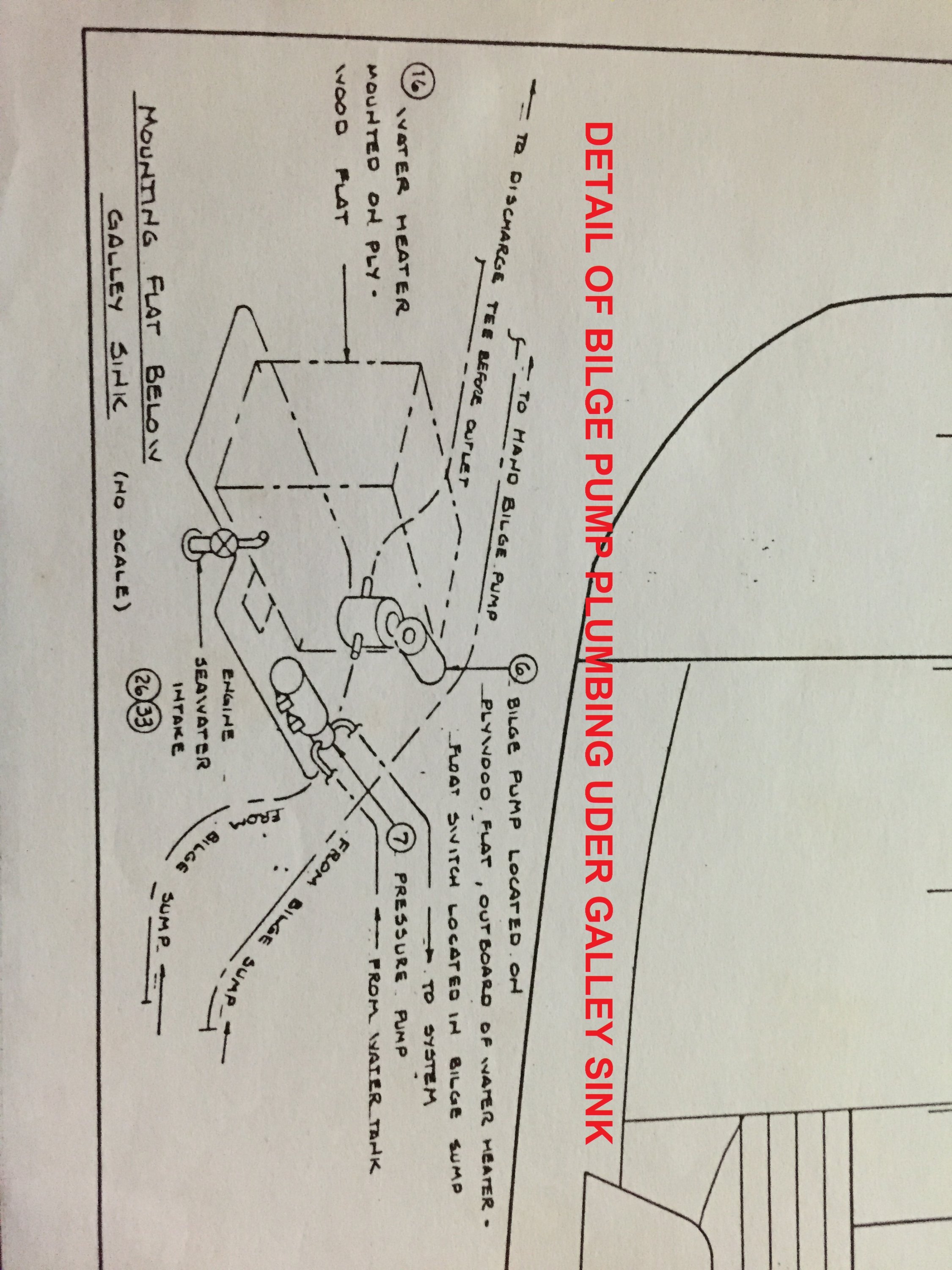

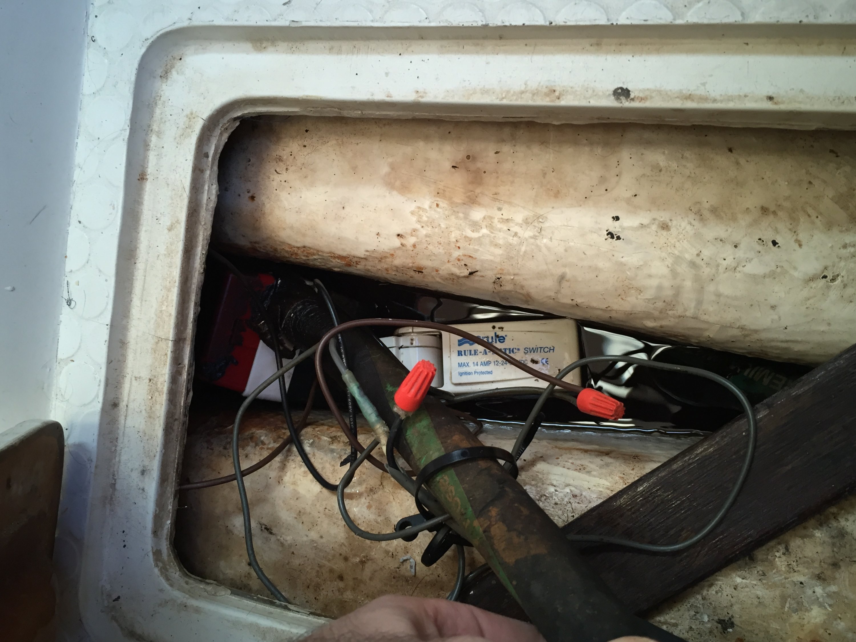

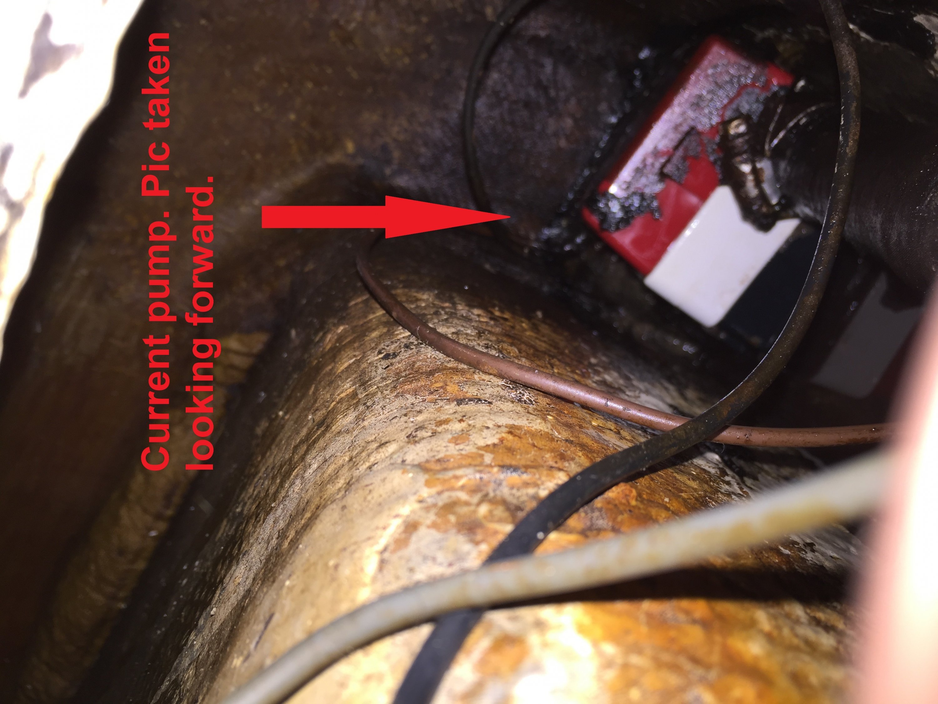

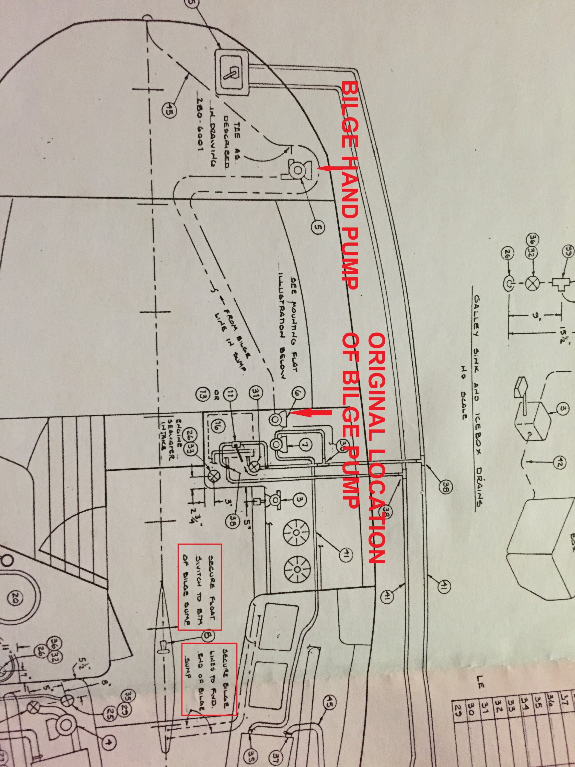

Not only is there oil in it (separate thread on that topic forthcoming), but it seems the PO (previous owner?) removed the original bilge pump and replaced it with the one in the picture. I'm not too happy with the wiring job, as I'm told those wire nuts have no place on a boat, especially in the bilge. The original factory configuration was a hose led to a remote pump under the galley sink, presumably because the hose could more easily access the bottom of what is a very narrow space down there.
I looked at reconfiguring to the original remote pump setup, but honestly, the space under the galley sink intimidates me a little. There is an unplumbed water heater and a bird's nest of other hoses in there. I can either look inside, or put my arm in there, but not both at the same time. Such is life on a 27 foot sailboat I guess.
