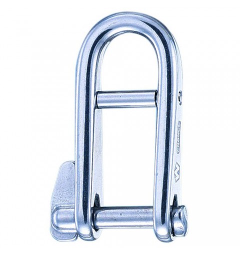

When you say the lines in the mast, I assume you mean the jib and main halyards (the ropes that raise the sails). These should have shackles (see pictures) on the ends to attach to the sails. The other end that you pull on should always have a knot to keep it from slipping away from you. Referred to as the bitter end!

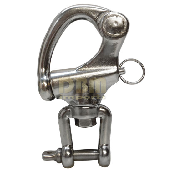

Theoretically the topping lift is supposed to go through the boom and I find that too much work. I have simply attached a snap shackle (see picture) to the end of the topping lift and snap it to the end of the boom. I now have a slightly different method so I can easily adjust the height for sailing, having the bimini out and to keep it from bopping me on the head! As stated above, you want some slack in the topping lift so it and the main sheet are not fighting each other. Once you get the mast switched around and all the lines and shrouds lined up on the boat, we'll want to help you get them sorted out and attached to the correct places. Then you will want to raise the mast at home the first time not at the marina. Then we'll have to get the mast set up correctly. This is time consuming but it does two things, it gets the boat in the best set up for sailing efficiently and helps to get you more familiar with the the way the boat works. I put it in the driveway in the most level spot and chock the wheels so it can't move, then I put my 4 foot level on the cabin top and level it fore and aft and then put a bottle jack under the low side to raise the trailer until the boat is level side to side and then check front to back. If you can do this while hooked to the hitch, that's great, but I have to take it off the hitch to make it level.
