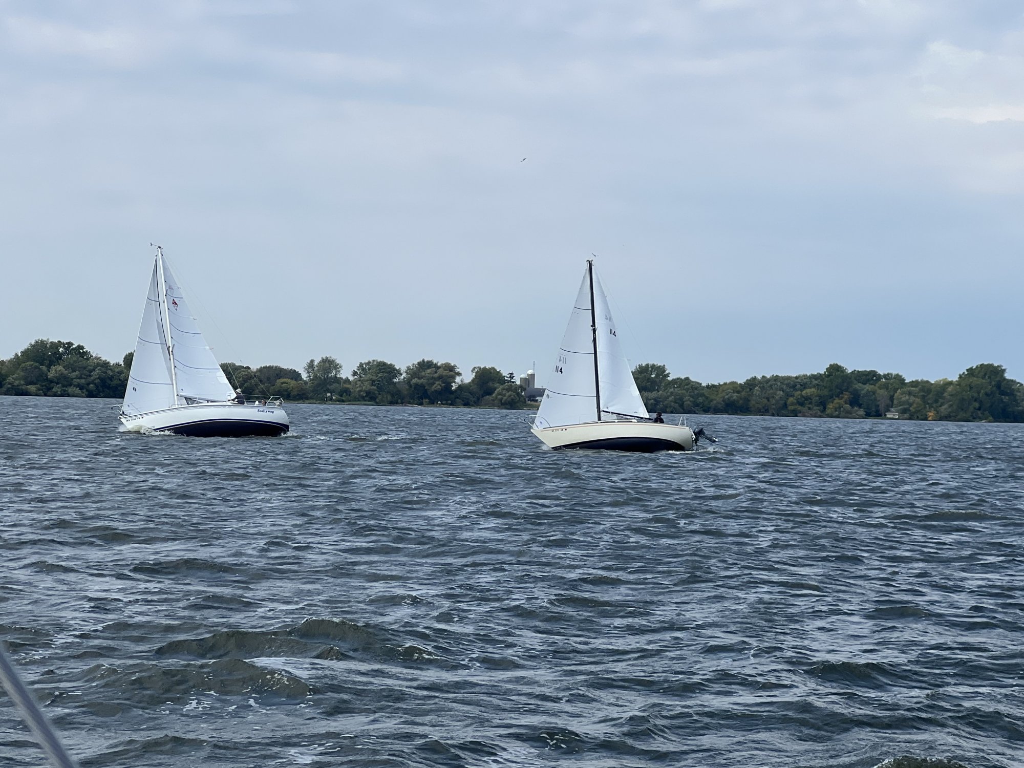

On the 24, we would "vang-sheet" in puffy conditions. We set the vang on hard (whatever was good for the current "normal" wind conditions) then use the mainsheet to dump the excess power in the puffs. The advantage of this is that having the vang on hard keeps the trim of the main in place while easing (dumping) the main would reduce the load and keep the boat on its feet. With the vang on hard, easing the mainsheet doesn't let the main twist off at the top. When the puff subsides, you pull the mainsheet back in and you are again trimmed for the upwind condition in the current "normal" wind conditions. Very often, the out and back in on the mainsheet was done over a relatively short period of time in a "blaster" puff, seconds, not minutes. Also, having the vang on hard keeps the main flatter because it incdces some mast bend.
I had something like this happen in a race Saturday. We started with winds12 gusting to 15. About 1/4 mile after another boat and I rounded the last leeward mark the wind shot up to 20 with gusts to 25.
The picture below was taken right after a gust. You can see we both have our mainsails eased-I’m in the rear boat and I had the vang down hard and the main sheet and traveler were both dumped.
The Catalina seemed to handle it better. I think the reasons are:
1. They are better sailors and do great in heavy wind.
2. They have a smaller jib (110, mine is a 135),
3. A Catalina 270 is a lot heavier than an S2 7.3.
They finished 3rd and I was a ways back in 4th.
