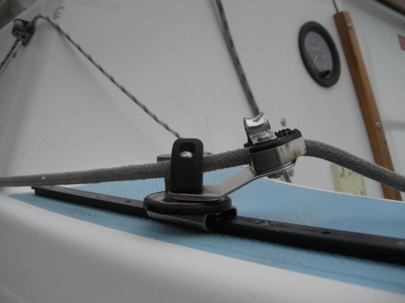

Here is what I used on the Mac 25. I worked well for me and I could control it from the windward side of the boat. I use to also be concerned about taking my 200 lbs to the lee side when severely heeled. I also seldom used the winch handle but with this set up it swivels and was available if needed from either side of the boat. I replace the 16" tracks with 24" tacks.
