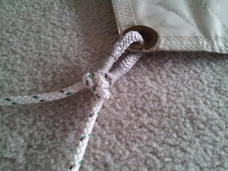

I have a cutter rig and bowlines will hang up, on the inner stay, at various times. I went to a single line with a cow hitch a few years back and it has worked out very well. It does cinch up very thigh by the end of the season and puts some stress on the cringle. I move it a few inches back and forth every season to spread the strain on the line. It makes a very clean connection of the sheets, Steve.

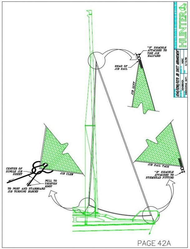

A cow hitch is prone to slipping. Probably not for small boats/small jibs, but bigger cruisers definitely can have issues. I recall a blue water cruiser who related how his jib sheets did slip about a foot during a crossing from Hawaii to California. The Butterfly knot would likely not slip at all. That Hunter knot looks interesting. I may try and rig one of those this summer and see what I think. I have seen a knot that looks essentially like a clove hitch around the cringle, but when I tried to tie one, it didn't sit well, didn't sit the way I thought it ought to, so I went back to a cow hitch, which works fine for my little 60 sq ft jib. Of course, the type of line that you use for sheets can have a big impact on knot slipping...
