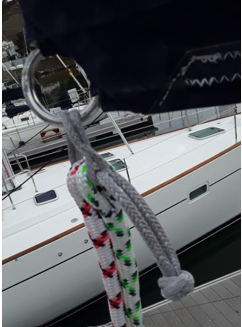

Nov 7, 2011
3,842
Looks good but the shackle needs to be tightened.
I've used a single line with cow hitch tie to the clew for since I started sailing 8 or 9 years ago. Never had an issue untying and removing the jib sheet at the end of the season. Of course our season here in the NE is only about 6 months long, that may make a difference.
Plan to try a soft shackle for the sheet attachment next spring.
@jssailem was very patient teaching me how to make soft shackles last winter. Made about a dozen of various sizes for various uses.

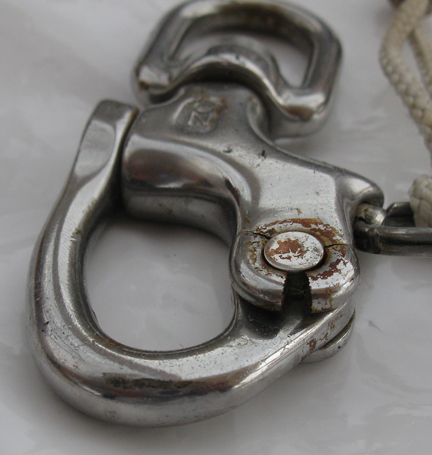

When I was new to sailing, the convenience of the snap shackle was all the rage.
They still are a useful tool on a boat. They do need to be inspected. Some are better than others in material and design. If yours looks like this one it is time to replace.
