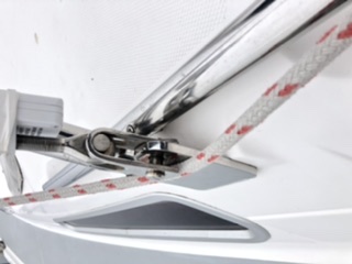

Does anyone have a solution for the jib sheet catching at the bottom of the inboard shroud where the shroud fitting pins to the deck SS plate? See photo.

You could wrap it. Maybe with some amalgamating tape or electric tape.
JRacer
Aug 9, 2011
1,407
Short piece of PVC pipe with a large enough inside diameter to fit over the chainplate perhaps.
JRacer
Aug 9, 2011
1,407
What if you cut the tube so that it was a half pipe below the chrome strip and a full pipe above? Then the half pipe would extend down to cover the chainplate and the full tube could rest on the deck above the chrome piece.
JRacer
Aug 9, 2011
1,407
Or, is there any gap between the shroud/chainplate and that chrome strip? If so, you could use a smaller diameter PVC pipe, large enough to cover the shroud and its turnbuckle and cut a slot in its bottom end in a width sufficient to slip over the chanplate.

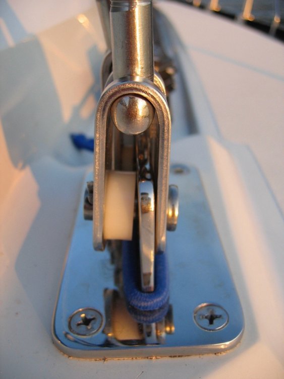

A crazy idea might be to fab a "plastic" washer with a center hole the size of the clevis pin, the thickness of the opening, and a diameter the would extend to the mouth of the U-shaped fitting. In theory the washer should fill the gap and spin with the sheet. Just a theory

JSG's and Justin_NA's spacer is the best solution. Regular SS washers would work also.
