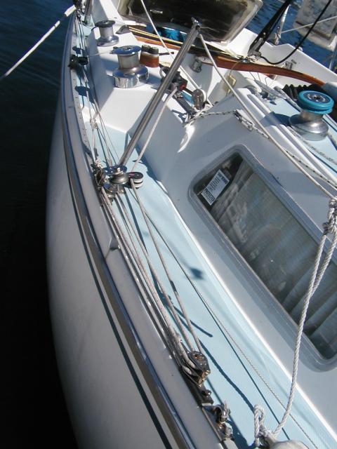

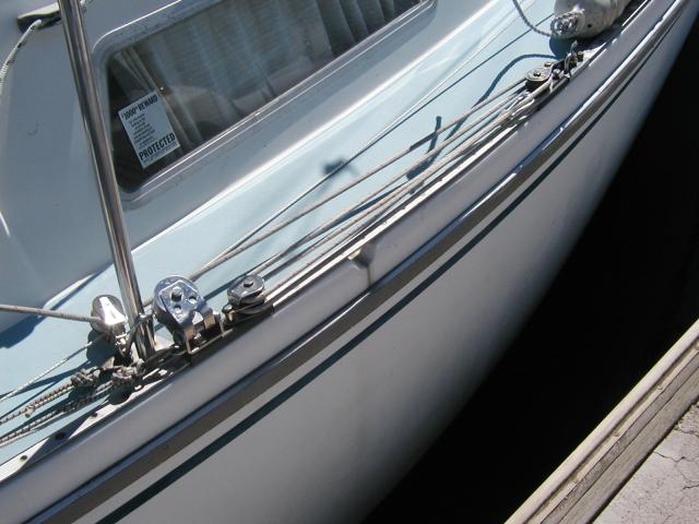

It's time to replace the old blocks on snap shackles I use for my jib sheets and I'm going to try to order from the SBO store. Anyone have opinions on the best ones for a 32 foot boat with a 125% Genoa?
Specific question: My sheer stripe is dinged up from the blocks flopping over the toe rail (full length aluminum with holes). I've seen becket blocks used for jib sheets with a shock cord between the becket and the lower lifeline to hold the block up. Anybody have any experience pro or con with this arrangement?

If you're going to use regular snatch blocks attached to the toe rail instead of upgrading to a line-controlled genoa car/track system, then an easy way to prevent the blocks from flopping over is to cut about a third of a tennis ball off...then cut an "X" into the center of the remaining piece and put the block through the "X" and attach it to the toe rail. The tennis ball remnant will act to hold the block upright and prevent it from flopping. :)

It's a fine idea an quite consistent with the way I do a lot of other thing on a boat where there is little pretense. However, the balls would interfer with shifting the leads because they go around the snap shackles.
Garhaeur blocks with a loop of shock cord through them up around the lower lifeline sounds like the best way to go for my particular set up and wallet.
