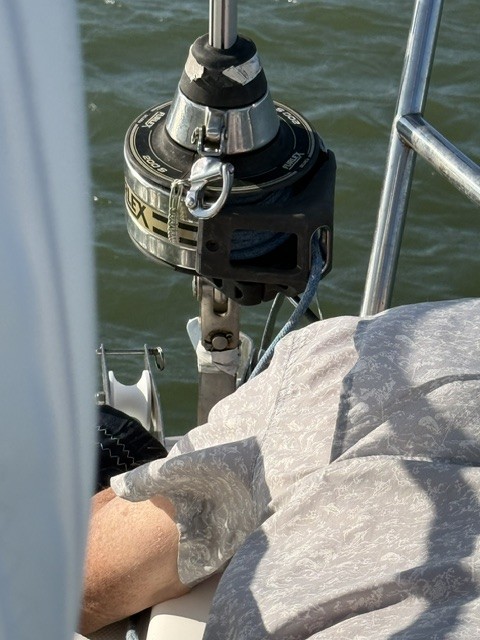

Hi,
I have 2011 Hunter 39 with occasional problems when furling the jib. I have had to partially dismantle the Seldon Furlex at the jib base to untangle the line. A new line improved the issue but it still occasionally binds. Likewise with the jib halyard swivel, solved for a while by spraying the bearings with silicone.
I am considering replacing both items, but would like to get upgraded or better ones. I would be very grateful for any recommendations.

Have you talked to Selden in SC about the problem? I have a Selden 200 on my First 310 and have not had any issues. Is the angle the line enters the furler at the proper angle? Same question about the angle of the halyard. How old is the furler? Just some thoughts.
14,302
One of the causes of jams in the furling drum is letting the jib unfurl too quickly which leads to overrides and loose wraps. Then when furling the line binds up and over rides form. The solution is to maintain some tension on the furling line when deploying the jib and to maintain some tension on a jib sheet when furling. This will help the line to wrap neatly in the drum.
Also check the lead of the furling line from the first block to the drum, it should be a right angle.

Jracer, Angles of the line and halyard are correct. The Seldon is original (2011)
ciochner: Angle from the drum to the drum is 90 degrees. I maintain mild tensions on the furling line when deploying the jib, and on a jib sheet when furling. Age of the furling is most likely a factor.
