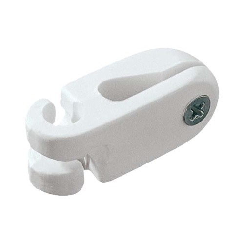

So. I removed it and decided to get some hanks soon and install them. They're this type, because my budget is very limited:
Aaaaand that's a really big picture, but. Oh well. Anyway, I've got a pretty good idea on the layout and measurements and everything, but I don't know how to properly attach them to the luff. Any help would be awesome!

With a screwdriver. :biggrin:
The the screw out slide the hank on, poke a hole for the screw to go through and then tighten it down.

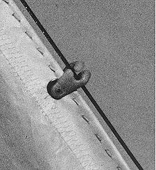

I have had a lot of small boats and every one with hanks (even the twist on kind) had small grommets in the luff. The AMF Sunbird I owned came with standard brass piston hanks and grommets in the head sail.
This just looks like an accident waiting to happen. But as they say your boat your choice:biggrin:

I agree with "your boat, your choice" ... but that bottom photo from LakeShark looks pretty secure to me for a small sail. The flat surface of the hank where the screw secures it seems like a pretty secure clamp over the sail material (and mitigates the stress around the hole). It would seem to me that a grommet would introduce a little slop that doesn't need to be there and might even allow the hank to fail from fatigue if the screw diameter doesn't match the inside diameter of the grommet exactly. I guess I'm in agreement with Dave.

Think about the forces on the sail luff, there is a vertical force from the halyard and a horizontal force from the sail. The bolt rope and the luff tape carry the load. The bolt rope is typically a low stretch line, like braided dacron attached to a piece of very heavy dacron. The rope is in the middle and the tape forms 2 flaps which encase the forward end of the sail cloth. There are usually several rows of stitching to secure it to the sailcloth. That tape distributes the horizontal load on the sail.
Consider 3 ways to attach the sail to the boat, a luff foil, piston hanks, and the hanks you have.
The luff foil allows the horizontal loads to be transmitted to the forestay along the whole length of the sail by capturing the bolt rope.
A piston hank transmits the load from the sail through the hank to the forestay. The weak point is the attachment to the sail. A grommet is necessary for several reasons, to locate the hank, reduce chafe and wear at the attachment point and to distribute the load over a larger diameter hole in the sail cloth. Sailcloth is relatively flexible, if the hank relies on the cloth alone to transmit the load, the hole in the cloth will elongate causing the stresses to point load on the small diameter hank. This will weaken the sailcloth and tear the sail. A grommet spreads the load across a larger diameter hole thus reducing the point loading and the metal reduces chafe.
Think of your hanks as a segmented foil. The hank is constructed so that the load of the sail is transmitted directly from the bolt rope to the forestay, just like a foil. On a smaller sail you can get away with the small plastic hanks because the loads are relatively small. The screw is there to provide clamping pressure to keep the hank in place and reduce chafe from any movement. Some of the forces may be distributed by the clamping pressure, but most of the forces will be dealt by the hank at the bolt rope.
Make sense?

Plastic screw-on hanks of that type are used for dinghy sails. They come in two sizes. They are frequently used for 1/8” diameter wire forestays. they are also,available for 3/16. they should be fine for a 16 ft Sunbird or lightweight dinghy or daysailer. I would not recommend their use on a sail for a keelboat.
They are not as reliable or strong as piston hanks, so I would not use them in winds over 15 mph. They also have an annoying tendency to twist off the forestay when you drop the jib.
