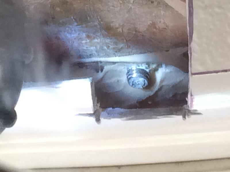

The screws that hold the track down are NOT secured by bolts and washers on the underside of the deck. They are simply screwed right into the deck. I did the most uncomfortable thing of taking a dremel to an inconspicuous spot in the head and cut into the liner to expose exactly what was going on beneath the genoa track and exactly how the track was secured to the deck (
picture attached). This is how I verified that it is simply screwed right into the deck.
I used my air compressor impact gun and removed all of the screws and removed the track. Once this was removed, it was very apparent that this is where the leak was coming from. What a poor system!!

The hunter tech support told me once that if you did not see nuts on the track bolts on the underside, or the underside was inaccessible without cutting an inspection hole in the hard headliner, then the track was bolted to an embedded aluminum plate that was sandwiched in the glass. The plate was tapped for something like 1/4-20 machine screws. I would bet that is what you have, otherwise it probably would have pulled through long ago. I found this to be true on our h30.

I have to admit, I was very concerned that the bolt was just through the fibreglass and was expecting to see a metal plate with washer on the underside.
However; in looking at what would be required to put one in (i.e. taking the dremel tool to destroy the entire interior heading) I decided to place my faith in the Hunter Engineers as after all, the genoa track wasn't pulled out of its mooring in the deck and it wasn't an issue up until now (over 20 years).
Your post has put my mind at ease and hopefully RJM will be able to affect a quick and easy repair.
