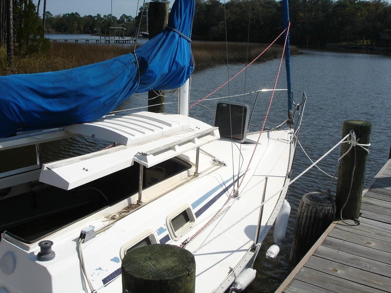

After searching the images online of my boat I came across one that shows the job track. The wood is there but no track/car. The wood is in rough shape so looks like I need to replace it and install a new track/car assembly. Pics to come of the current config but here is what I found online that appears to be what I am missing.

If I am understanding this correct the following picture would be the correct way to run the lines

That photo illustrates the method for screwing up a tack and removing a forward hatch cover! :yikes:

Ha ha I was more referring to the leeward side of the configuration. This isn't mine, just a random picture I found on the internet.

This configuration is very similar to what I see on my boat now. No track and/or cars.
I've done that often enough to find that it DOES screw up the tack, but I've yet to find any damage to the hatch cover. It DOES result in a very wet interior when not paying attention to the building conditions. :doh:

Your first picture is correct.
That 2nd one is very bad. If Hunter shipped that boat like that (sans track) they should be ashamed.

The more I have looked around and asked others with these boats, the more I am finding what I believe is that Hunter did not have tracks and the second picture is how they came. I found a guy local to here that has the same boat with tracks and I am going to go take a look at it sometime in the next couple weeks.
