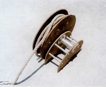

Centerboard_Winch_Front.jpg $(KGrHqF,!l0E6B0qR)twBOk4U9i5N!~~60_3.jpg 1967 CB-1.jpg Mast step 2.jpg John, it sounds like something is wrong, butI'm not sure what. Those pins shouldn't stick out as far as I can tell. Here is a pic of what I assume your CB winch looks like?

Thanks for the reply. I think it's warped a little, that's why it's hitting. Today I drilled and tapped a new hole a little further out so that the spindle now sits about an 1/8 away and doesn't hit anymore.
