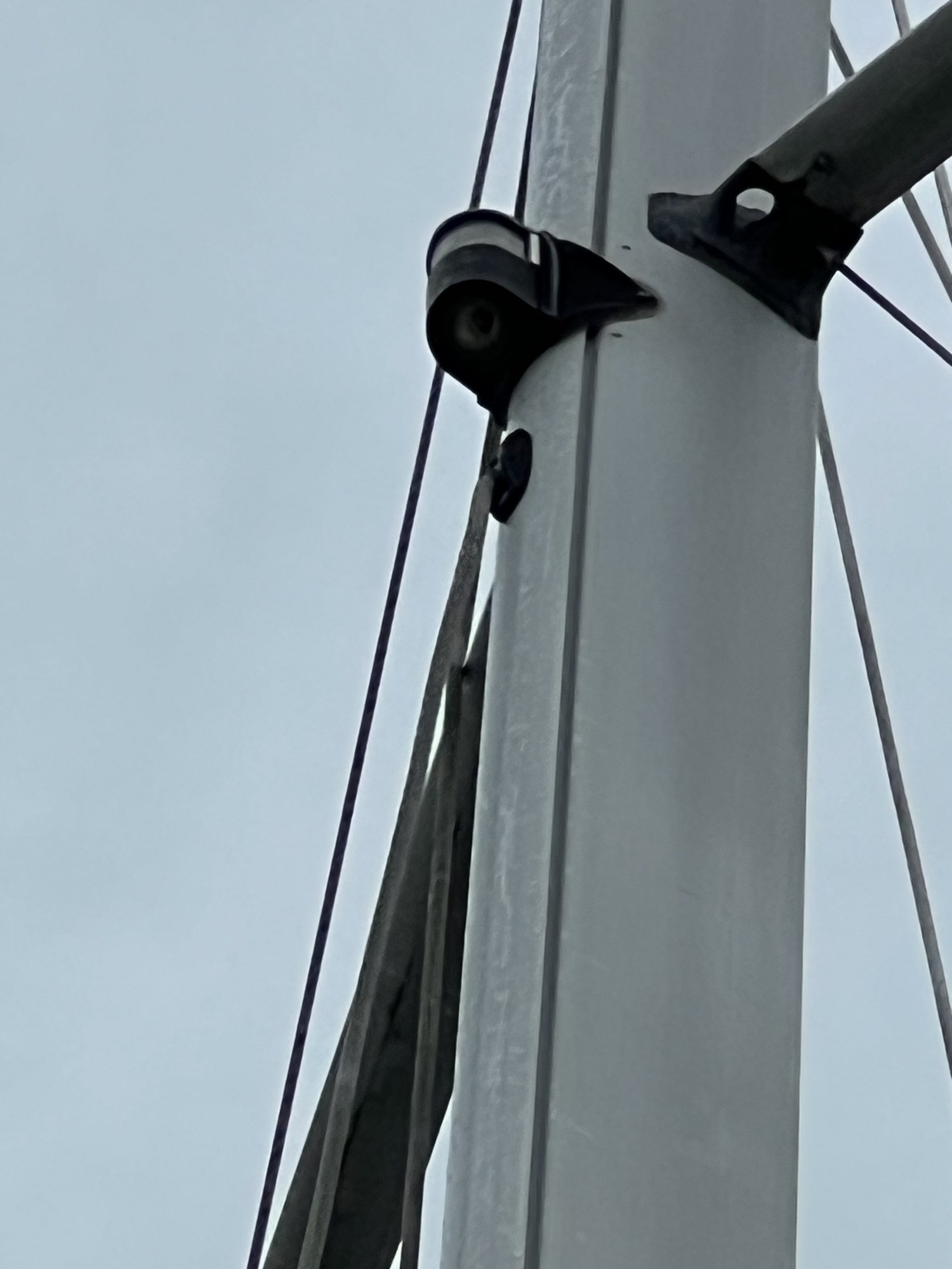

I was hoisting my Dinghy on the fore deck using the pole topping lift as my attachment point, and the pole topping lift is now somehow jammed it seems at the block up the mast. I can neither get it to out or come in. Has anybody experienced this before? I’m not sure what to do. The load was at a slightly outboard angle from the topping lift block, so it’s possible that it jammed in the sheave up there. I have only tugged on it (hard) by hand. I suppose I could try using a winch on the outgoing side.

It all depends on how the jam was made. It could be the sheave or the line frayed between the sheave and the mast. Until you can see the jam, it is all a SWAG.

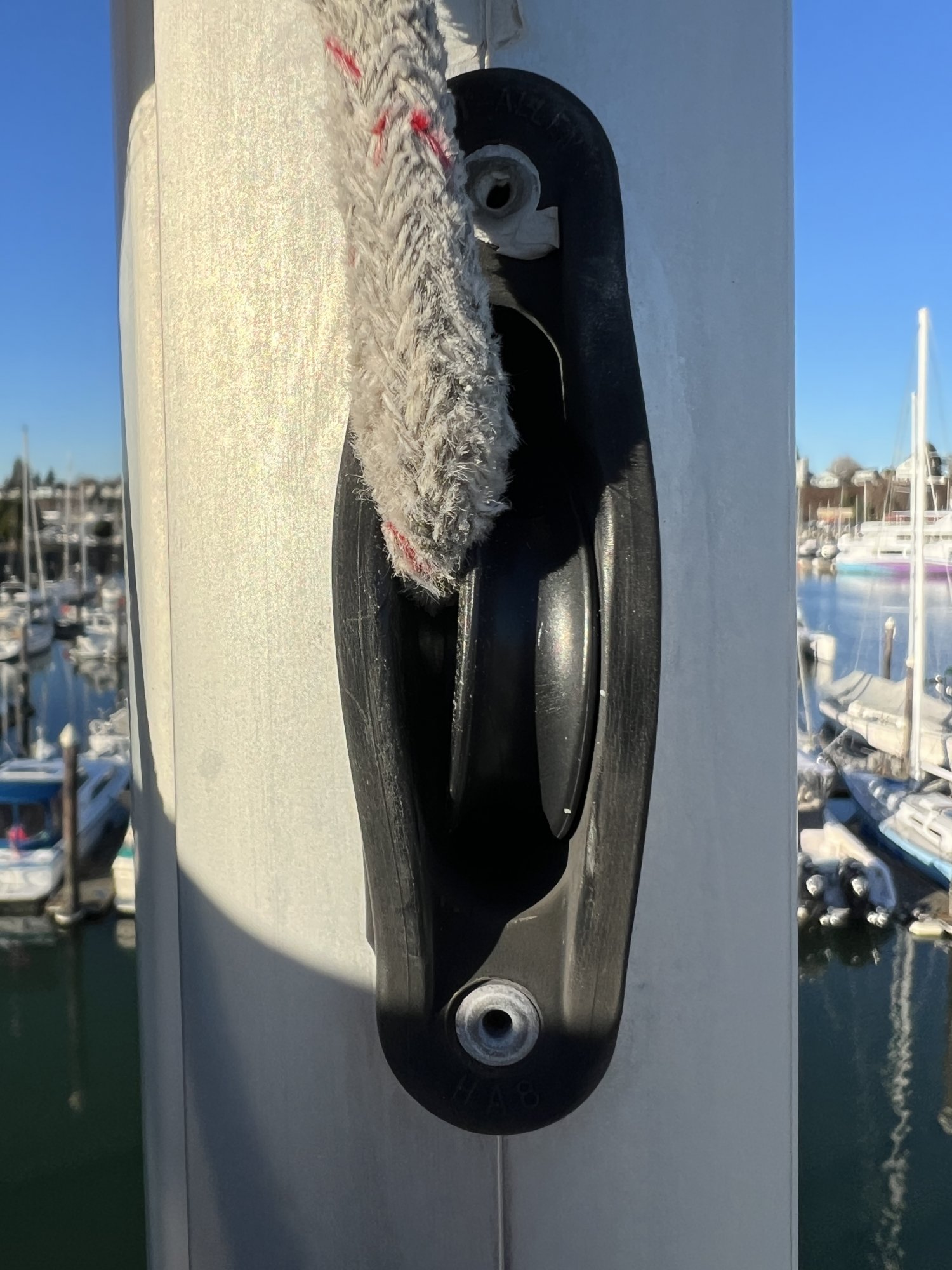

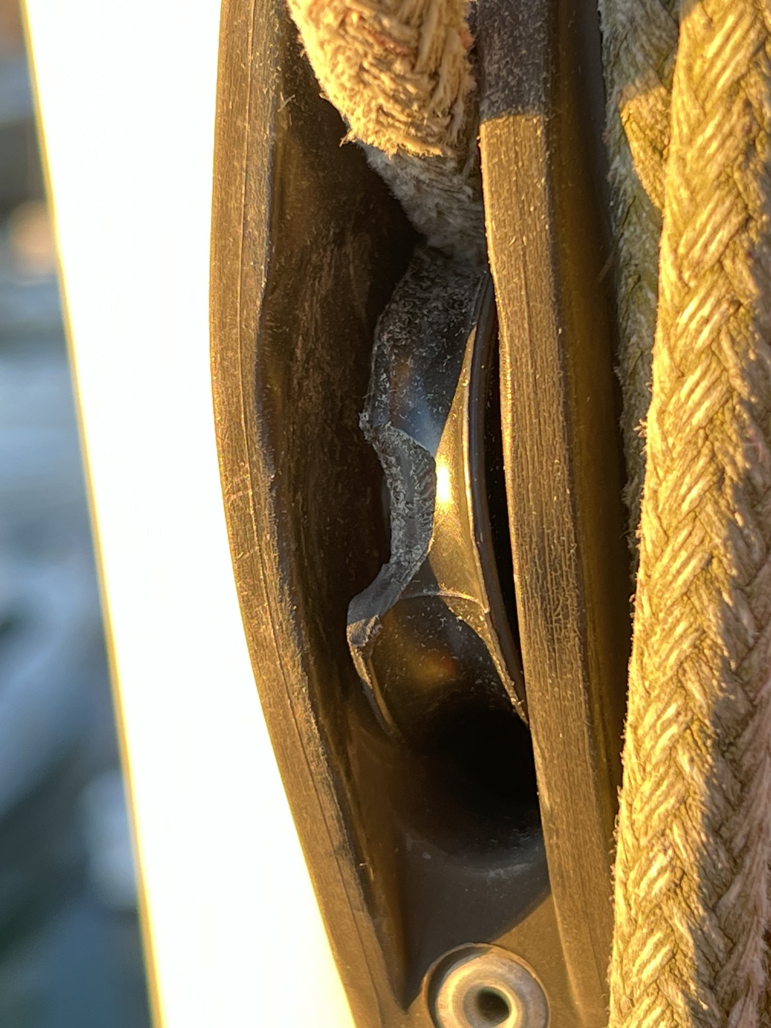

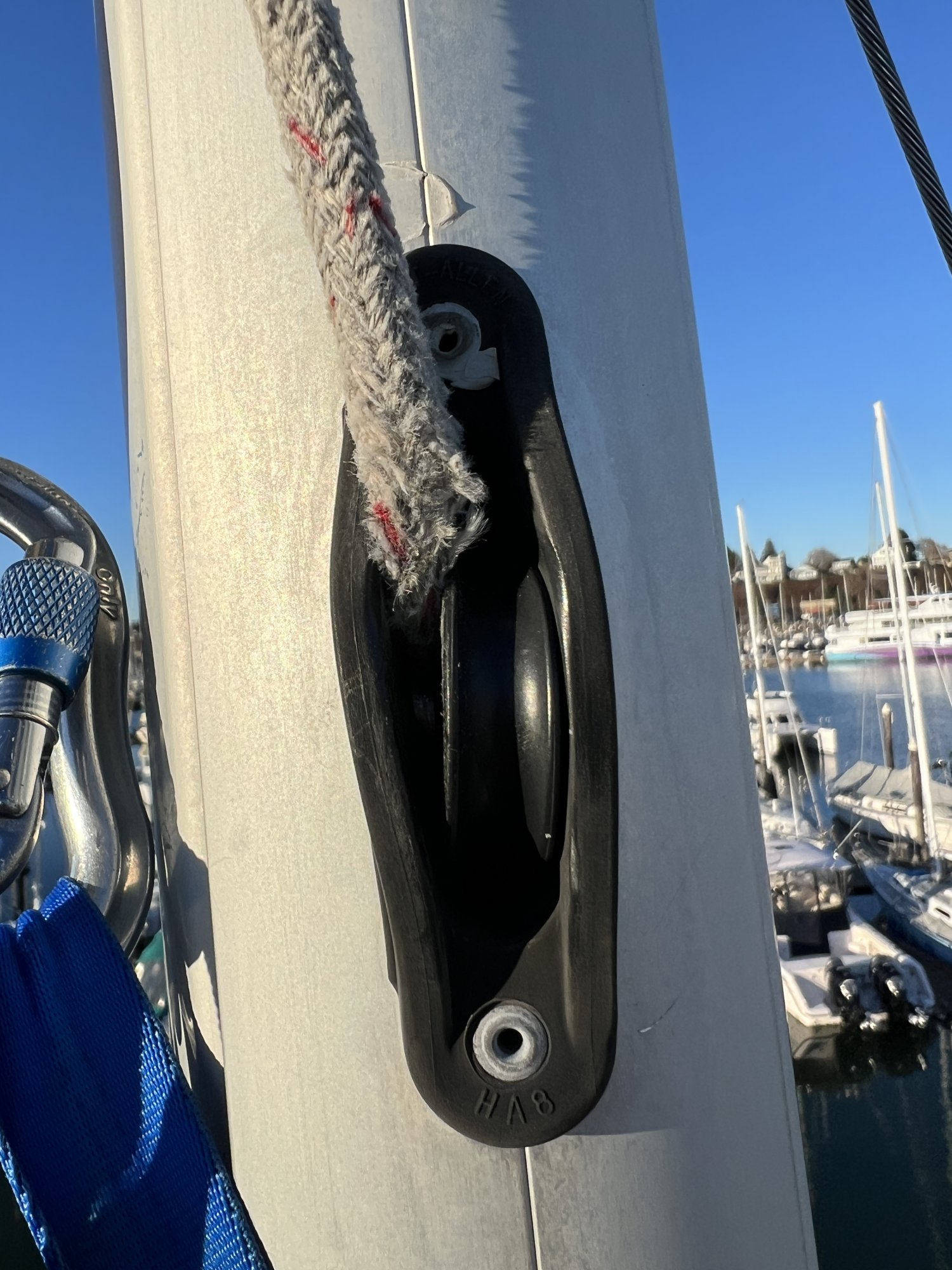

Well, I got up the mast, attached the spin halyard to the pole topping lift and pulled it upward with massive tension on the line while yanking out on it like a bow. Eventually, after many expletives, it came free! Unfortunately the sheave is now chewed up and I need to replace the insert. Any suggestions there? I suppose I just drill out the rivets and insert a replacement - I’ll plan to go back up with a drill.

The unit is called an exit block. The reason you got into the problem is that the exit block sheave appears to be plastic and the line is too big for the sheave.
Yes you drill out the rivets. I would get a good exit block with sheave and match the line size properly to the sheave.
Something like the Harken 30 mm Protexit Exit Block - Single, 8 mm (5/16") Max. Line for example.

From your pics It looks like the sheave itself also cracked.
You might be lucky that it happened while hoisting the dinghy and not a sail stuck up in the air?
As others said, you will need to replace the entire assembly.
