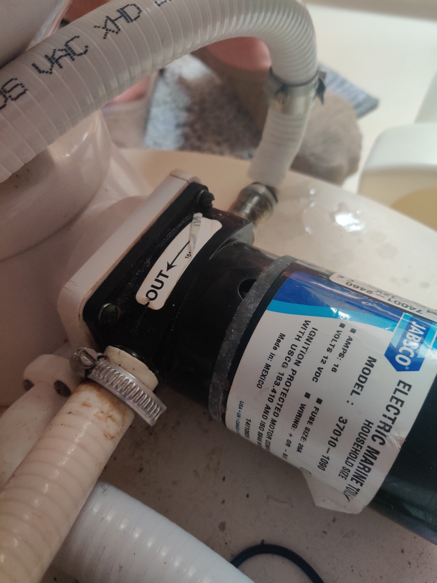

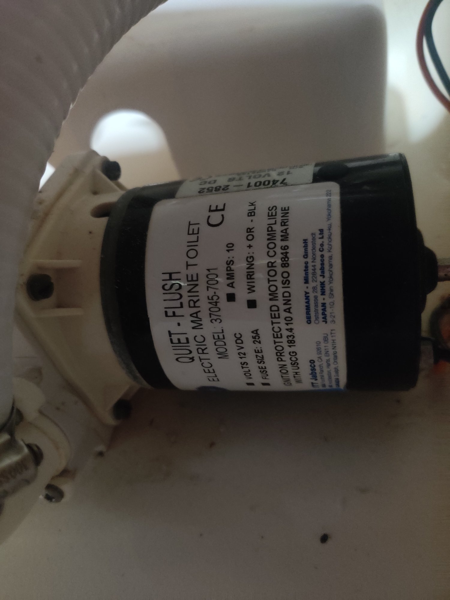

I have a 2005 Hunter 41 DS. My forward head has a Jabsco macerator #37045-7001, my aft head has a Jabsco #37010-1090. My forward head has a discharge to the waste tank and fresh water in to the head, that's it, simple and works fine.
My aft head has on the macerator a discharge to the waste tank, fresh water in, water out to the head. I think this is the wrong macerator. Fresh water will only go to the bowl when the macerator runs. So the water only doesn't work.
I did find behind the panel a capped off water line and when I connected it to the bowl everything works as it should.
If I just capped off the water in and water out on the macerator, would I burn it up? Should I loop it together? Should I buy another macerator to match the forward head?

Your aft head 37010 is a sea water toilet that should have a combined pump/motor assembly that simultaneously pulls flush water in via a below waterline and discharges bowl contents. It's not designed to us pressurized flush water and should never be connected to any fresh water plumbing . The exploded drawing and parts list in the owners manual Jabsco 37010 owners manual shows all the parts and where they should be installed. Your forward 37045 is available as either a fresh water or sea water toilet...no way to know which one yours was originally...this owners manual shows it as the fresh water version Jabsco 37045_series.pdf owner manual.
So it appears to me that a previous owner decided to turn your aft head into a fresh water toilet, so I suspect the solution is to replace the macerator pump he installed with the correct pump/motor assembly for the Jabsco 37010. It's available from zillion marine retailers, price varies widely, so shop for it. If you need more help, Jabsco's toilet guru is Paul Campagna. His direct line is 978.282.5246 and his email address is Paul.campagna@xyleminc.com
