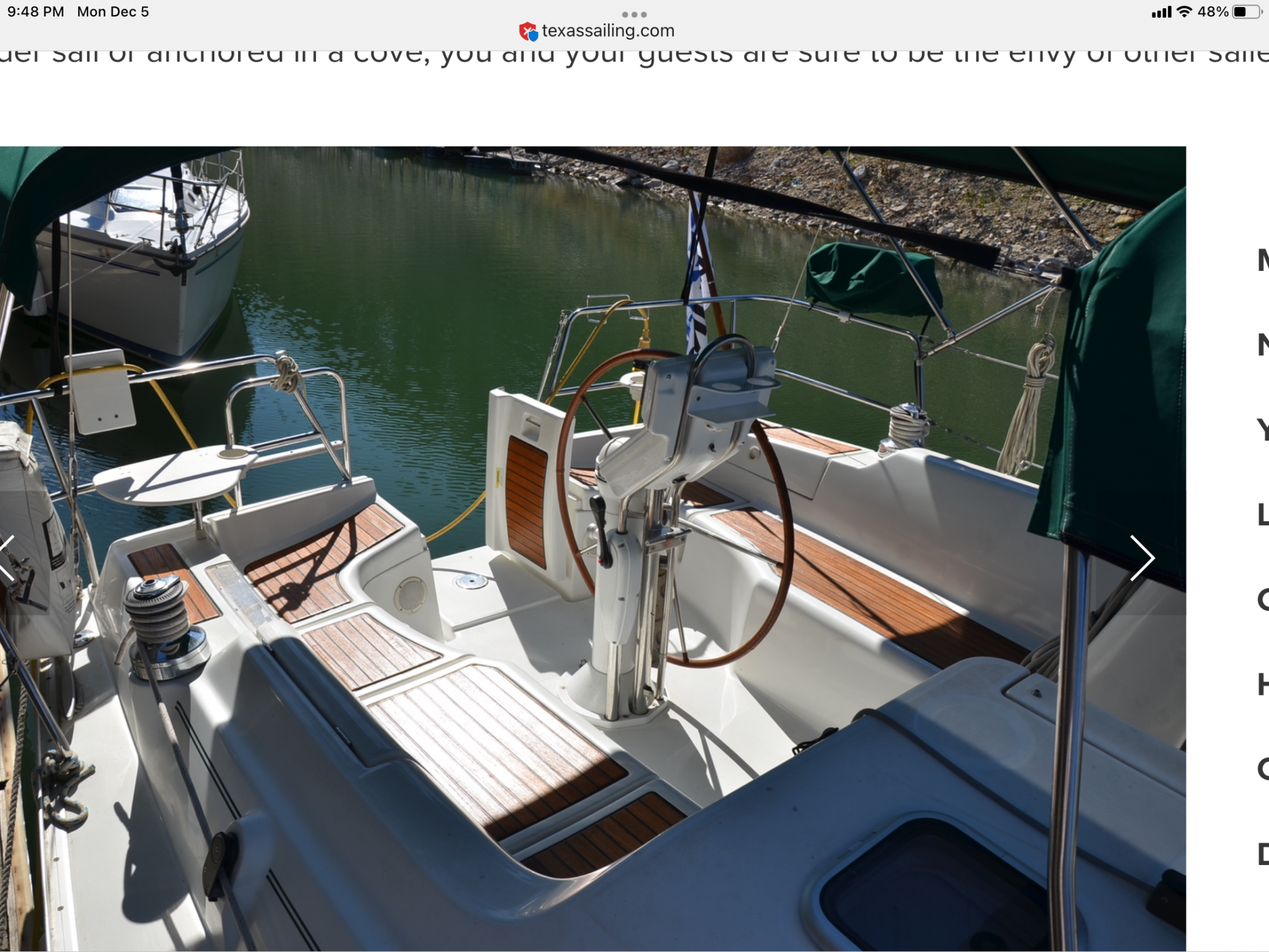

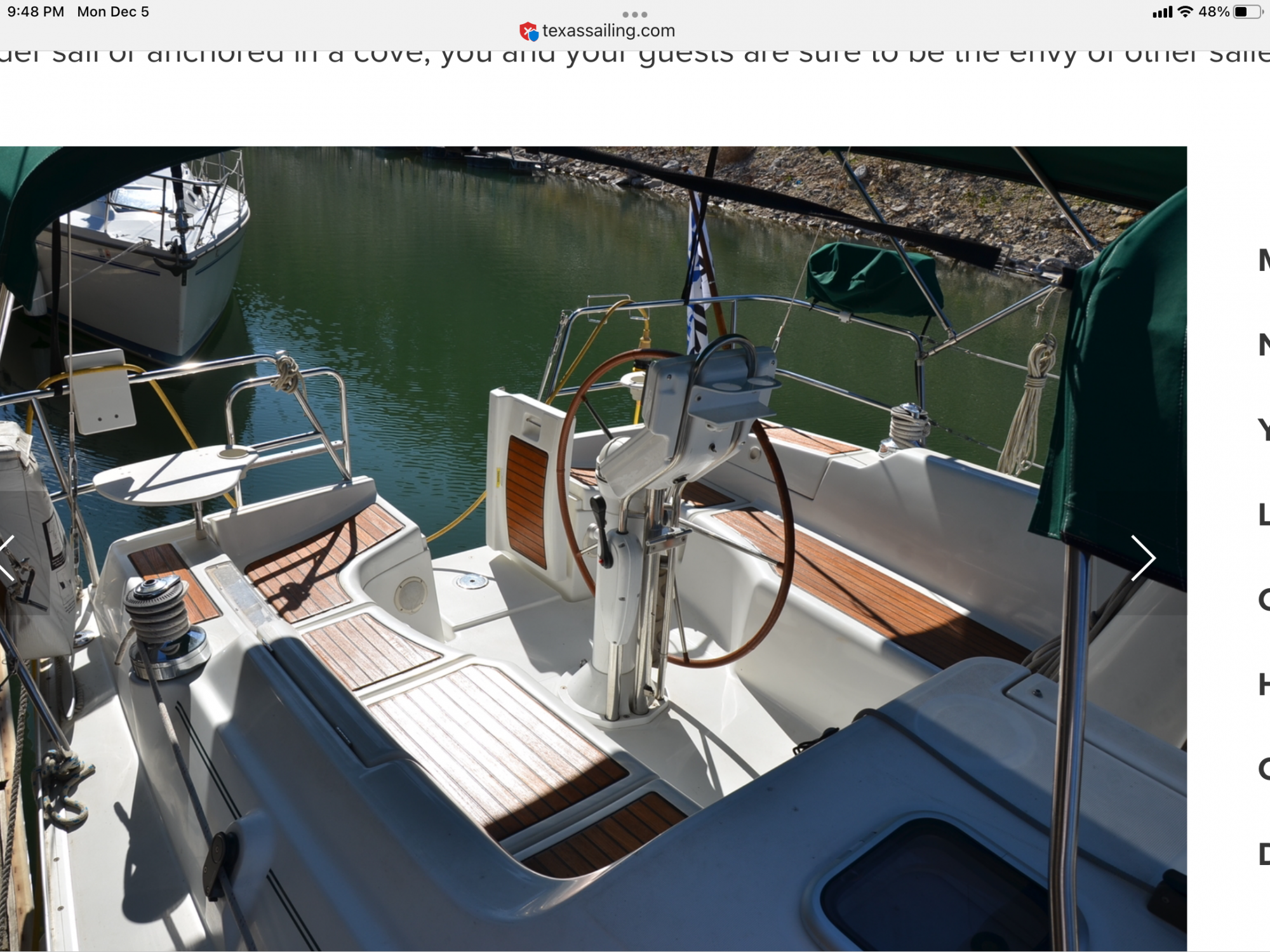

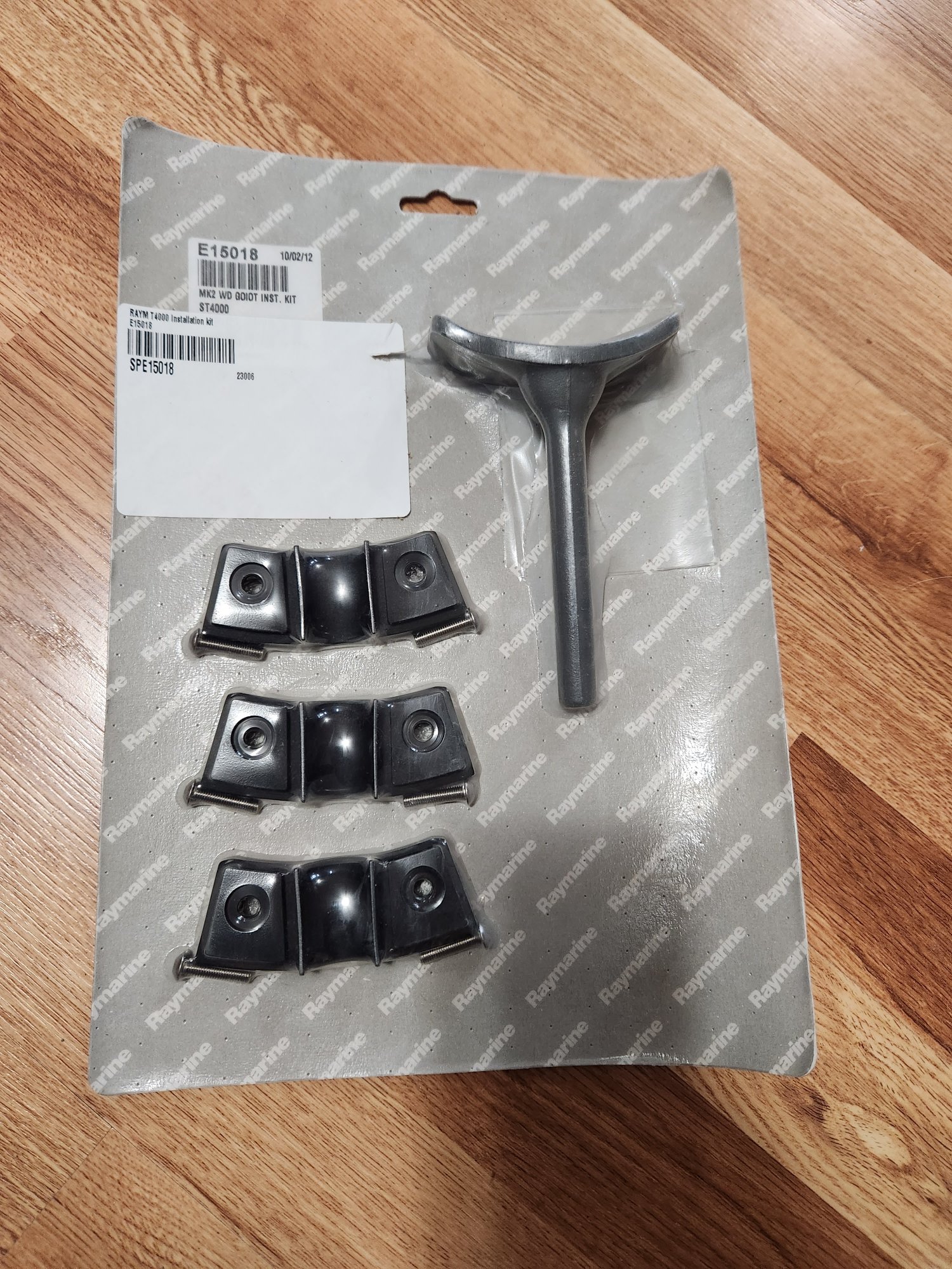

It's never easy. Autopilot install.
Jul 23, 2009
919
If have no idea about a pivoting wheel pedestal. If I have one it's news to me. The previous owner knew nothing about the boat, he couldn't explain how to operate any of the equipment. I never saw it out of the slip in over 5 years.
Several people mentioned that I will have to cut the pin down, of course I will. No need to cut this pin if I'm not going to use it though.

I would reach out to Ray Marine first. This can’t be the first time someone has encountered these issues. They’ll likely have a solution: be it alternate parts, adapters, or some kind of work around.
I started to do just that but I got interrupted. I got a phone call from a guy that I have been helping at the marina needed some help with his boat, that gave me the opportunity to measure my wheel spokes and look for a manufacture sticker on my pedestal. I also got paid for my time, win-win.

Here is a photo of the pivoting wheel on the 373…
I don’t know who makes the pedestal…but I do not believe you can put a wheel pilot drive on it (if you intend to pivot the wheel…
23,851
I believe that to be true. The Raymarine Wheel drive needs to have a fixed point to hold the back of the Wheel drive in place while the helm wheel rotated.
The other wheel drive options use a motor and belt system the fixes the motor to the deck. I do not believe it will allow a helm wheel rotation without removing the belt. Out of the box idea perhaps building a base that rotates with the helm wheel might be possible it would be a complex design.

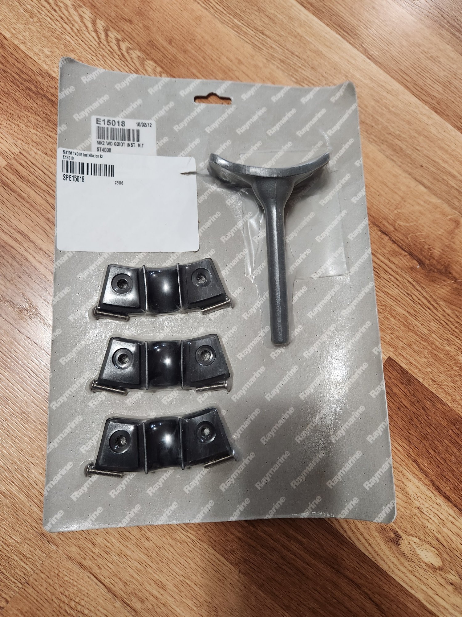

Syclone,
I have attached a rough drawing of the custom bracket that Beneteau fabricated for the 3_3 boat series that used a wheel pilot. Others have said that Beneteau no longer has the bracket in stock: however, they may be able to supply a more exact drawing to enable you to have one fabricated.
That's interesting. I don't see how that would work in my application. I am 99% confident that my pedestal/wheel does not pivot. The standard torque restraint will work with only an adjustment to the pipe diameter it's designed to fit. Finding the part is now the challenge.

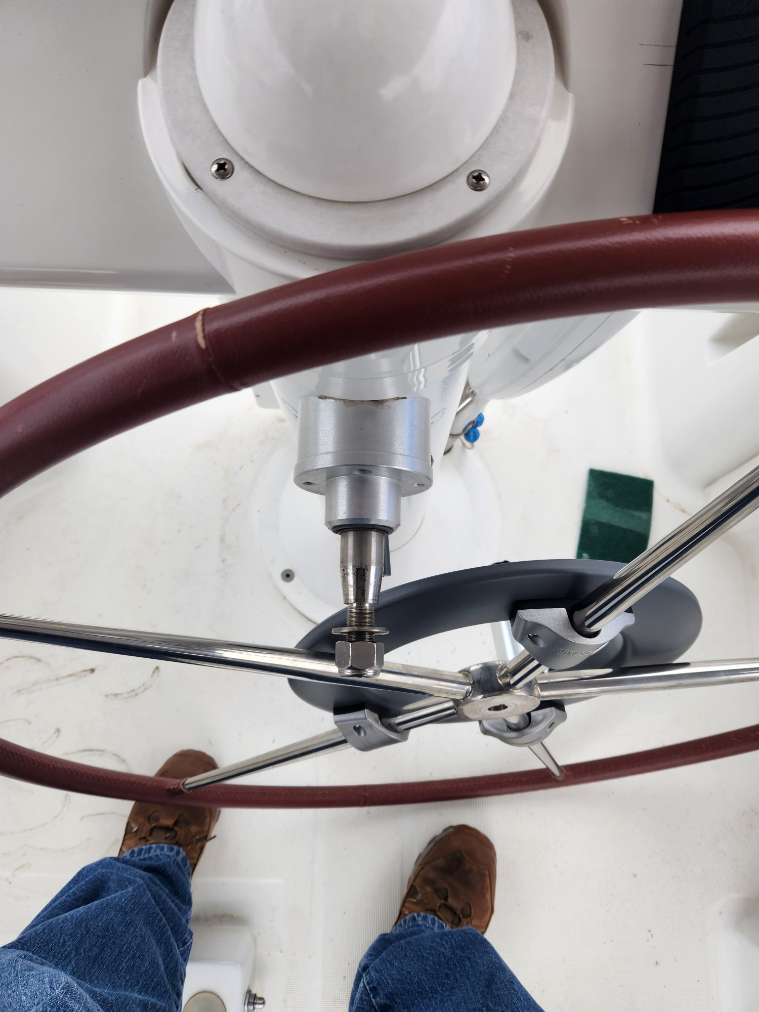

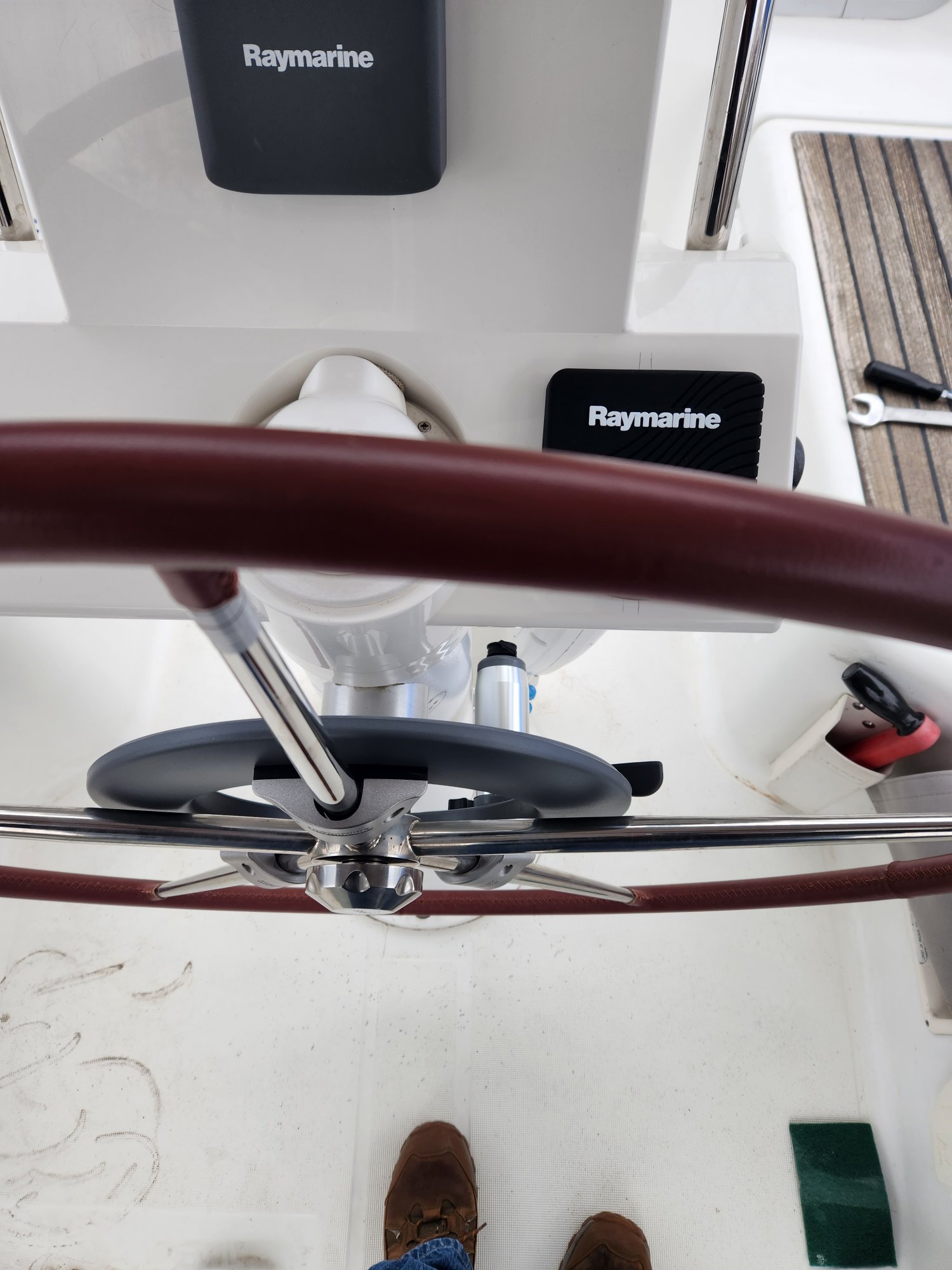

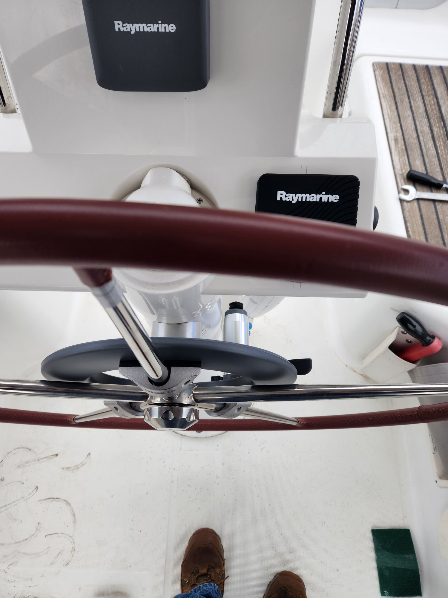

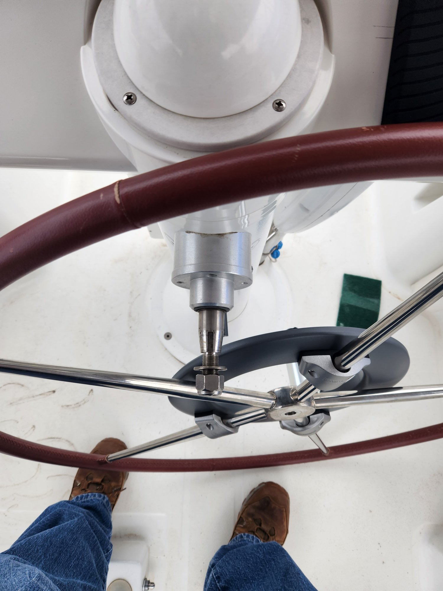

Jul 23, 2009
919
I finally got the wheel drive motor installed. As you can see in the photos, I had to mount the pin slightly off center. If the motor touches the pedestal it makes 20230122_153950.jpg20230122_153503.jpgnoise every time the wheel motor runs, ask me how I know.
