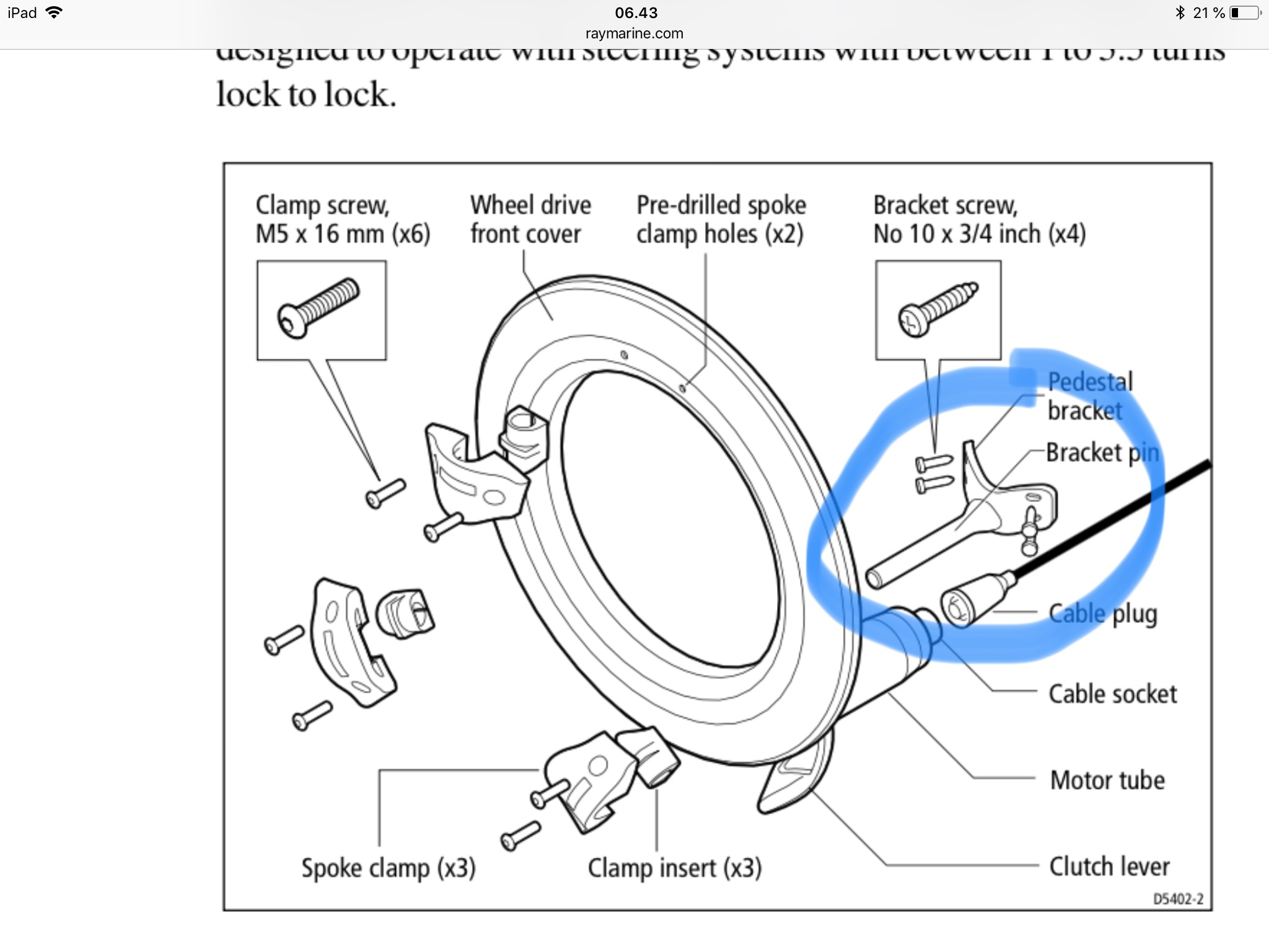

Thanks, did you use a speciel bracket on the wheel.? I Can see that somone use a speciel bracket to keep the wheel in place and the pivoting still working

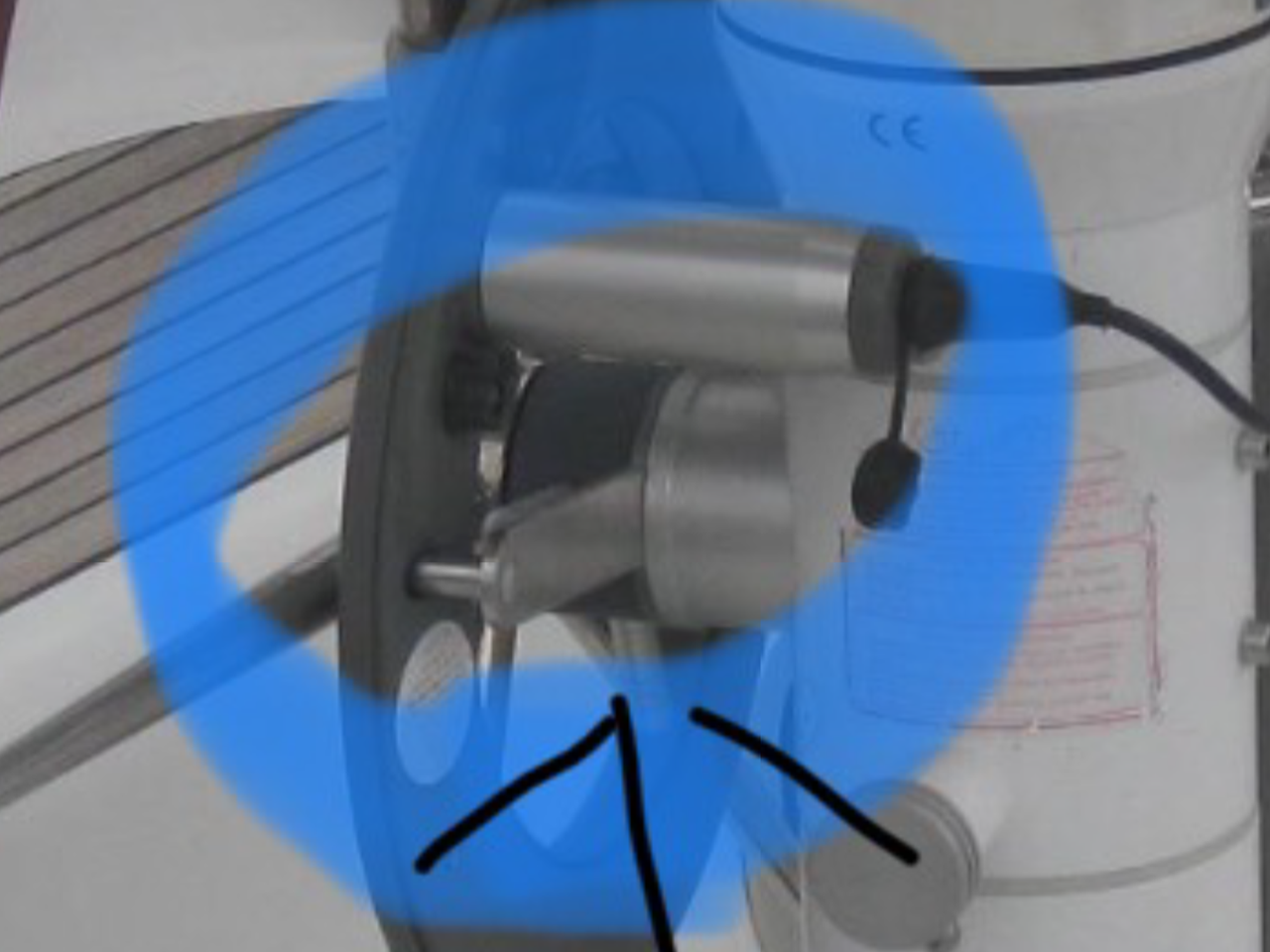

We have one on are 343 and the bracket that you mentioned will not let are wheel pivot.
Apr 23, 2018
10
Beneteau 323 Hørby
Is this the special bracket that you have on the boat.?
I Think this is the missing peace that i need...
24,616
@Sundowner that looks good. It looks like an after market or individual designed item. It surely would work. Especially with your rotating helm.
Likes: Sundowner

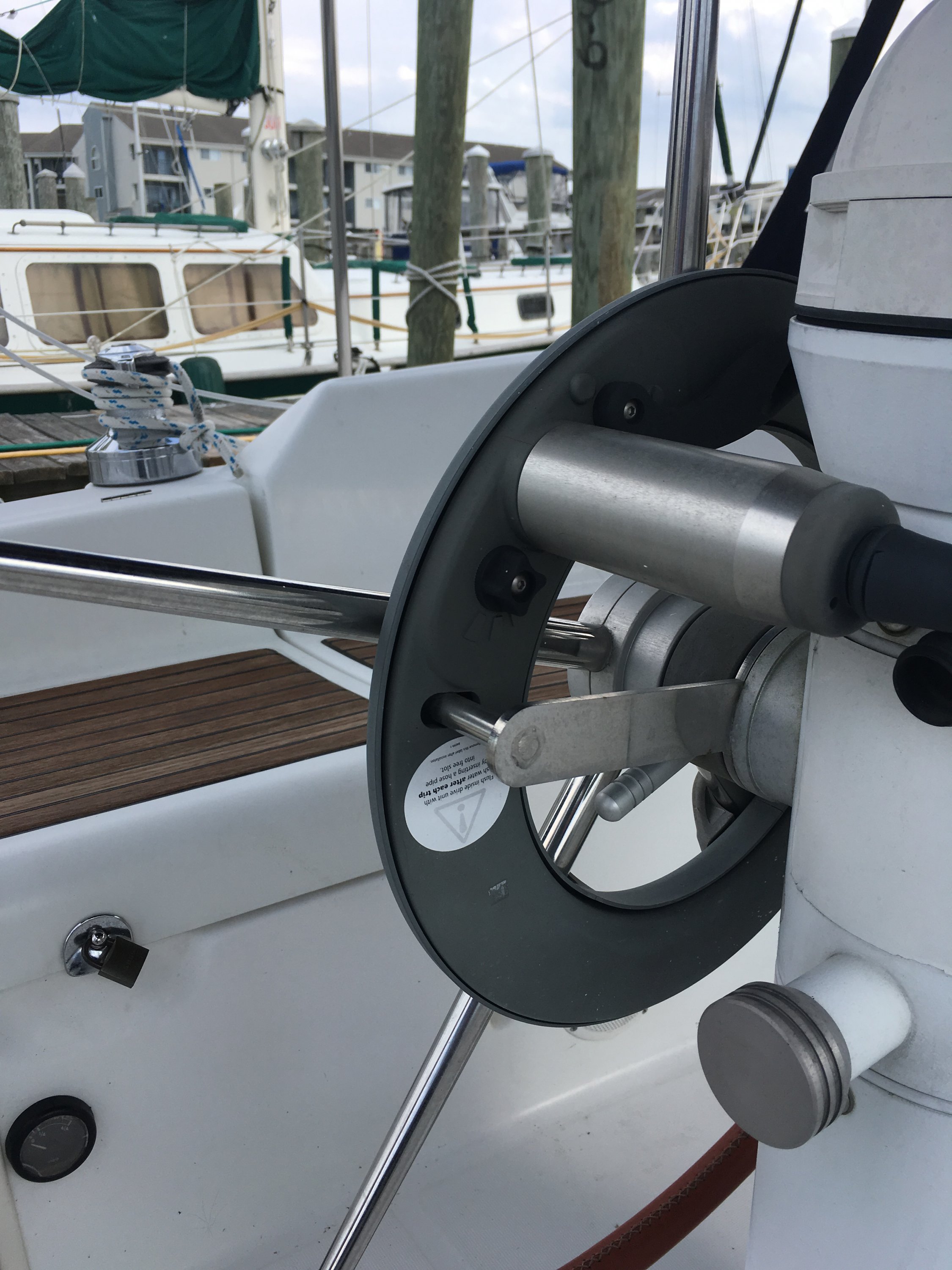

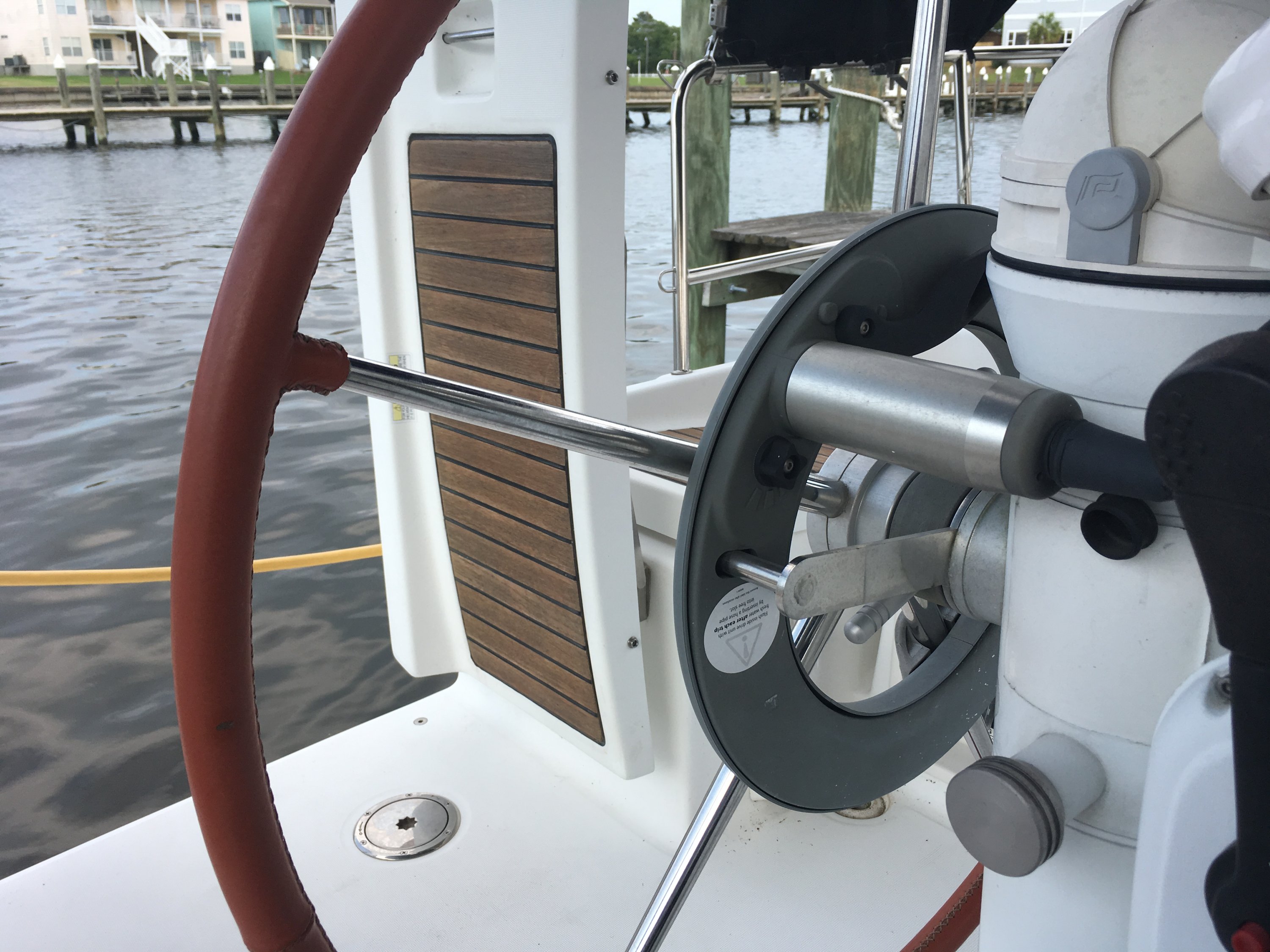

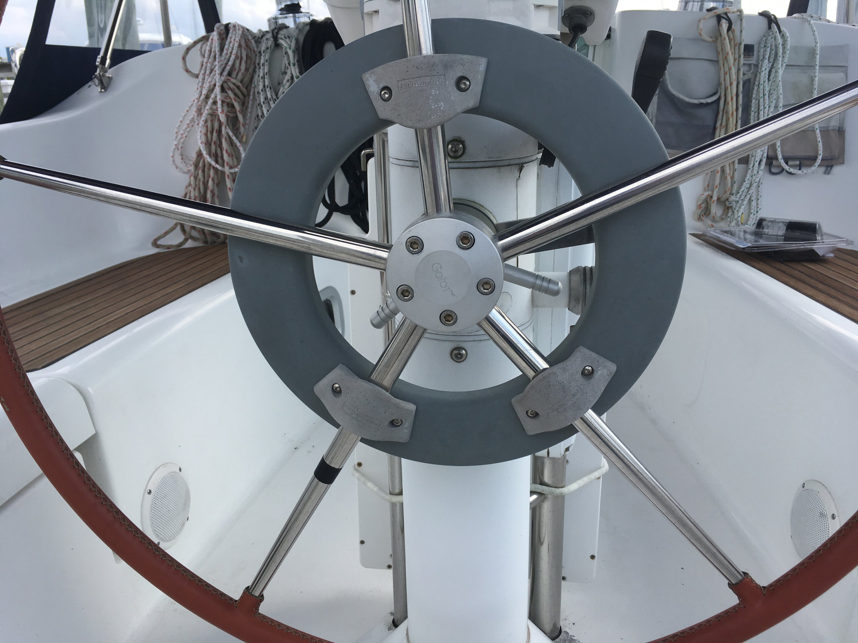

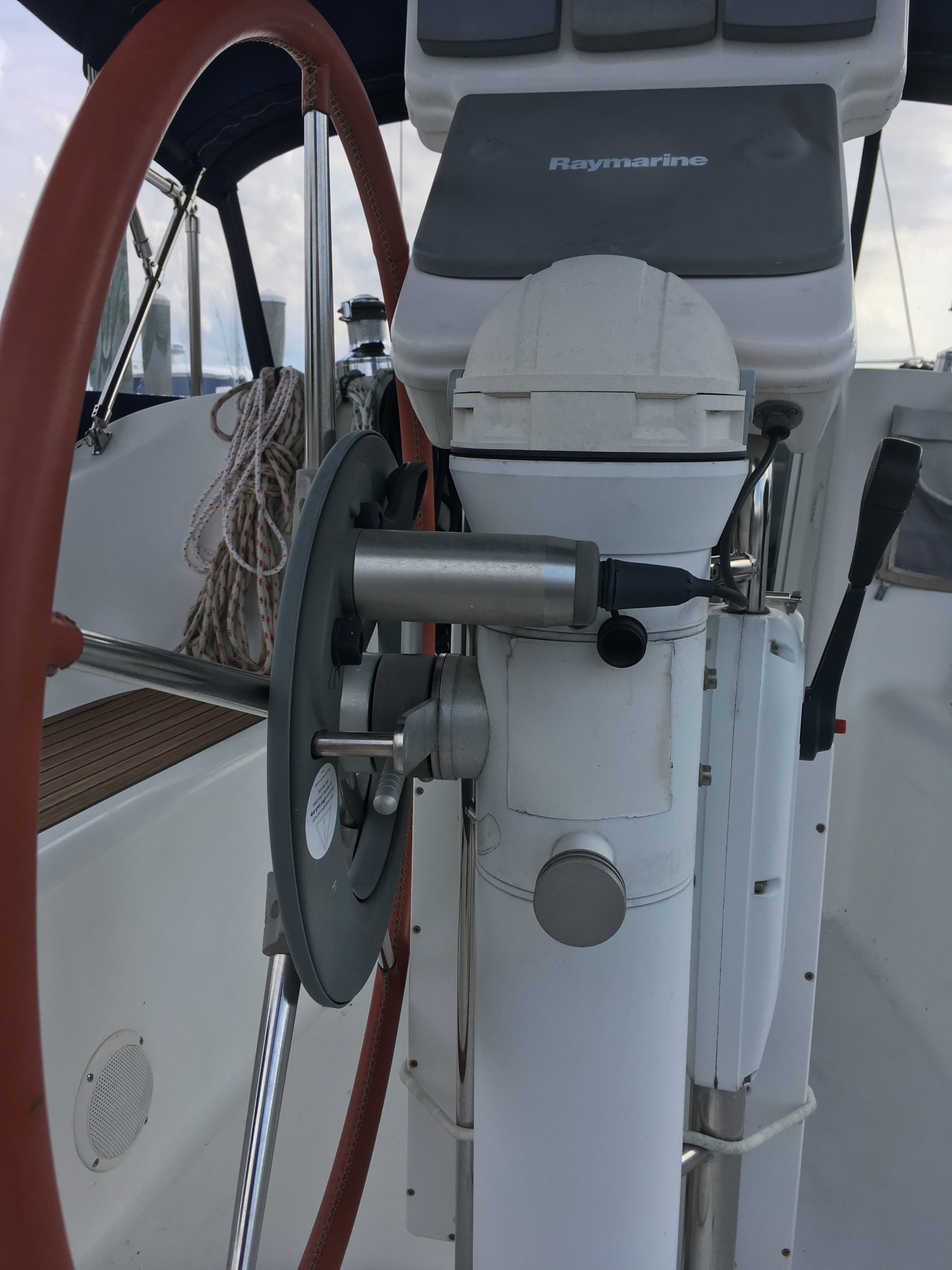

Jun 21, 2004
3,147
Beneteau 343 Slidell, LA
Rasmus,
OK, here are the photos from my 343 that has the ST4000 wheel pilot. The first two pics show the wheel in the normal operating position; the last two pics show the wheel positioned to the side. As you can see my photos, there are no pedestal bracket and pin as shown in your diagram. I do have the "special bracket" that you mentioned in your photo. Might want to talk to Beneteau to determine if that was a custom part supplied by Beneteau or if Raymarine fabricated the bracket to fit the Beneteau rotating wheel. Hope this helps; looks like you are already on the right track, if the bracket that attaches to the steering shaft is compatible with the EV100 or SPX5.
Likes: Sundowner
