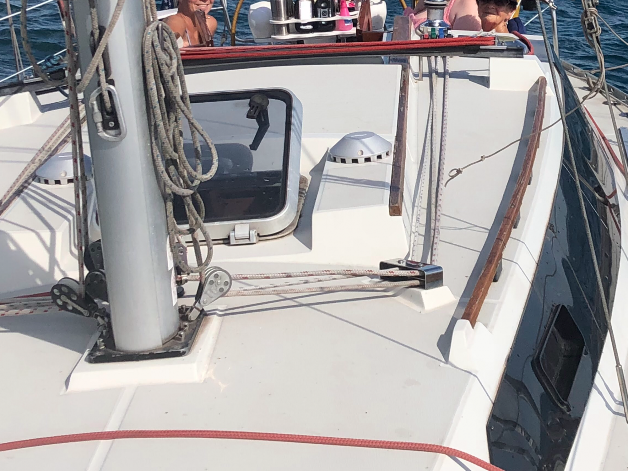

That is a really tight squeeze between the hand rail and the spray hood.
my deck organizer is a double stack, 4 line organizer, but it would not work in that tight space. Maybe you could us the 2 sheaves at one end…maybe.
I have a lot more deck space to work with…

@Tally Ho It looks like only two double stacked sheaves are used in this pic of a 25. I'm pretty sure the bottom of the handrail was cut to make it fit. I'm willing to do the same if needed. What about using a double cheek block instead since it's unlikely that more than two clutches will fit on either side of the companionway?

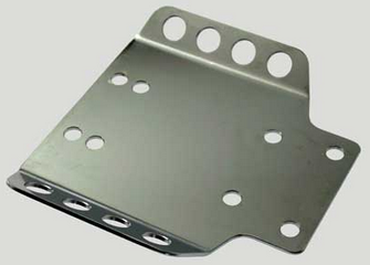

Here's a pic of the C25 mast plate that I have. It sticks out about 1/2" further than normal on either side

With the base plate, you can use almost any block with a shackle for a turning block. You don’t need anything that bolts down. If you look at the photo I posted, my turning blocks have an extra shackle with a pin to secure it to the “posts” at my mast base. I think you would just shackle your blocks through the holes in the mast plate.

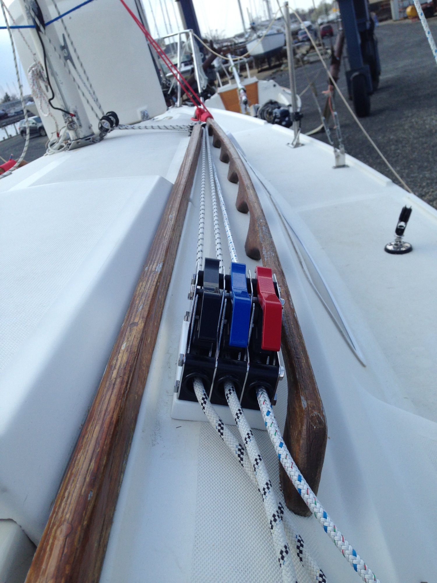

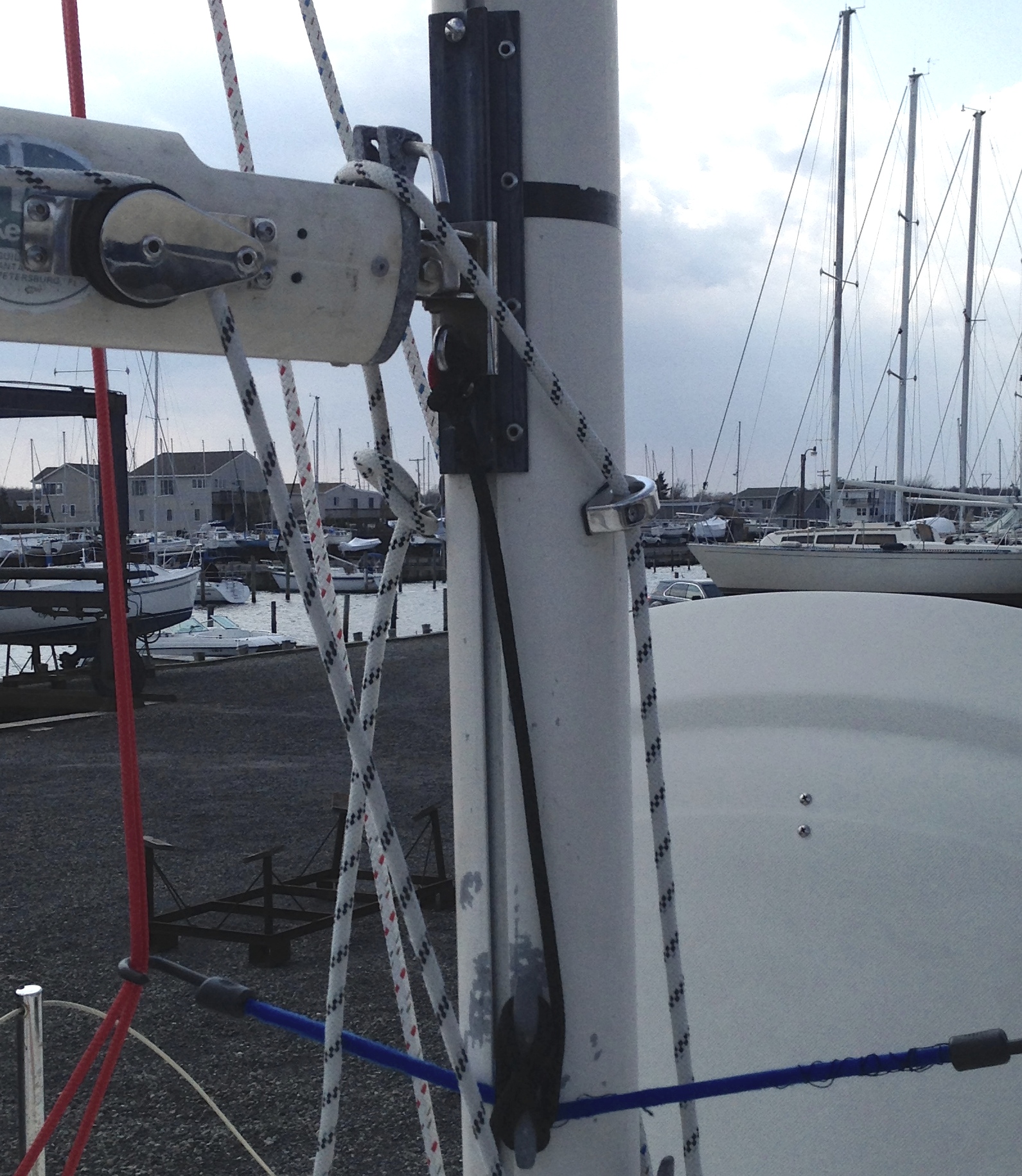

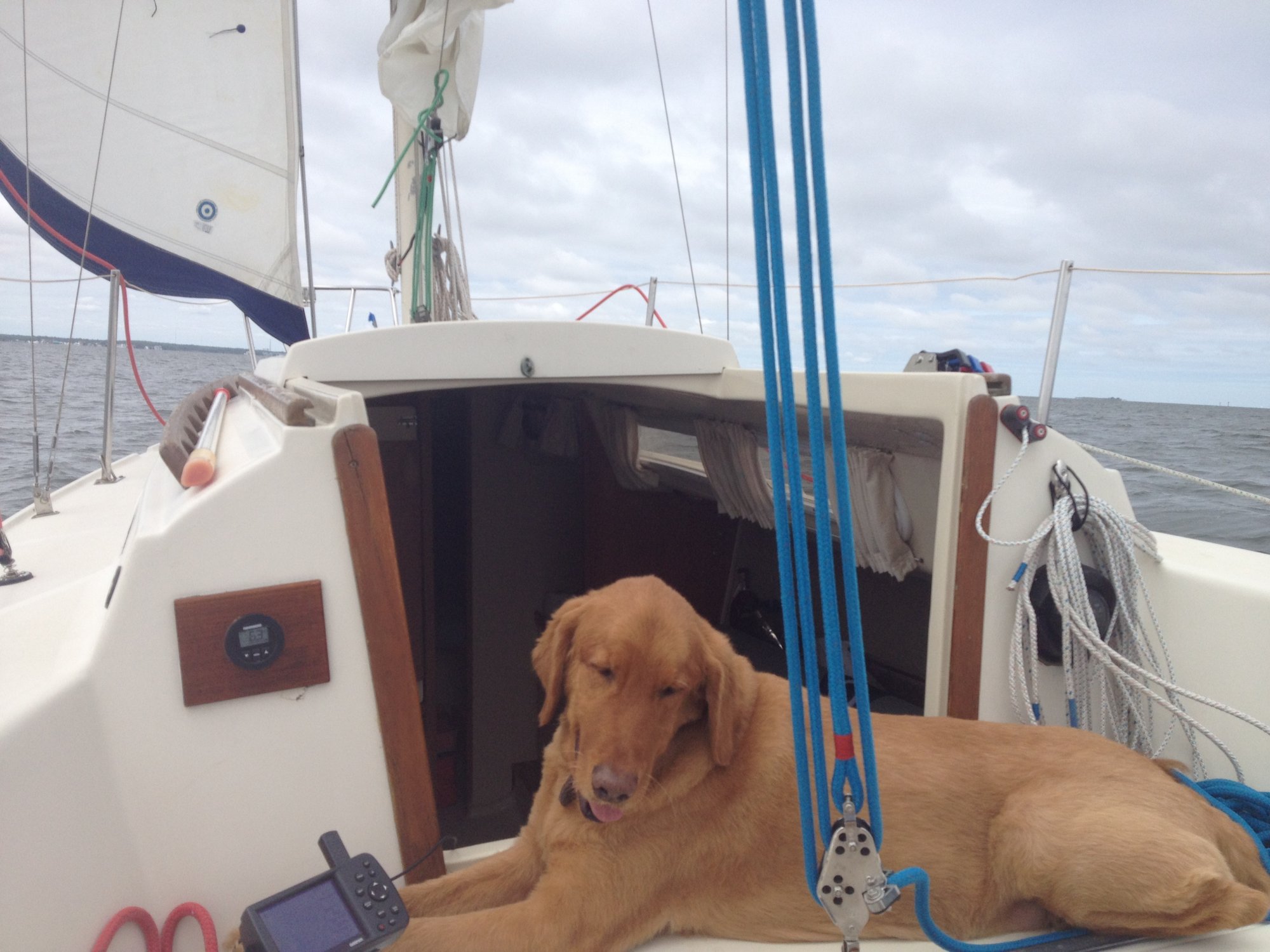

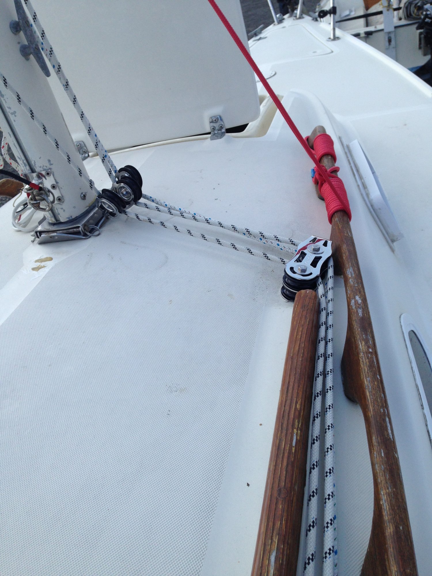

Here are some pics from when I ran lines back on my O'day 25. The in board lines rubbed a little on the teak but not enough for me to cut some for clearance.
I ran the halyard and two reef lines back. Note I put a base of 3/4" starboard under the rope clutch that I undercut with a sander so it fit the curved deck better. Later I installed a downhaul for the main and ran that back. I installed a Harken 150 cam cleat to hold that line. You can see that in the last photo.
I could easily raise the main without a winch but when I needed to tension it I did use the jib winch.

I'd prefer the base plate as it's less work, more versatile and the arrangement can easily be changed in the future. I wasn't sure if the angle of the line would have any significant impact. I assume your blocks flop around when there's no tension on the line? Have you notice any marks on your mast or deck from this?
Wow that is a tight fit!
Wow I'm impressed you managed to squeeze four lines on one side. Out of curiosity, what kind of sander would you recommend for that curve? I was considering running a block of plastic sideways against a table saw
