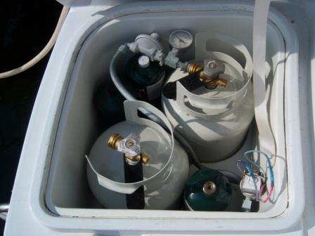

Those 1lb cannisters can be stored in the anchor locker which is properly vented. Regarding availability. If your boat already has a propane installation for the galley they sell an adapter to refill the 1lb cannisters from a propane bottle. Refilling them up on deck would not pose a significant hazard.
I store them along side the silly little 4.25 lb propane tanks the boat uses (see attached). Also, there's word that in addition to several more powerful outboard models, Lehr is also planning to release a reuseable 1 lb canister designed to be easily refilled. Technically, the existing camping gas ones are disposable and it's illegal to refill them. I'd do it of course, there's a reason I fly a pirate flag afterall. They say it's not that great an idea to do it more than once or twice though.
