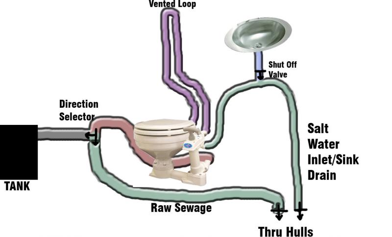

So, here's my head plumbing. (Sorry for the bad diagram)
I have the vented loop between the pump and the bowl, but I do not have a vented loop for the bowl exit as shown in the previous post.
My sink has a shutoff valve underneath I assume to allow flushing with seawater, but just dropping in the sink drain plug seems enough for the toilet pump to suck sea water in without having to close the valve.
My question is... to keep things simple without having to remember what cock needs to be open when final flushing or rinsing, and to not confuse my wife...
If I leave the inlet seacock open and fill the sink with fresh water, the head pump seems to suck it into the toilet. (I'm not going to taste it to be sure!)
Would you think that would be enough to flush the lines with "fresh" water?
That way I can leave the inlet seacock open for sink use draining all the time.
That shutoff valve is most likely there to prevent the pressure of water against the hull--and the open seacock--from turning your sink into a fountain when you're on a tack to that side. Keeping the plug in the sink accomplishes the same thing. It shouldn't have any effect on whether the toilet can pull in sea water.
My question is... If I leave the inlet seacock open and fill the sink with fresh water, the head pump seems to suck it into the toilet. (I'm not going to taste it to be sure!)
If you leave the seacock open when filling the sink with fresh water, the toilet will pull in a mix of sea and fresh water. Close the seacock.
I don't think you've grasped yet that it's not necessary to rinse out the lines after every flush...and as a result you're waaaay over-producing this.
You CAN leave the sink drain seacock open all the time that you're aboard, because you'll only need to use fresh water from the sink to rinse out the system last thing before leaving the boat, AFTER you've closed all the seacocks in preparation for leaving (surely you don't leave them open while no one is aboard???). That's most likely the ONLY times that you'll need to fill the sink with fresh water and flush that through the toilet...to rinse all the sea water out of the entire system so it won't stagnate and STINK while sitting trapped in the lines in the summer heat.
When you come back aboard, open all your seacocks and use the sink and toilet "normally."
